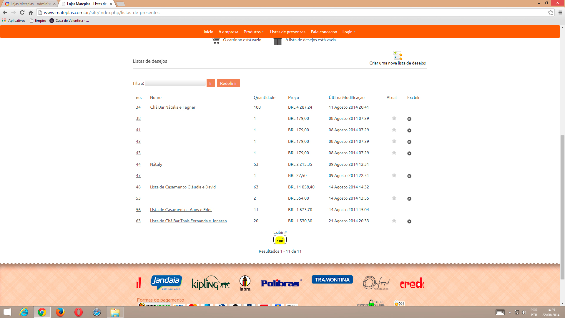

11 years 9 months ago #168564
It works!
However, a bug appears. It shows lists with one item that has not been registered or have been deleted.
Can you help me with this?
Last edit: 11 years 9 months ago by sergiobertini.
11 years 9 months ago #168758
And when you click to view the list, isn't there a message displayed on the product saying that it's no more in stock or something like that ?
To not display wish lists when products are no more sold is a bit more complex.
It will require more PHP code to manage these thing.
  • Posts: 128
11 years 9 months ago #168837
Do not!
This has never happened before!
Started happening from the update to version 2.3.2.
Please pass me the way and the code for correction.
11 years 9 months ago #168841
Is this issue present on the first website too ?
The missing message can potentially come from a wrong view.
  • Posts: 128
11 years 9 months ago #169047
Yes yes, this problem happened from the update to version 2.3.2
