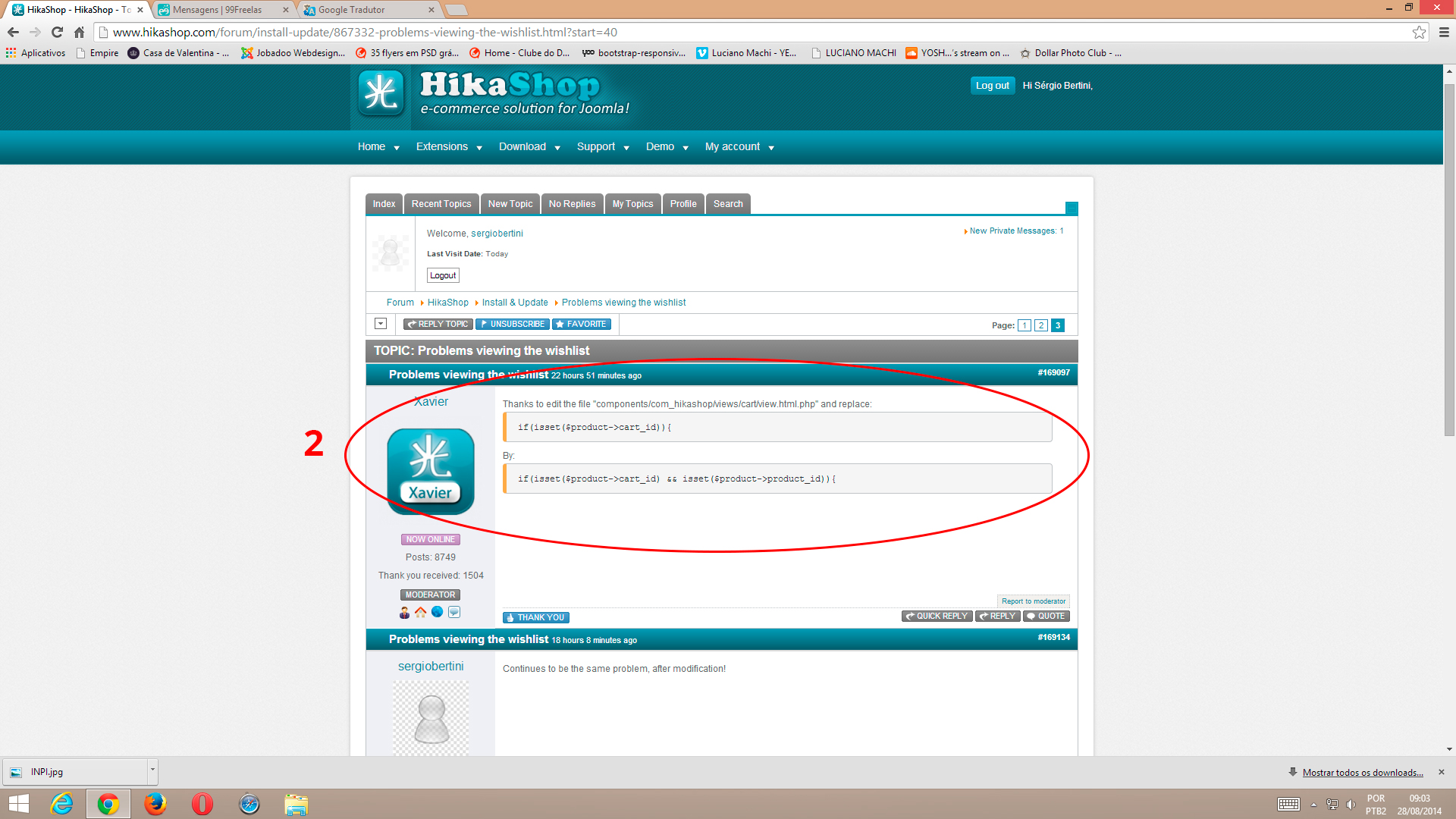

Thanks to edit the file "components/com_hikashop/views/cart/view.html.php" and replace:
if(isset($product->cart_id)){
By:
if(isset($product->cart_id) && isset($product->product_id)){

Continues to be the same problem, after modification!

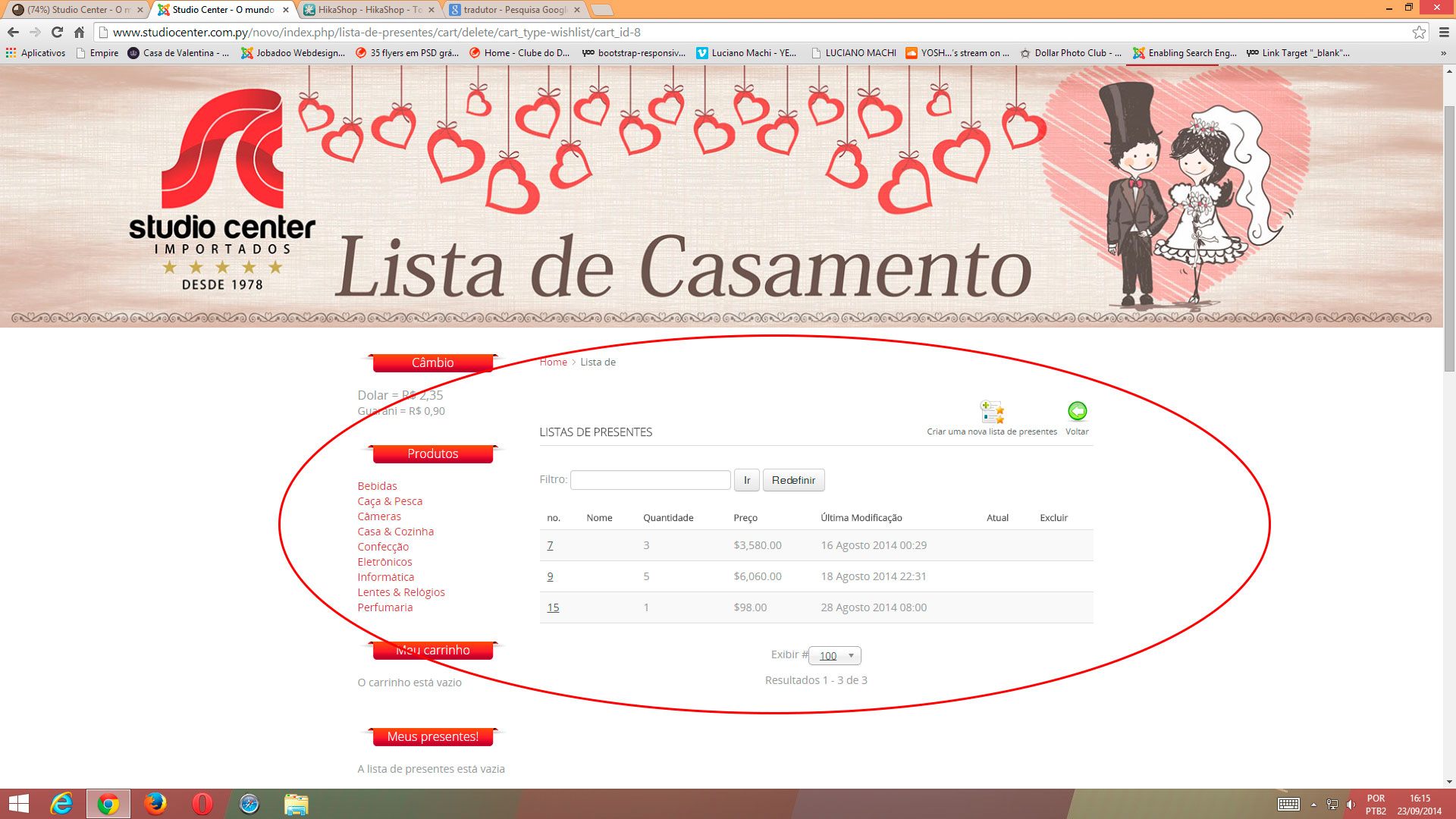

I'm still having a problem Wishlist!

Are lists that have been deleted are displayed!
You informed me that would solve the problem until last week. Can you help me !?

I upgrade the version of hikashop to 2.3.3.
However , the error continues to Wishlist !
Can you help me solve ?
On the site www.studiocenter.com.py/novo/ you managed to solve , but the site www.mateplas.com.br/ I also want to solve !

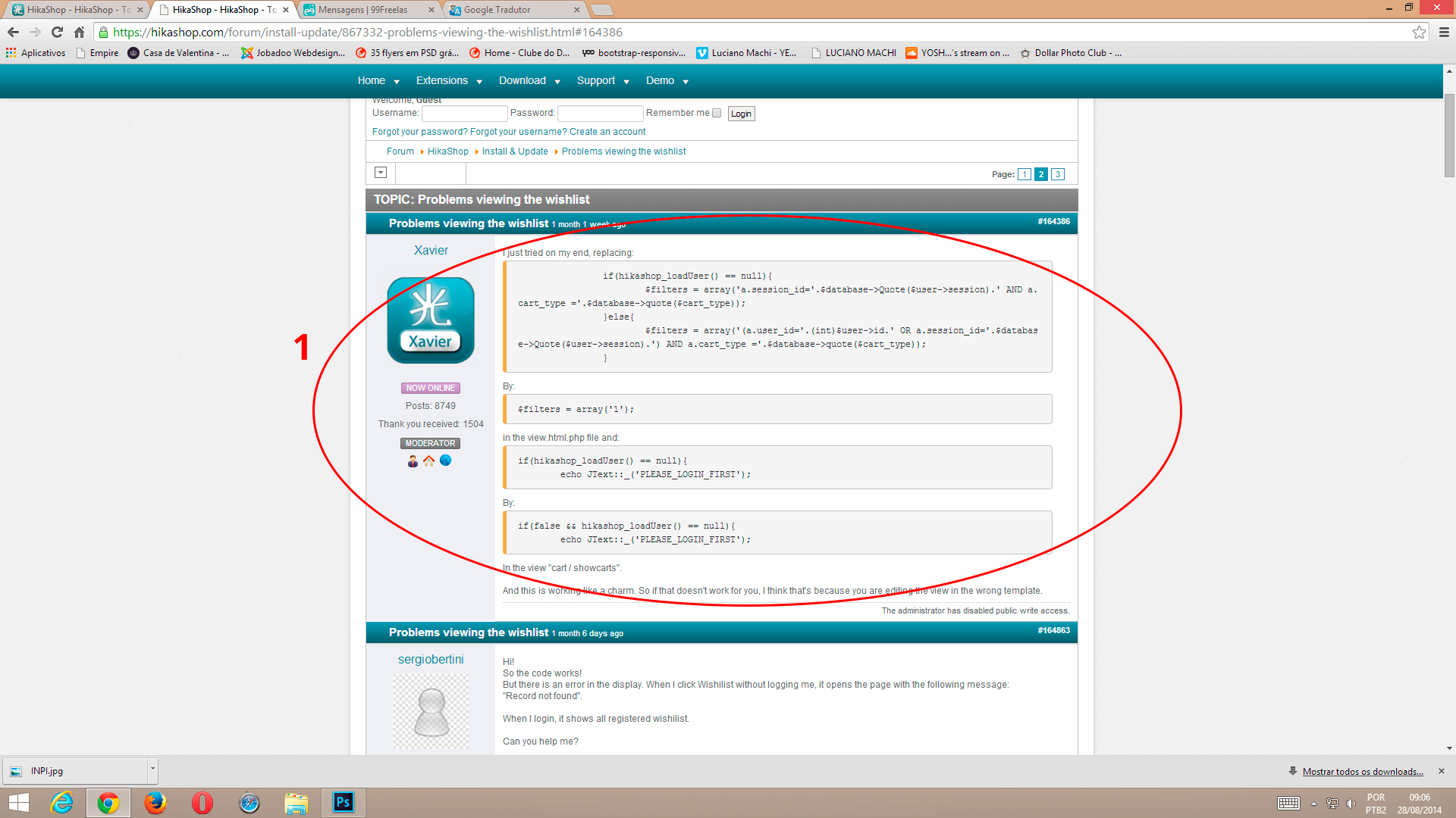

Hi!
I'm using the latest version, but the lower line codes do not exist in this version. So I can not replace.
And Wishlist corrtamente still does not work!
Please help me!
if(hikashop_loadUser() == null){
echo JText::_('PLEASE_LOGIN_FIRST');
By:
if(false && hikashop_loadUser() == null){
In the view "cart / showcarts".
