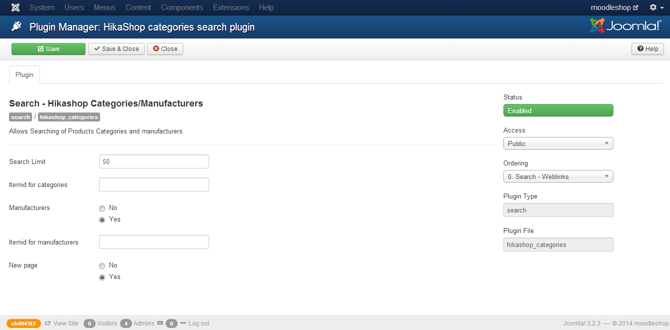

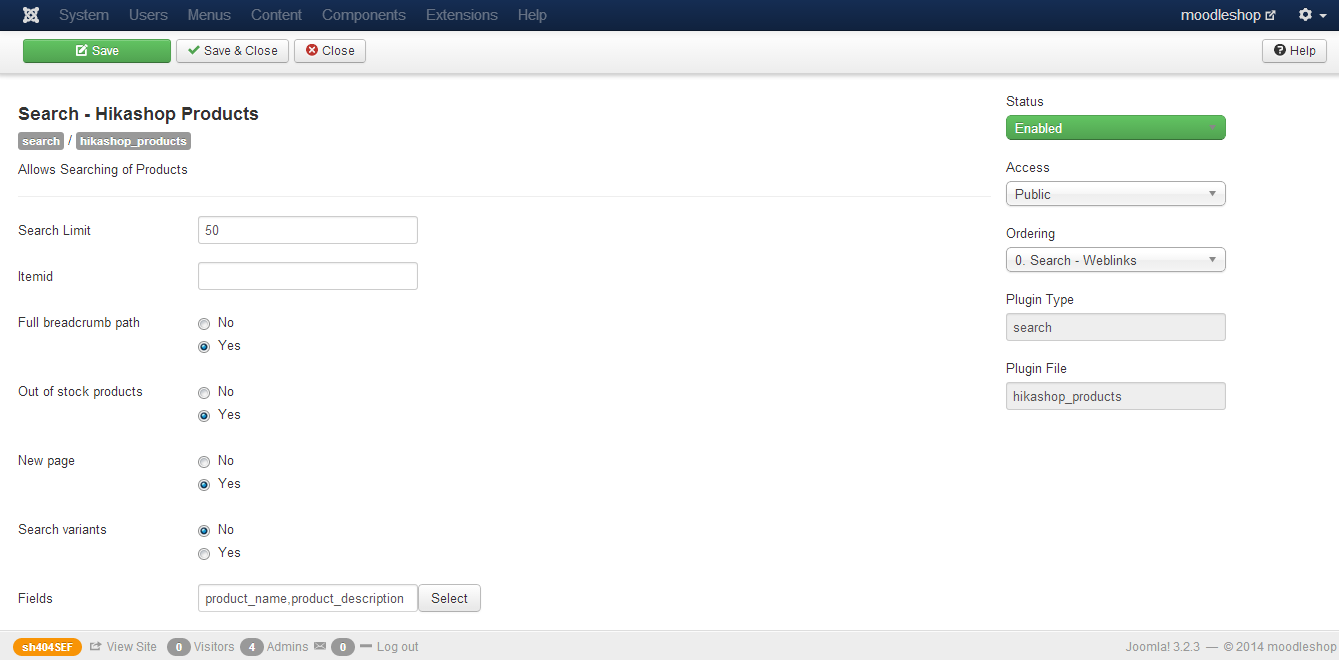

Is that working fine ? If not, thanks to give us the screenshots of the plugin "hikashop search product" and "hikashop search category".
  • Posts: 95
11 years 11 months ago #155825
I have tried also with Joomla search module and i got the same results. The search works fine in greek language , but in english which is the translated language with Falang it can't find the product -translated- name. I attached the screenshots of the plugins you have requested.

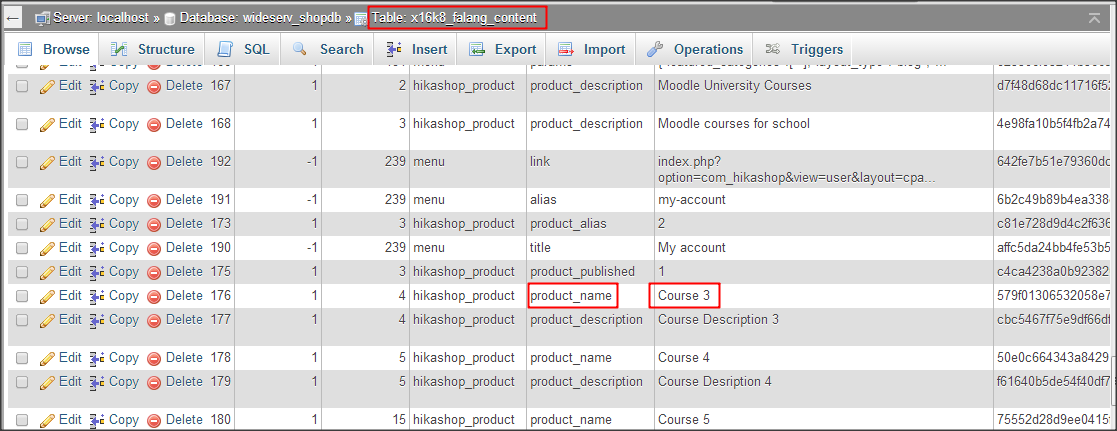

That should work, in the plugin "search / hikashop_products" there is a specific part for FaLang to search in every languages.
Thanks to check in the table "falang_content" if there is all the corresponding names, etc.
  • Posts: 95
11 years 11 months ago #156014
I couldn't find this part for searching in every languages with Falang. I checked the database ->falang_content and I 've found the english names of the products but they are not searchable in the eshop. I attached a screenshot from the database.
