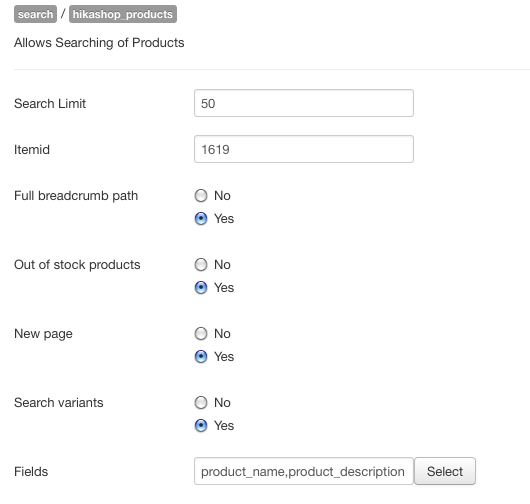

Thank you for your reply. I checked the plugin and both "product_name" and "product_description" are in the fields for searching? Any other thoughts on what is causing the issue? here is a screenshot of the settings for the plugin.

I just tried again, and it seems that the search is working fine now.
