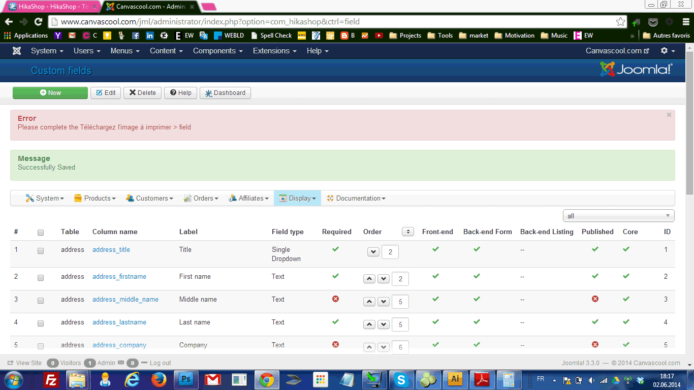

Error2:
When save the Custom field with image ajax I get the folliwing error:
"Error
Please complete the Téléchargez l'image à imprimer > field"

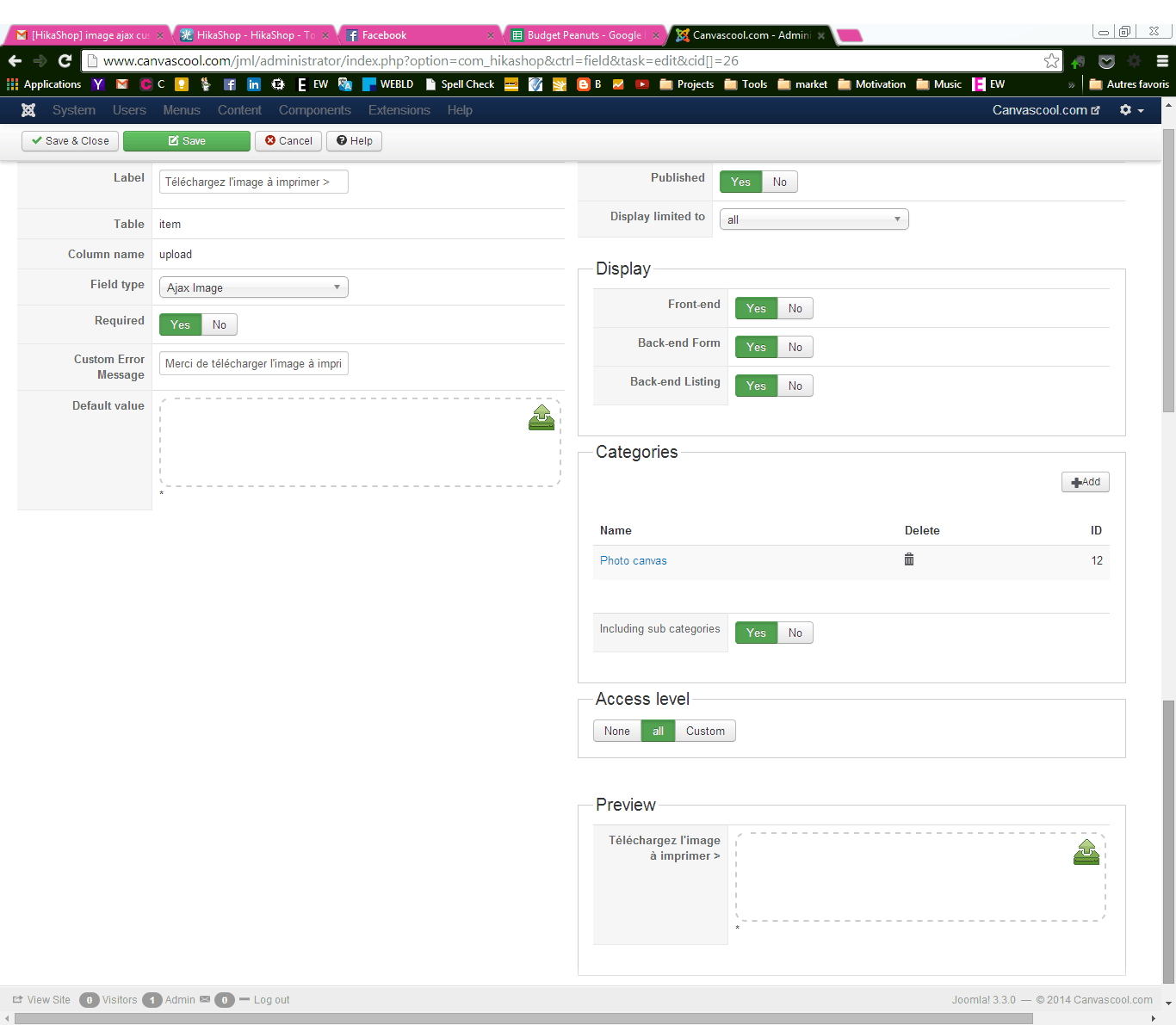

12 years 3 months ago #158288
The "ajax image" can't manage a default value for the moment.
The way that the system works, it passes a file name with a security value (to be sure that you have the right to use the file name, that you don't try to trick the system). And this data is not manage in the backend for the custom field.
With the default value, the security field might not be right initialized.
I have to perform some tests to reproduce your configuration.

Would it be possible to have the screenshot of the configuration of this custom field ?
Please read my previous message about default data... It is quite important to read and understand that.
  • Posts: 71
12 years 3 months ago #158460
please find here joined screen shot of custom field configuration
Last edit: 12 years 3 months ago by epware. Reason: forgot to add a file
12 years 3 months ago #158575
The message you have in the backend is not a real problem.
Because the field is required and HikaShop try to store the default value when you save the field, the message is displayed.
But it does not affect the rest of the save for the custom field.
So if you want to save as the default value an empty value, you have to remove the "required", save the custom field (with an empty value) and then re-put the default value.
We will see to remove this message in a future release and improve the save of a empty default value even if the field have the "required" set.

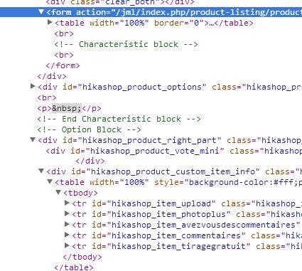

12 years 3 months ago #159038
Regarding your web page, the HTML content is broken.
The result is that the inputs are no more in the "form".
Because the Ajax system add dynamically the input fields in the HTML Dom, the elements are not seen in the form, so the data is not sent.
