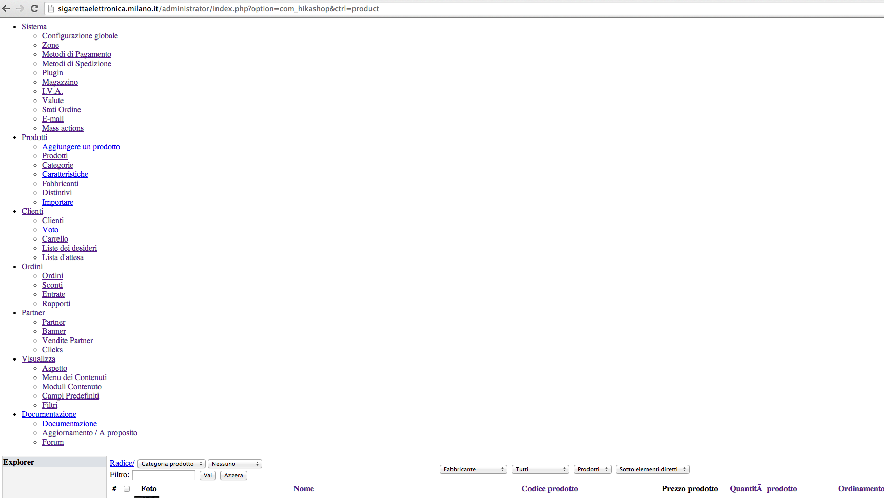

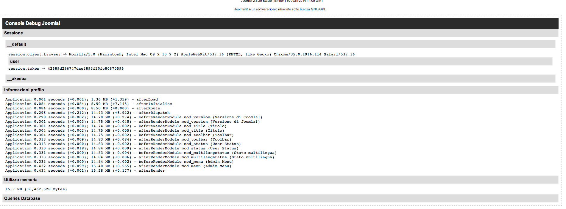

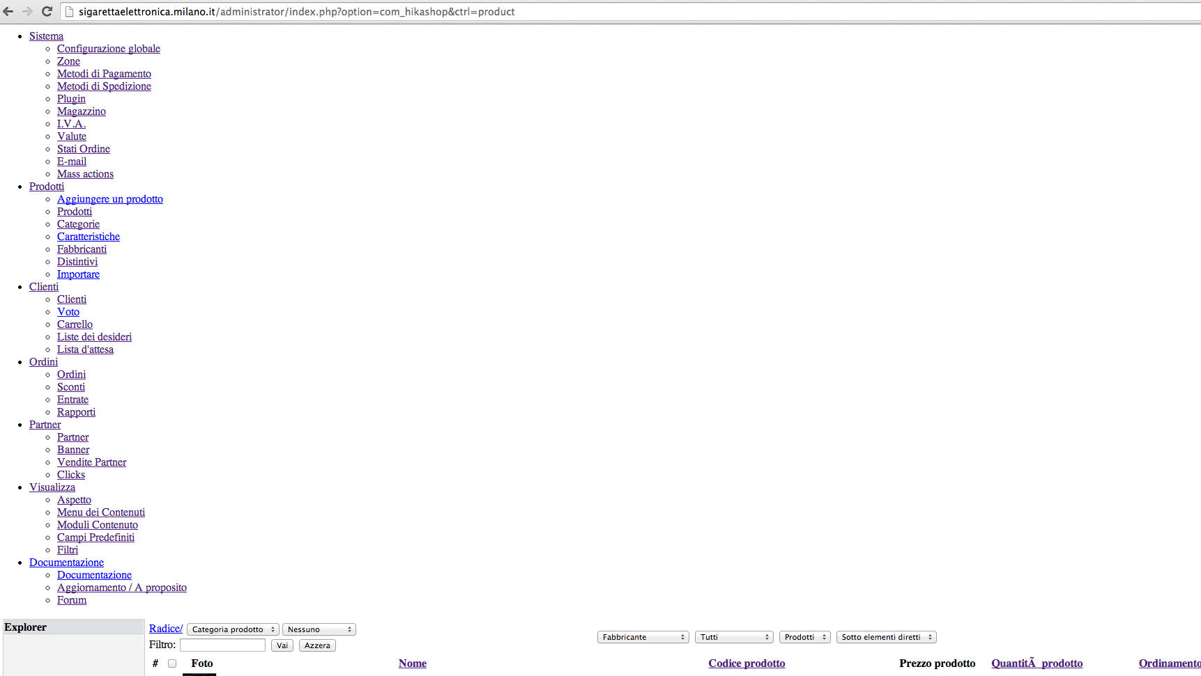

hello, I no longer advertise or manage the products from the Control Panel page is displayed abnormally as in the photo that I enclose

This indicates a fatal error on that page.

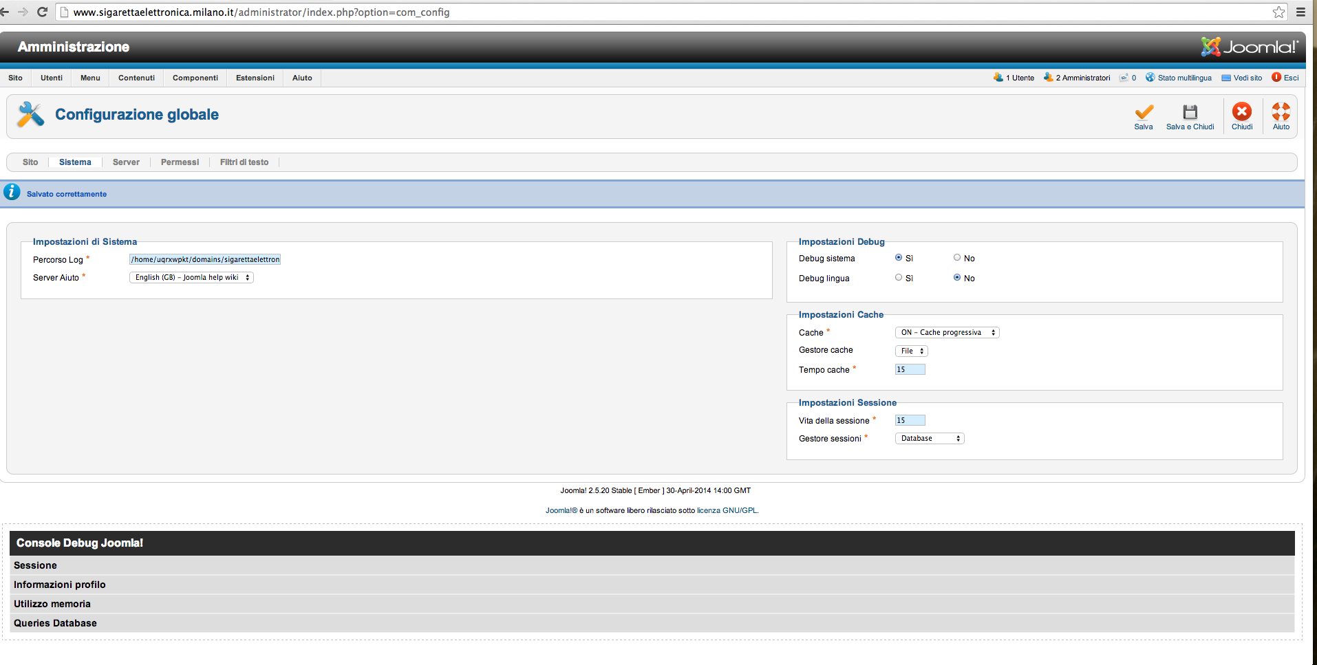

Go in your Joomla configuration page and turn on debug mode option and set the error reporting option to maximum. Then try again and it should display an error message at the bottom explaining what's going wrong.
  • Posts: 17
12 years 2 months ago #159553

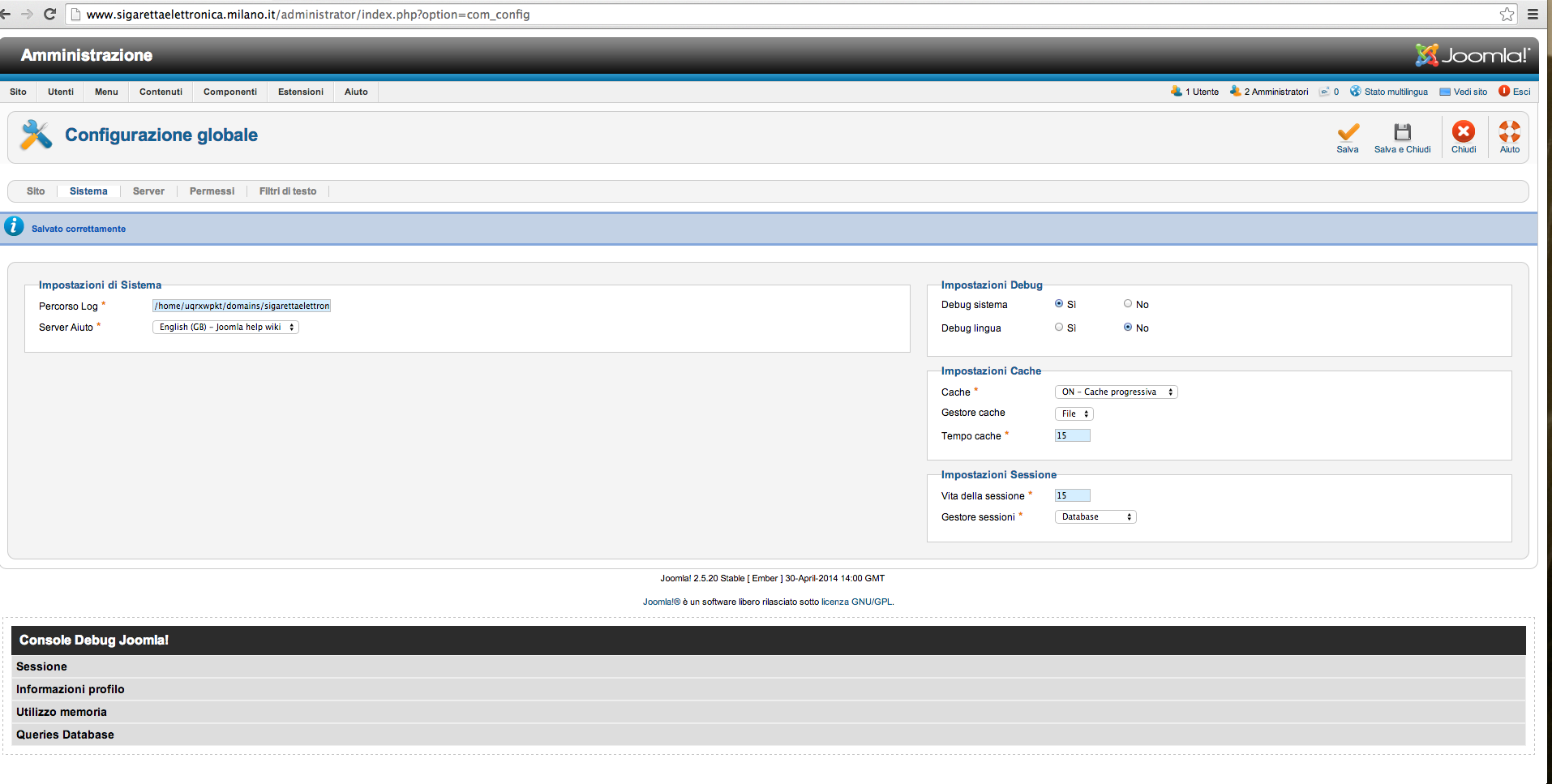

Thank you for your response.
I did what you suggested me but does not display any error
