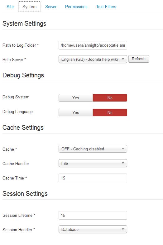

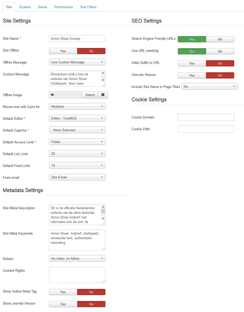

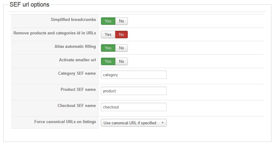

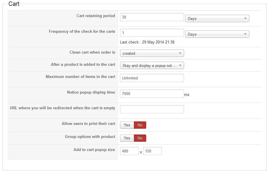

Attached our configuration of Joomla and Hikashop

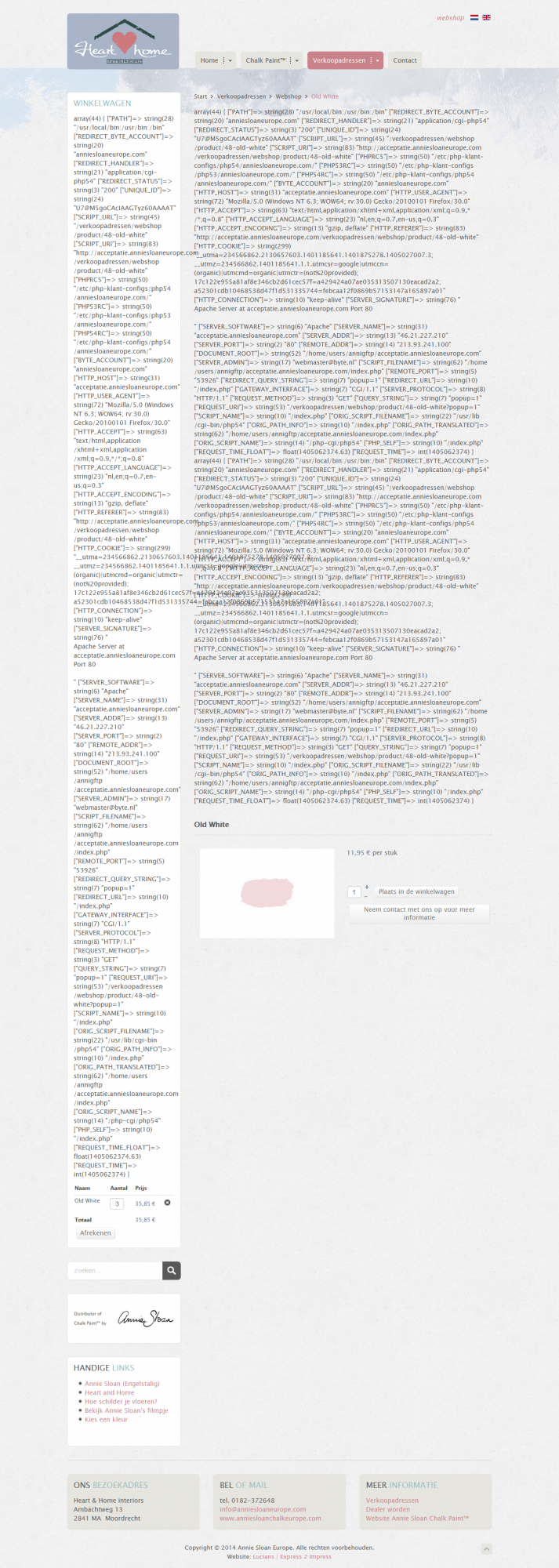

  • Posts: 627
  • Thank you received: 25
11 years 11 months ago #163773
Here the dump of the $_SERVER variable from inside that hikashop_currentURL function on the page with the ?popup=1 page.
