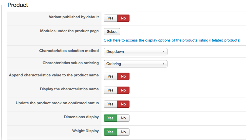

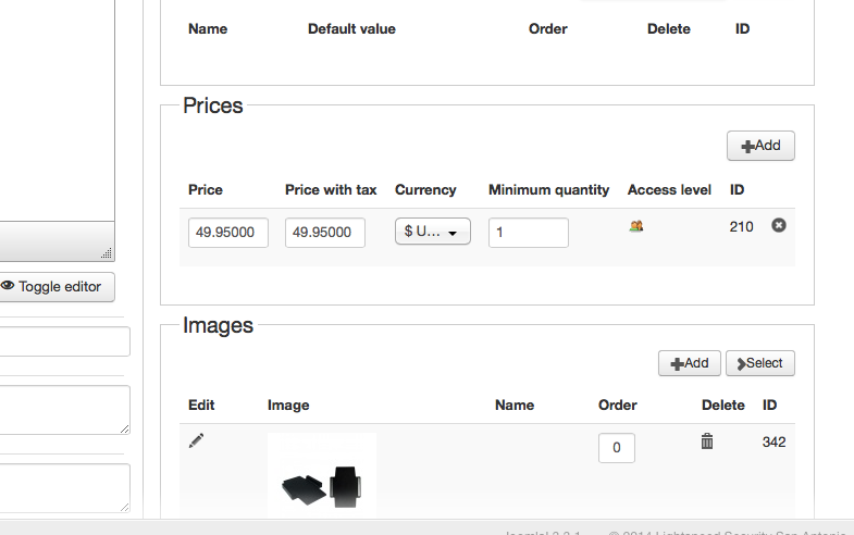

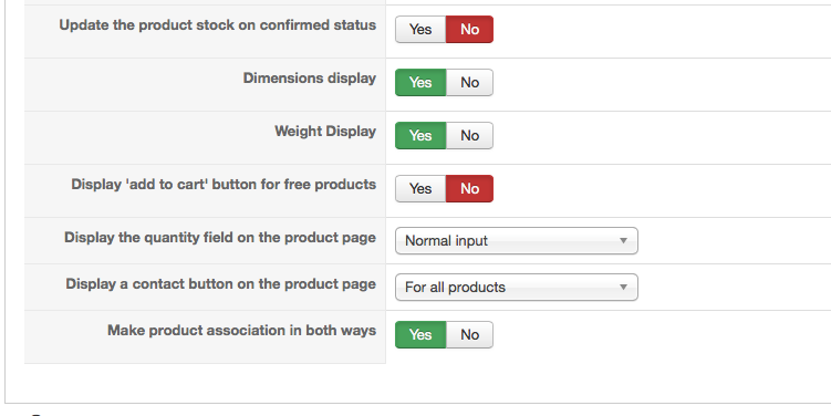

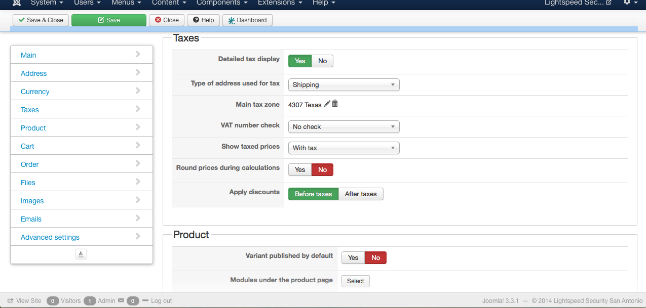

  • Posts: 26
11 years 11 months ago #162141
Hello Nicolas
I am attaching the screen shots for your review.
Thank you
11 years 11 months ago #163285
You can find the tax listing through the menu System > Taxes, if your don't have anything, so you have to create your tax rules here.
