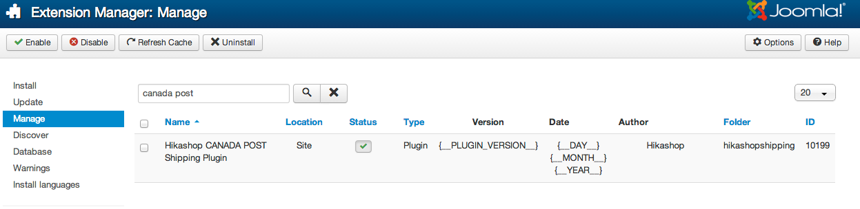

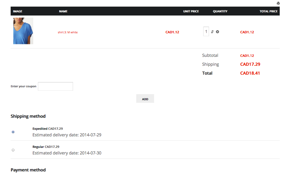

Canada Post Shipping plugin not displaying all options, only two. There may be a plugin version problem as I saw in another post, however I can't tell you what version I have. see attached. I'm concerned that I won't be able to upgrade.

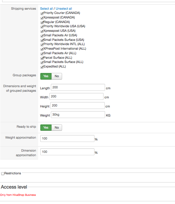

1. Can you download the last Hikashop version through our website, install it, and test it again ?
2. Can you show me some screenshots of how did you configured your canada post shipping method ?
Thanks.

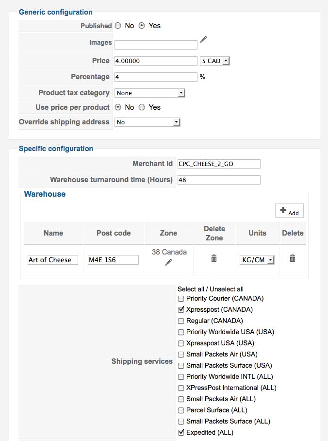

  • Posts: 21
11 years 10 months ago #165325

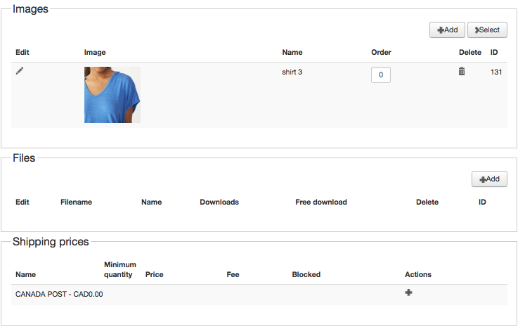

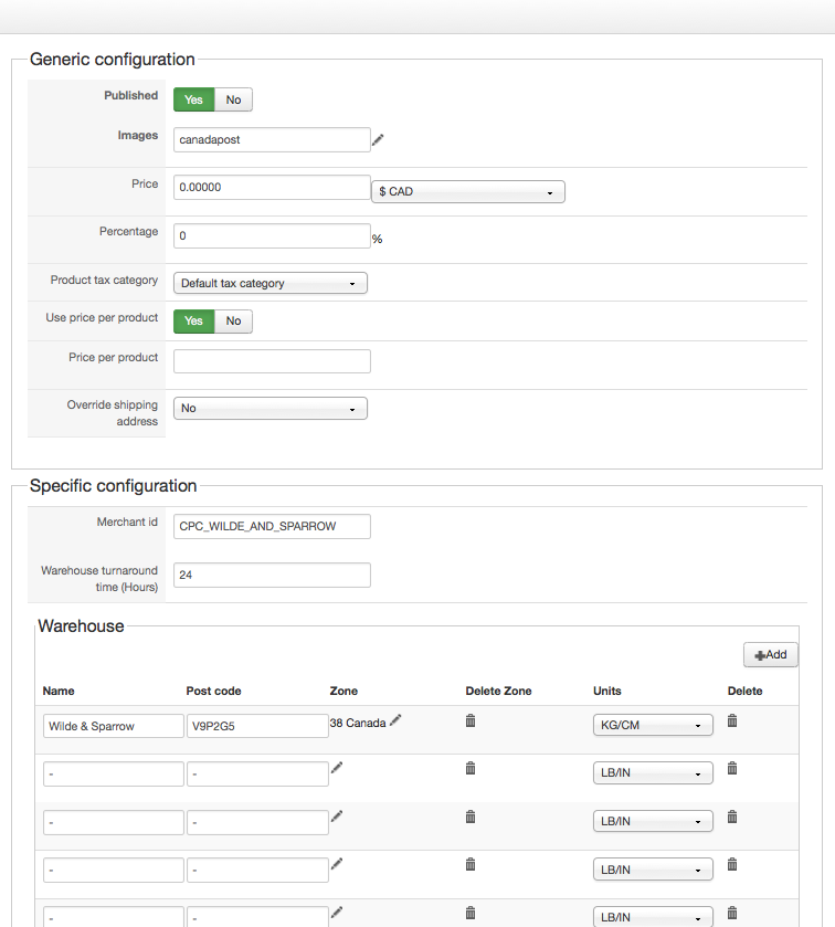

Hi, Thanks for your response.
Installed latest Hikashop- same results
Please see attached files for the Canada Post. Also, I talked to Canada Post, they say they are not receiving the postal code.
11 years 10 months ago #165364
Can you remove the warehouses without any value, and also the values of the Weight ans dimenssion approximation and then try it again ?
If it's still not working, can you send me a temporary Access to your back-end through a private message ?
And also replace the Weight value of the "Dimensions and weight of grouped packages" option to 30
Thanks.

  • Posts: 21
11 years 10 months ago #165462
Hi Mohamed
I made those changes. I removed the empty warehouse fields, however a new one keeps reappearing each time i save. This did have some effect: now I only get one error message "Error while sending XML to CANADA POST. Error code: -3000. Message: Origin Postal Code is illegal." instead of eight, so the warehouses seem to be the issue there. Is there a way to stop another empty warehouse field appearing on save?
Also, I still only get the two options for shipping.
I'll send the login credentials privately.

  • Posts: 21
11 years 10 months ago #165801
Thank you Mohamed. The error message has now gone.
The shipping options still don't show, only one of the three that I selected in configuration shows in the front.
11 years 10 months ago #165874
I think that the issue is probably coming from your Canada Post account, so the solution will probably to directly contact Canada Post about that issue.

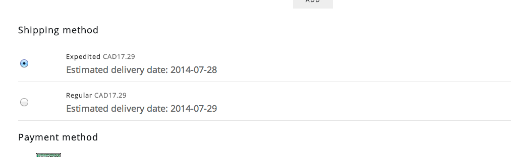

1) Today the testing is different! :)
imgur.com/rGtfUs8
is there anything else here that needs to be configured or changed to make it look / work better?

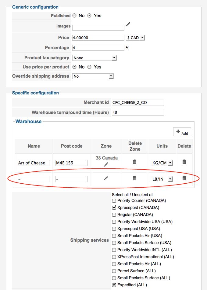

When I edit the Canada Post shipping plugin a new warehouse is created whenever I select "Save" or "Save & Close". With "Save", the new warehouse - with empty fields - appears immediately; with "Save & Close" the new warehouse appears when the plugin is opened again for editing. If the new one is not trashed each time, more and more new warehouses will appear. Since it now looks like that this not the cause of CP returning errors at checkout, it is simply a frustrating inconvenience and so far apparently not causing any other issues.
Note: I found this thread while searching for the new warehouse problem, which was first posted by geeksonthebeach in #165462.
Last edit: 11 years 7 months ago by av.opticom.
11 years 7 months ago #177001
Thanks for your feedback, I just reproduced your issue and I'll fix it.
