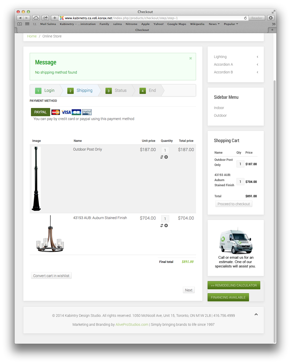

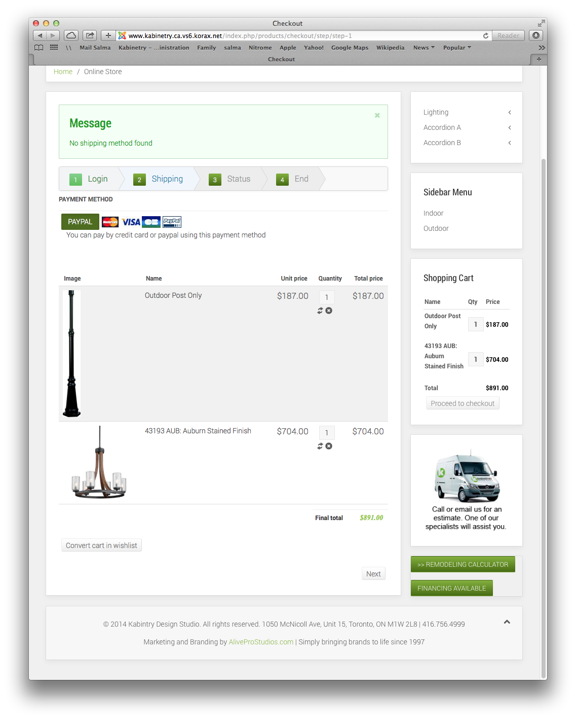

5. When I order the product I can not go beyond shipping, it keeps saying no shipping method found, but I already have a UPS shipping method entered there.

5. You have to specify weight on your products if you want that the UPS shipping plugin process the shipping price.
The plugin also require some information like a valid user shipping address (or a compatible country) and other different elements.
But without any more detail about your UPS plugin configuration, it will be difficult to tell you if you missed something or if you have a too restricted restriction.

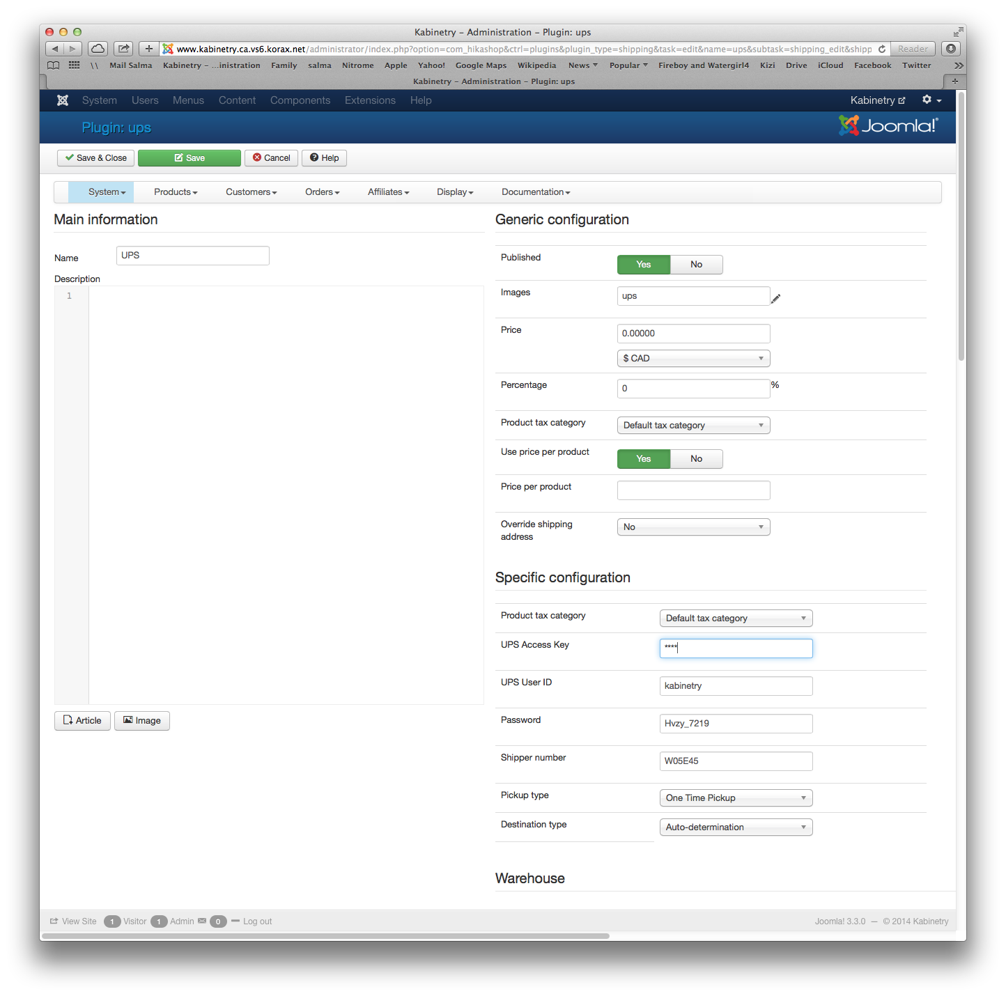

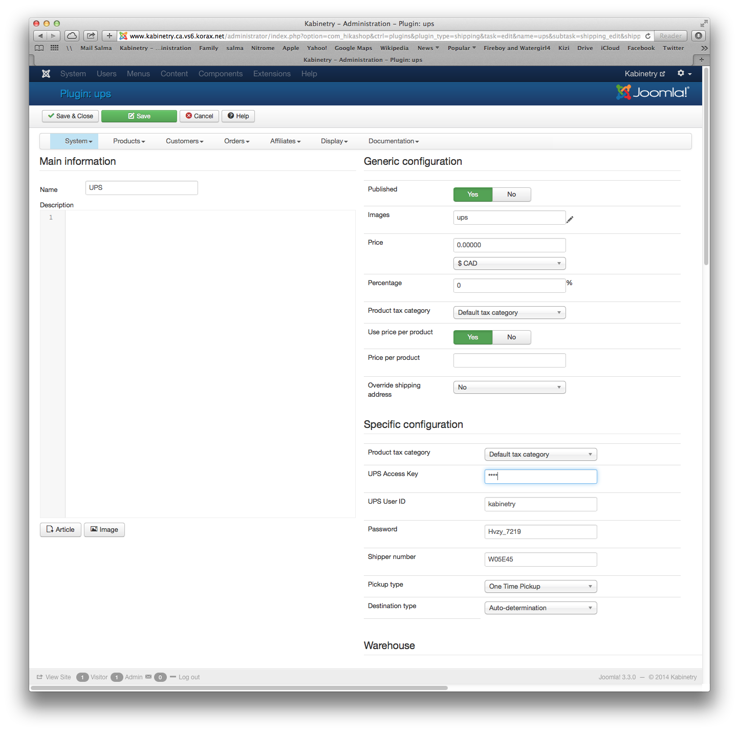

5. Like I said in my previous message, we will require more details about your UPS plugin configuration ; a screenshot of your configuration (you can remove/hide the credentials), also of a screenshot during your checkout in order to have more details about the content you used (product, address, etc).

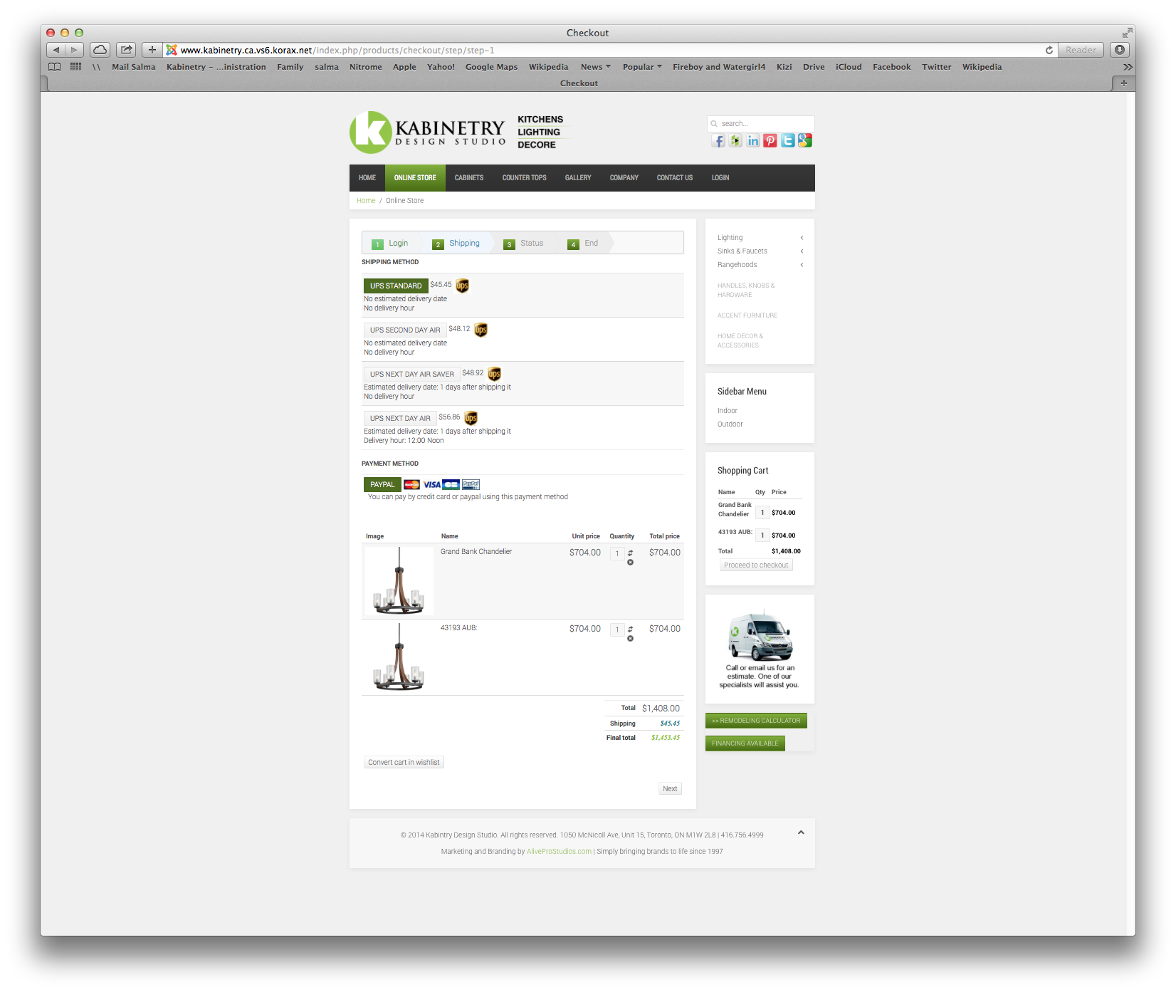

I have attached two screen shots for the front end of the site as well as backend.
Alternatively you can also go to
www.kabinetry.ca.vs6.korax.net click on
online store >> lighting >> indoor and pretend to buy a product.
You will see it just does not go to next step.

Thanks but some very important information are still missing.
We have to know the full configuration of your UPS plugin and we have to be sure that you have specified weights and sizes for all of your products, otherwise, the UPS plugin won't work, as I said before.

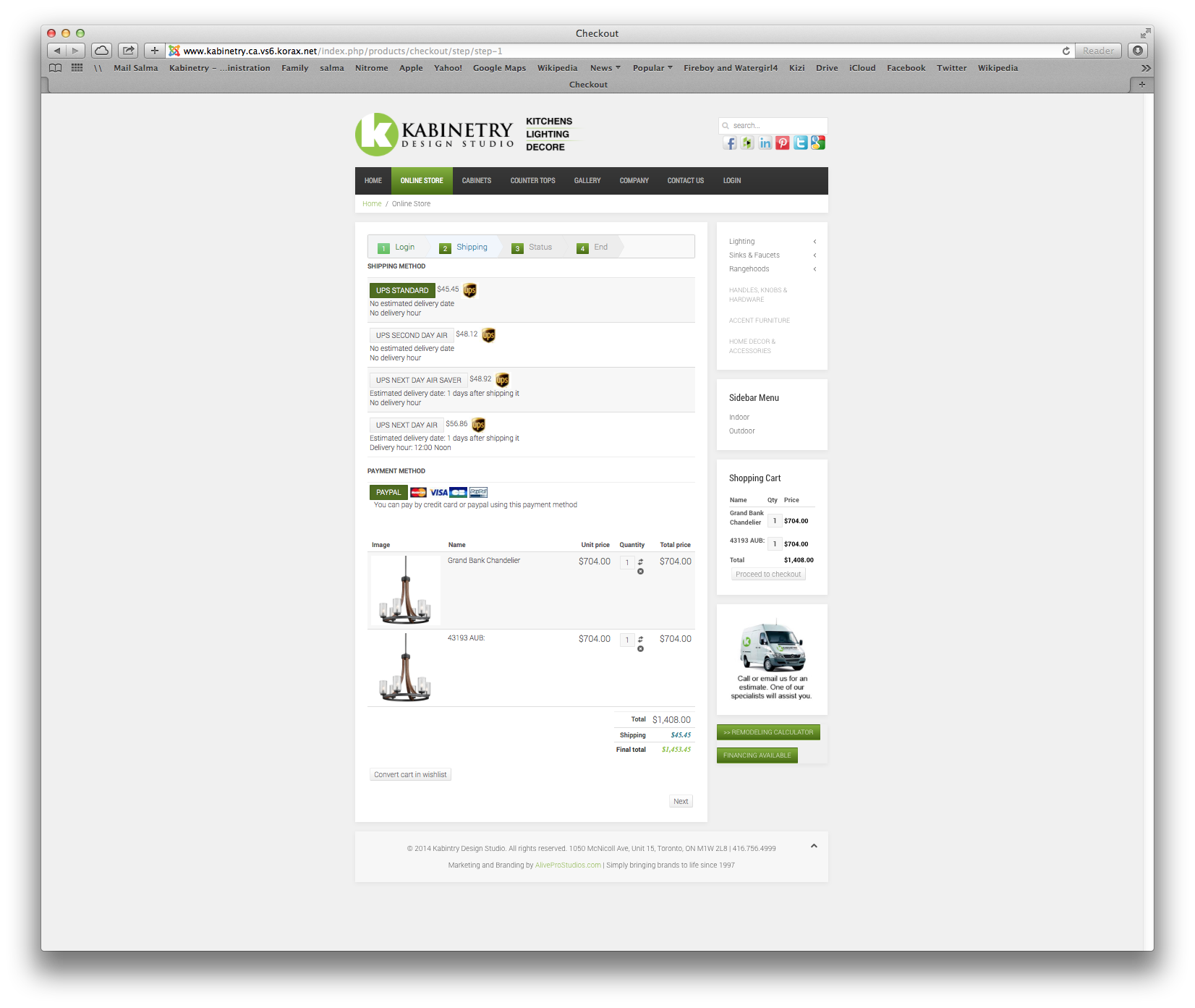

  • Posts: 19
11 years 10 months ago #167177
Hi Jerome,
I did specify the weight and indeed it is working.

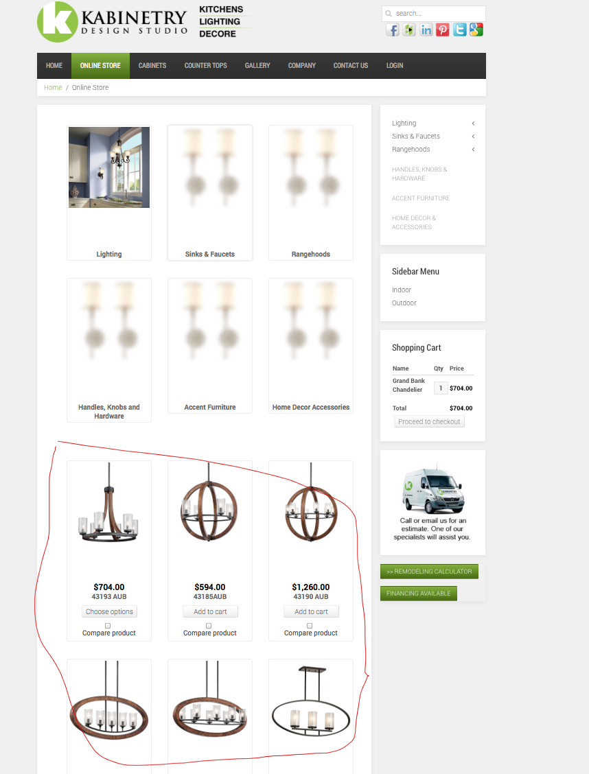

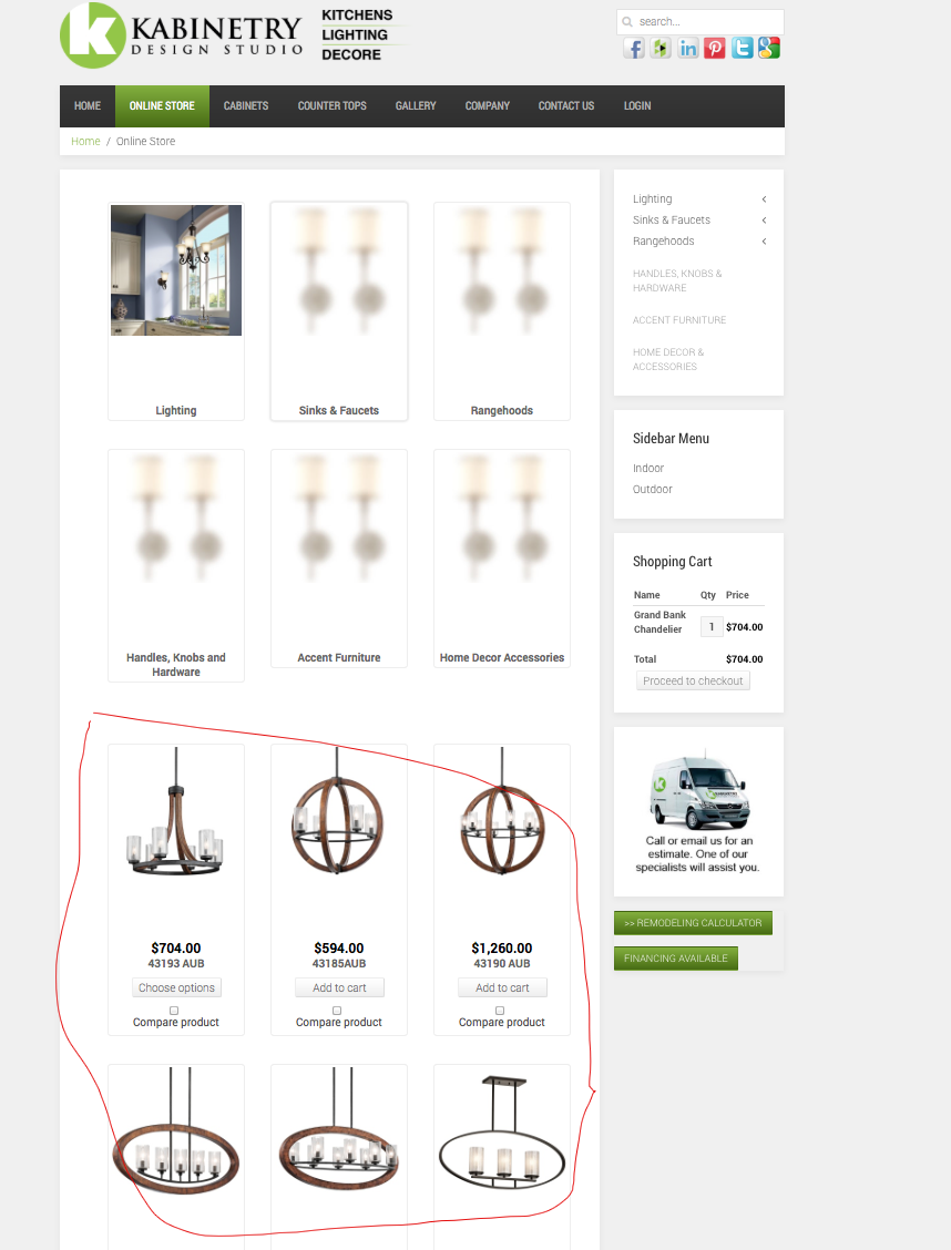

On my main product page some random products are appearing how can I avoid that?
www.kabinetry.ca.vs6.korax.net/index.php/products

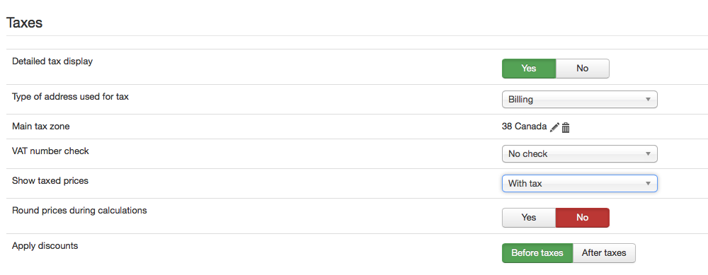

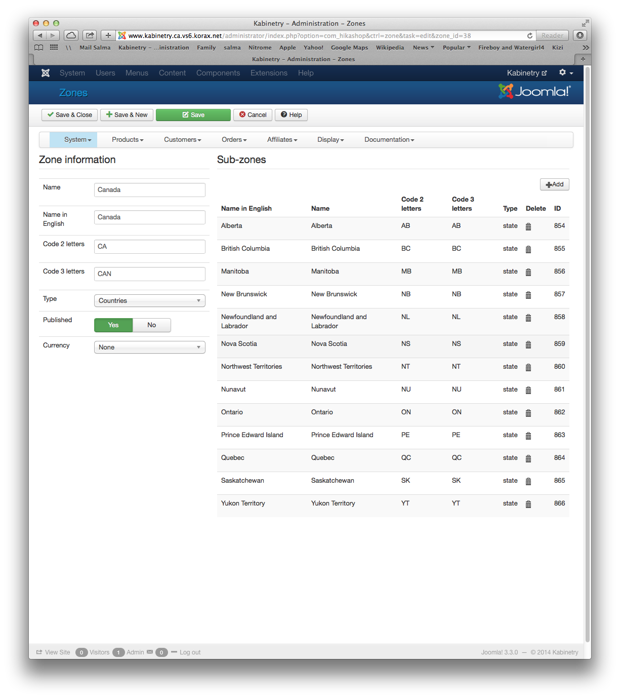

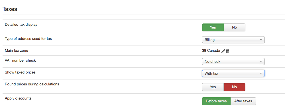

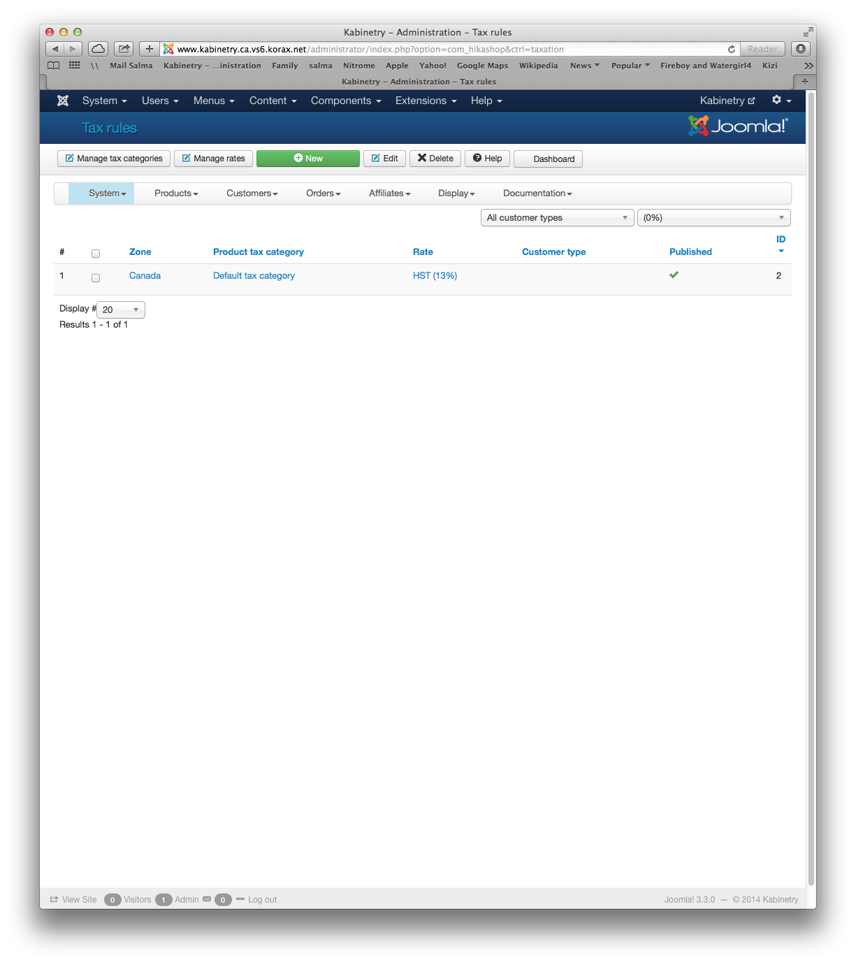

1. Please provide a screenshot of the screen in the menu System>Taxes of HikaShop so that we can see how you configured your taxes and make sure that you turned off the "show taxes prices" option of the configuration so that it only displays the taxes on the checkout after the user has entered his address.
2. Where do you get random products on that page ? I don't see any problem. Please provide a screenshot.

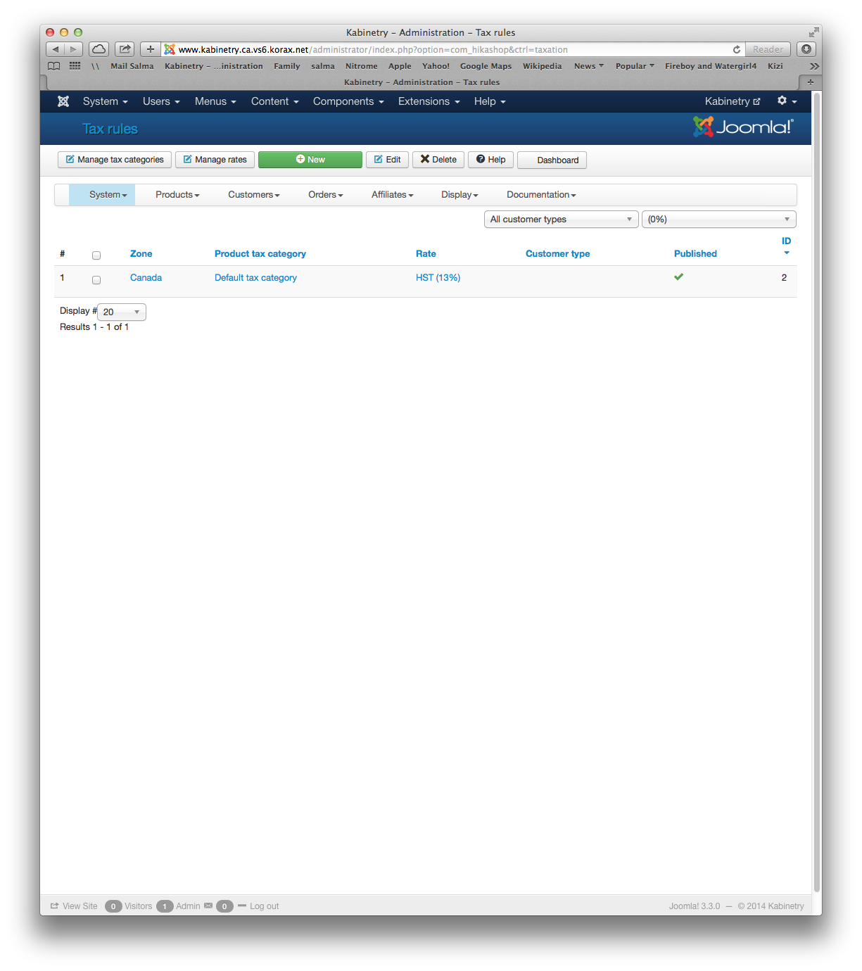

1. Please see attached a screen shot of the back end for the taxes. (Screen shot 1)
2. When I place order it does not show any taxes as well in the front end, how can I fix this. (Screen shot 2)

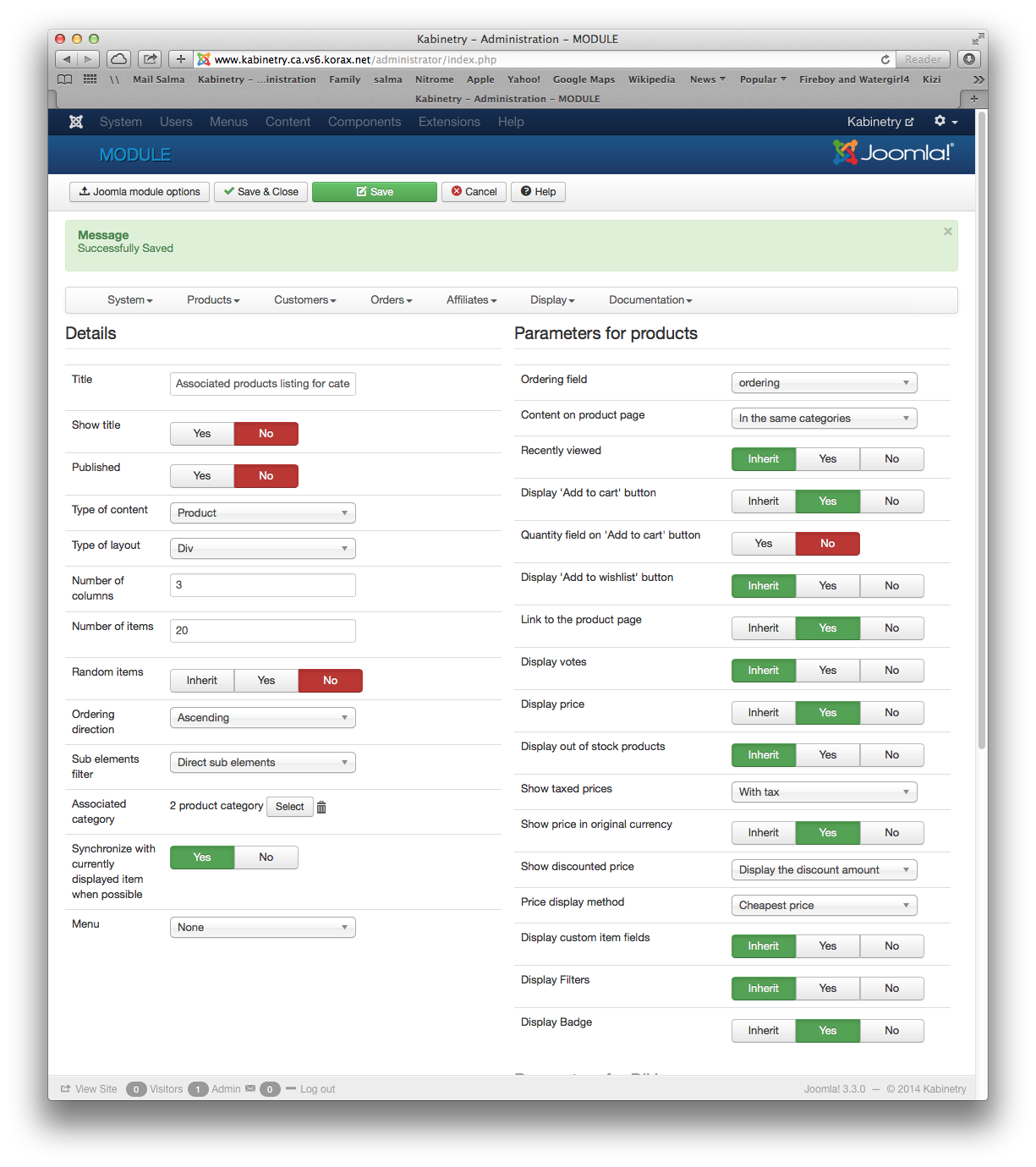

3. Random images showing on the main page (Screen shot 3)

1. and 2. Please provide a screenshot of the screen in the menu System>Taxes of HikaShop so that we can see how you configured your taxes. What you provided is a screenshot of the taxes section of the Main tab of the configuration of HikaShop which is something else than what I asked for.

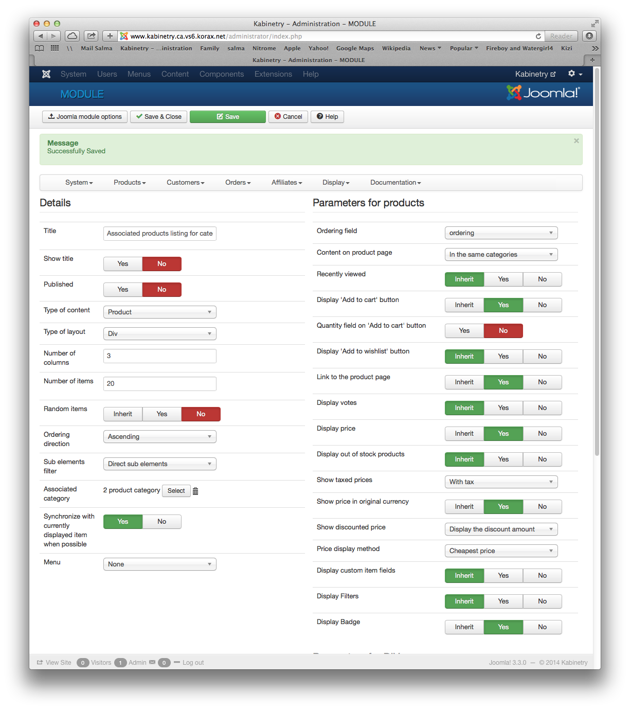

3. These are not random. These are the products of the categories. They are displayed there because in the options of your products listing module (that you can find when editing it (id 141) via the menu Display>Content modules), you have the "sub element filter" option set to "all sub elements" instead of "direct sub elements" so it is displaying the products of all the levels of categories below the current category instead of just the products directly below the current category.

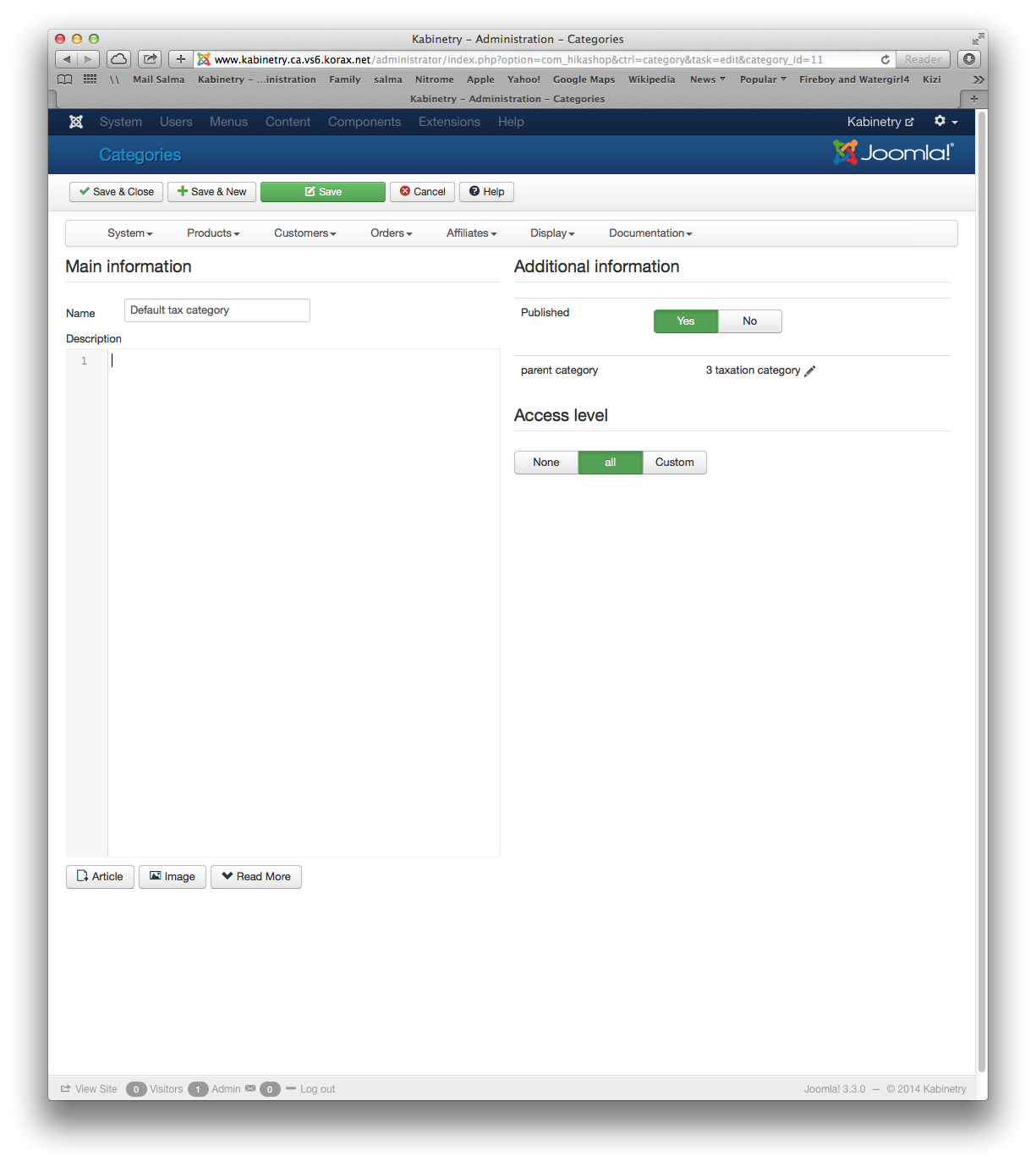

  • Posts: 19
11 years 10 months ago #167444
Hi Dear,
This is what I have.
Hope it is the right information.
Attachement 1-3 is for the taxes issue and attachement number 4 is for the random images.
I do have as direct sub element, but it is still displaying the random images.
Please advise.
thanks
  • Posts: 85733
  • Thank you received: 14061
11 years 10 months ago #167486
1. The settings of your tax rules look all fine. Please make sure that you selected the "default tax category" in your products "tax category" option or the tax rule will be ignored.
2. Turn off the "recently viewed" option of your module.

  • Posts: 26355
  • Thank you received: 4068
11 years 10 months ago #167594
2. He was talking about the screenshot named "4" in your previous post.
Even if the option is set to "inherit", Nicolas recommend you to set it to "no".
But I made some test and I don't see any random image. It's the product listing and the image I got in my browser are the exact same content as you made in your screenshot. So it's not random at all ; that's why I do not understand your question (and I do not understand the answer of Nicolas too).
Well, it's my point of view.

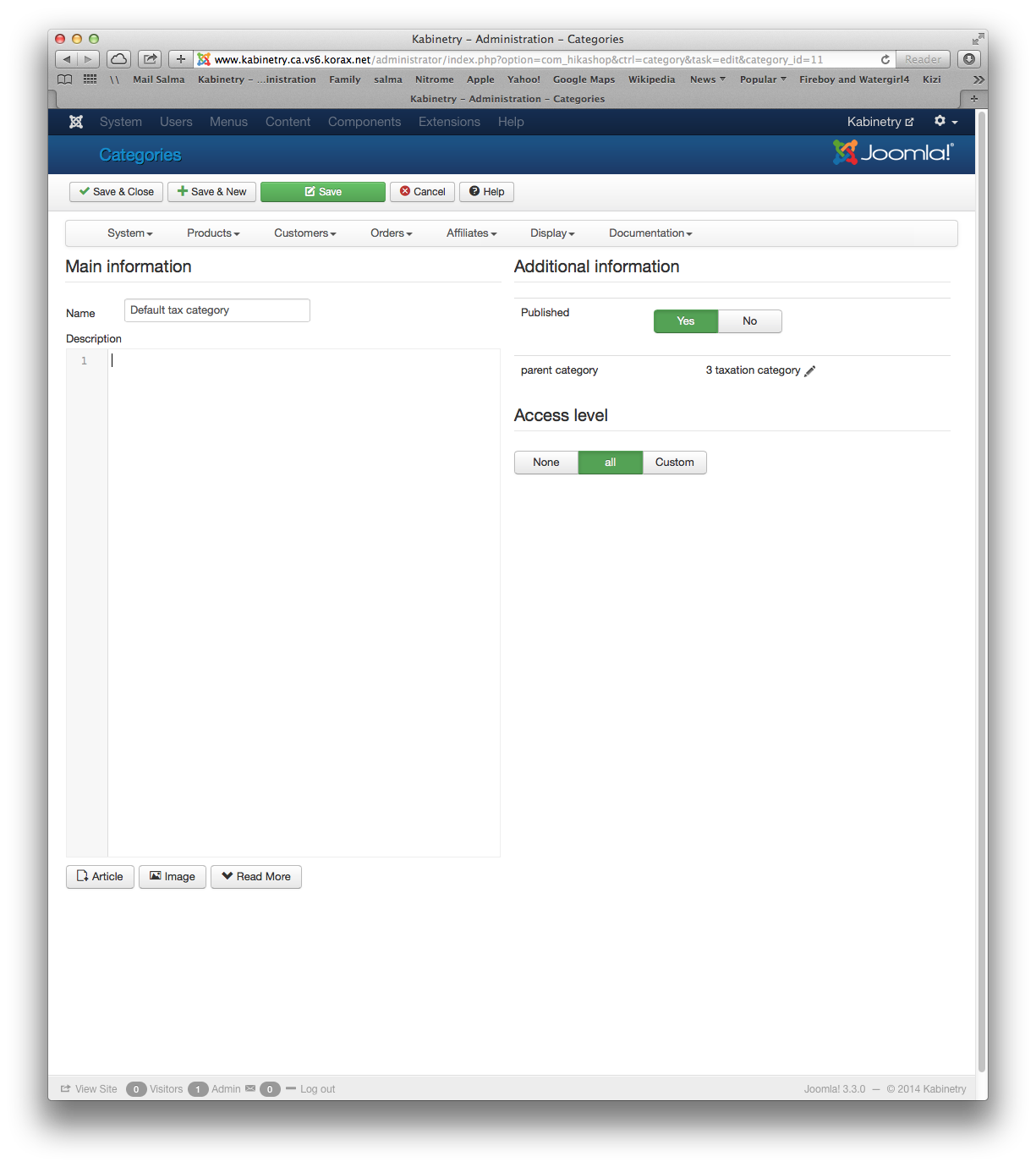

1. Well, let's reformulate what Nicolas wrote.
When you create or edit a product, you can select a tax category.
If the product have the tax category set to "none", it will mean that the product won't have any tax applied.
So you have to check that your products are right using the tax category named "default tax category".
See "product tax category" here :
www.hikashop.com/support/support/documen...r-documentation.html

Those products that are showing I do not want to show them at all.
All I want to display in the first page is the catagories.
