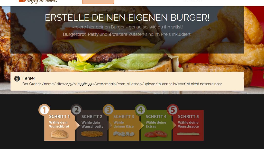

-- url of the page with the problem -- : www.roadburger.at
-- HikaShop version -- : 2.3.2 Business
-- Joomla version -- : 3.3.3
-- PHP version -- : 5.4
-- Error-message(debug-mod must be tuned on) -- : Error: The folder /home/.sites/275/site3961994/web/media/com_hikashop/upload/thumbnails/0x0f is not writeable

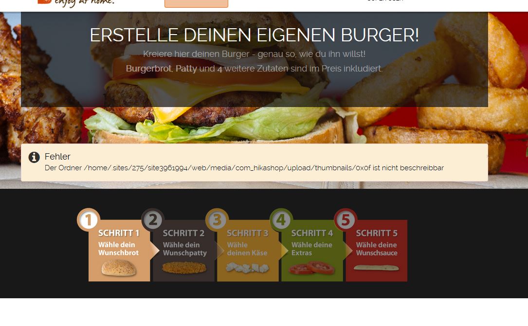

Hey guys, me again,
I did a update to 2.3.2 Business version. After that, I get an error on one of my hika site, see the screenshot below.
In english it means: Error: The folder /home/.sites/275/site3961994/web/media/com_hikashop/upload/thumbnails/0x0f is not writeable. But the folder rights are, as usual 755.
Any ideas?
  • Posts: 85733
  • Thank you received: 14063
11 years 10 months ago #166793
Well, the error doesn't lie. That folder either doesn't exist and your website doesn't have the right to write in the parent folder, or it exists and the website doesn't have the right to write in it.
755 might not be enough if your website user is not the same as the owner of the folder.

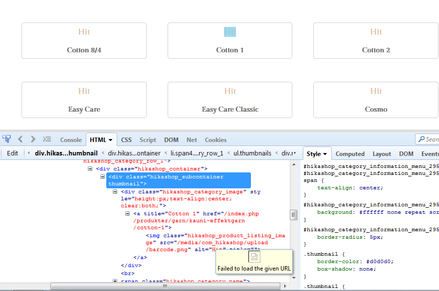

  • Posts: 43
10 years 9 months ago #212420
Hello.
I think I have an error related to this error.
When I make a menu item called categories, and will have all products in a category of the page. But there are no pictures?
Is there anyone who knows what mistakes I make?
Link to the error: engensgarnshop.dk/index.php/produkter/ga...ffektgarn/Cotton-8-4
and one more thing I do not get the popup to work, in the shopping cart and business conditions.
Henrik

10 years 9 months ago #212447
Hello Henrik, using firebug I can see that the code is calling the image, so I dont think is a hikashop problem. In the image you see the error fail to load given URL
You can check Display > Content modules > Parameter for divs > types of item layout.
And same thing for Content menu, where you will also see the same button for the associated module.
The following user(s) said Thank You: Henrik
  • Posts: 85733
10 years 9 months ago #212477
1. That link is a categories listing. The images of the products inside the categories display fine. So it would indicate that the category images have been deleted from your web server after adding them to the categories via the interface. Edit your categories via the Products>Categories menu of HikaShop and add the images again to your categories and that should help.
2. Change the "popup mode" setting of the HikaShop configuration to "mootools" that will circumvent the issue with your Joomla template not supporting Joomla 3 popups.

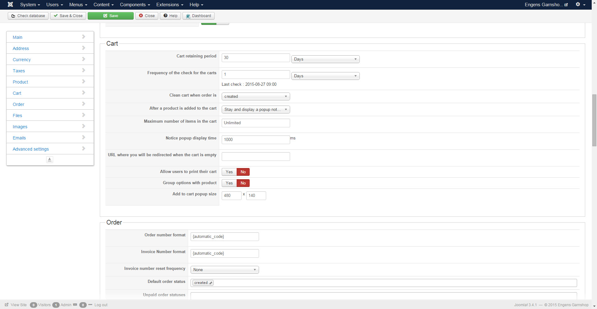

10 years 9 months ago #212490
Hello Henrik,
Now the pop up work in business conditions also, but when I put something in my shopping cart i cant get it to pop up, and if i run my cursor over the menu, after i ha added something in my cart, then the menu disappears?
1. Did you try it with the "After a product is added to the cart" option set to "Stay and display a popup notice" via "Hikashop->System->Configuration->Main" ? If yes, can you also set the "Use AJAX when possible for add to cart buttons" option to YES ?
2. Can you give me more information about it so that I can understand and reproduce that issue ?
Thanks.

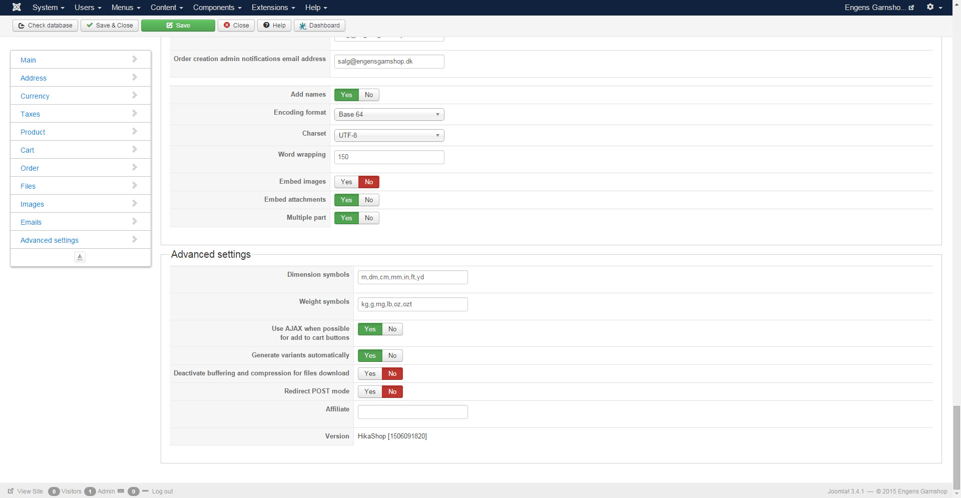

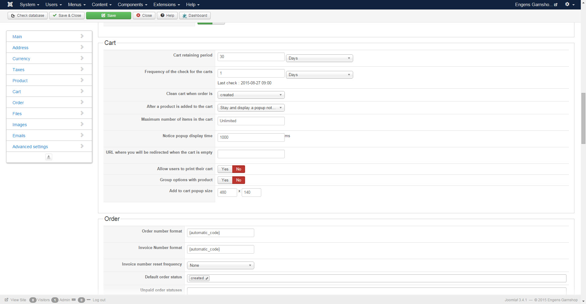

  • Posts: 43
10 years 9 months ago #212594
Hey
I have tried with your suggestions, but it dont work, when i put products in the cart, it dont popup and the menu disappears when i move the cursor over it?
engensgarnshop.dk/index.php/produkter/ga...66-easy-care?popup=1
Here you can se the settings in Admin.
Henrik
