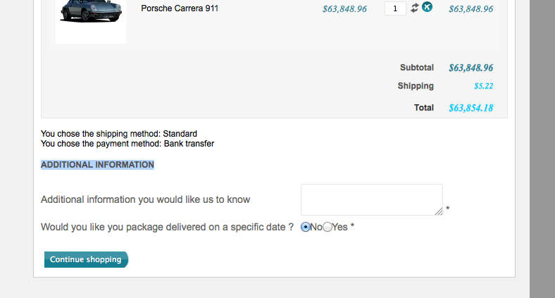

Good Morning,
how do I get in the cart field "Additional information" as in the attached image?
Thanks.
11 years 11 months ago #171134
You have to create custom fields in the "order " table via the menu Display > Custom fields, this way the "additional informations" part will be displayed.

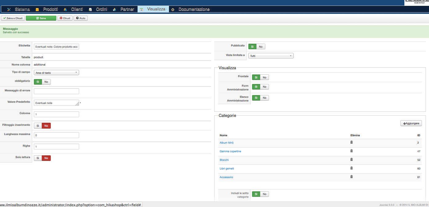

11 years 11 months ago #171155
I tried that but it does not work, where am I wrong.

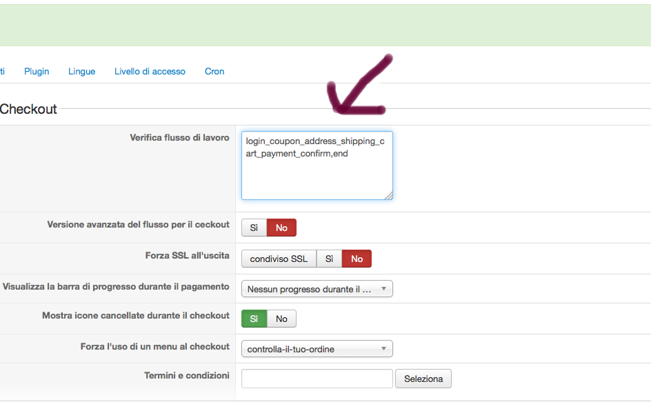

11 years 11 months ago #171156
The order custom fields are displayed in the checkout thanks to the step called "fields".
If this step element is not in your checkout workflow, the order custom fields won't be displayed to your customer.
Please check your checkout workflow configuration for that element.

For that, we have a documentation
www.hikashop.com/support/support/documen...ml#checkout_checkout
PS : you can activate the "Advanced checkout workflow edition" ; it should be better.

11 years 11 months ago #171264
Can you activate the "Advanced checkout workflow edition" option of the page "Hikashop->System->Configuration->Checkout" and make sure that the "fields" action is correctly added on your checkout workflow ?
