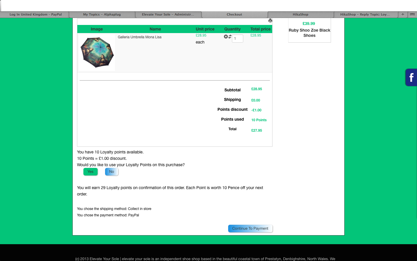

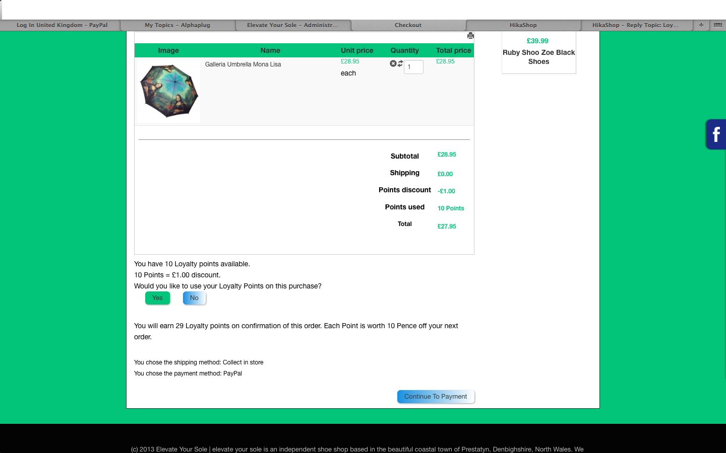

I've found 2 problems with the points system:
1) The 'final amount' isn't being pushed through to Paypal, which is my only payment method. Hikashop deletes the points from the users alpha points account, but doesn't show the discount at the Paypal end...
2) Instead of awarding points on the final amount, which is what I need. It awards points based on the unit price. I have taken a screenshot of what I mean. I want them to earn 28 points rather than 29 points.

11 years 11 months ago #173318
1. Please deactivate the option "Send details of the order" in your paypal plugin configuration.
The problem is not in the point system but in the "order details" sent by the paypal plugin.
2. Depending your configuration, yes the content of the cart and not the final total will be used.
But the problem is not there ; the plugin does not take in consideration the discount made by the points.
There is a option called "Don't give points when using some" which is there for that purpose.
But yes, we can see to remove the value of the discount made by points when we process the number of points that the user will earn. I'll add it in our TODO list.

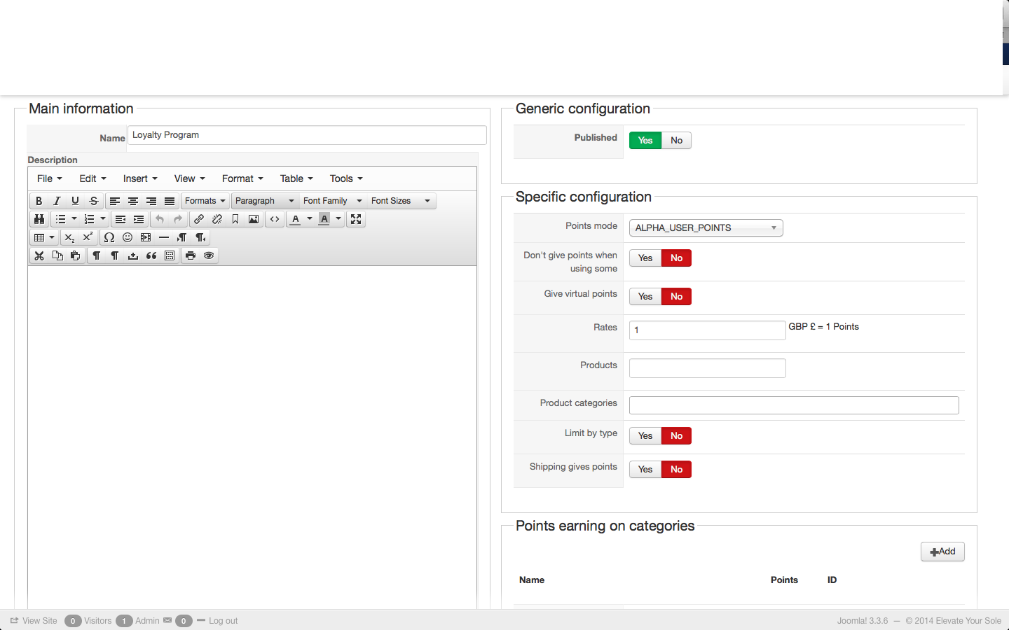

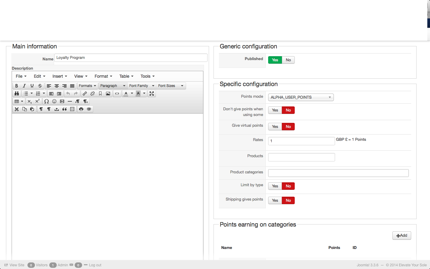

11 years 10 months ago #176389

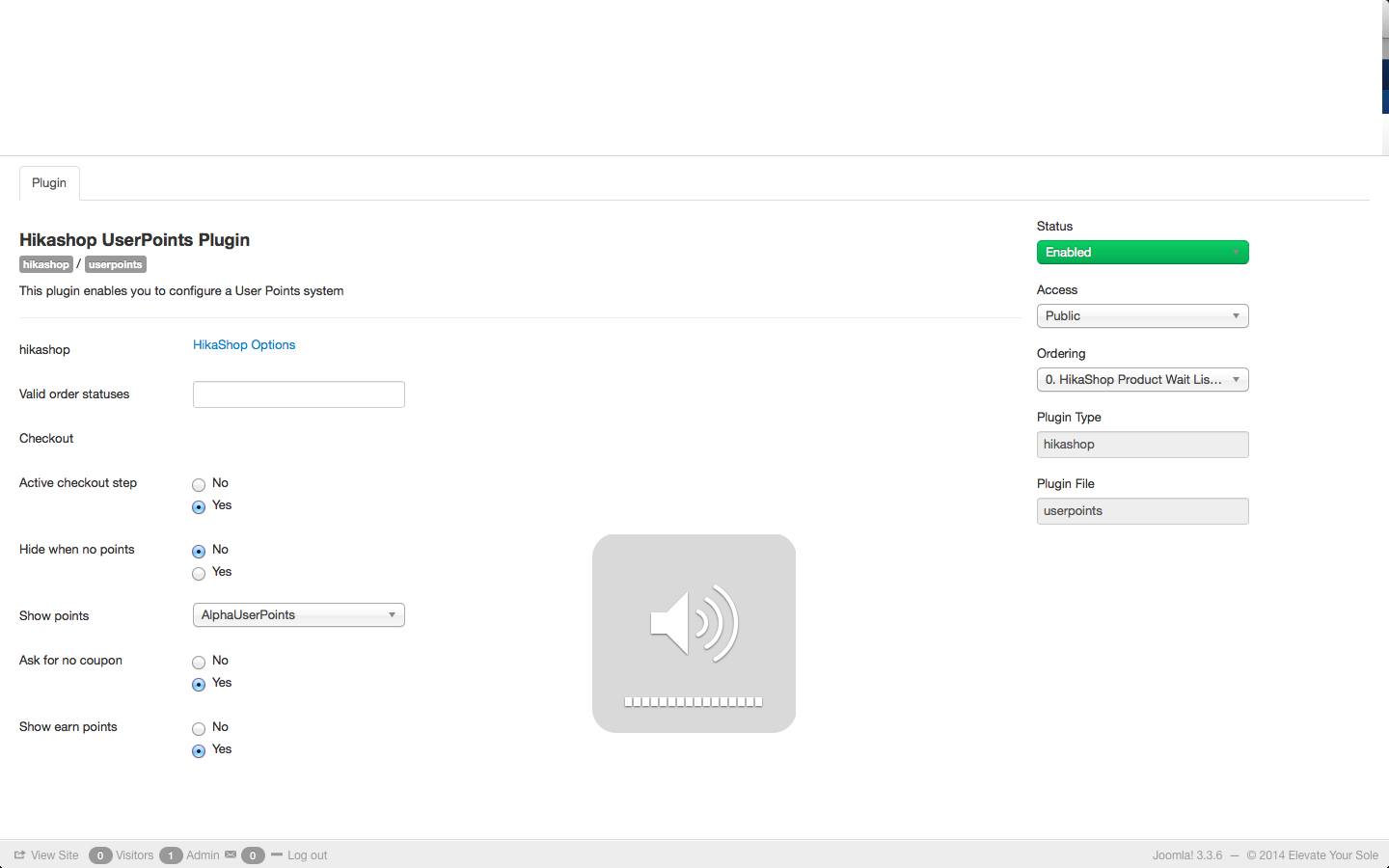

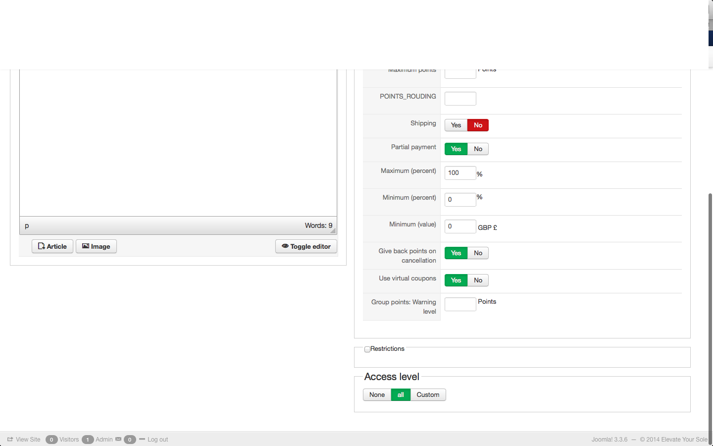

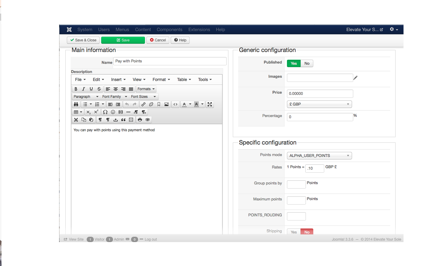

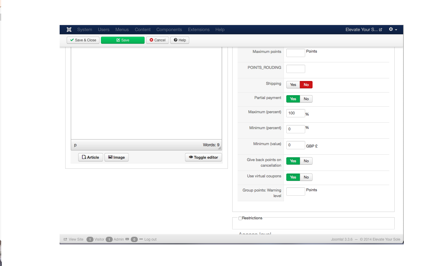

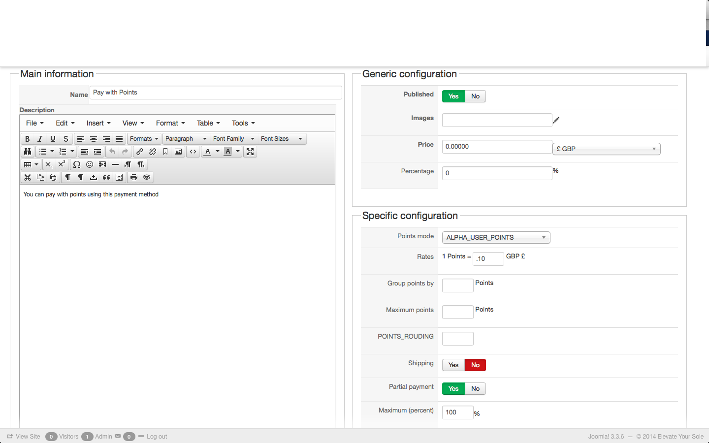

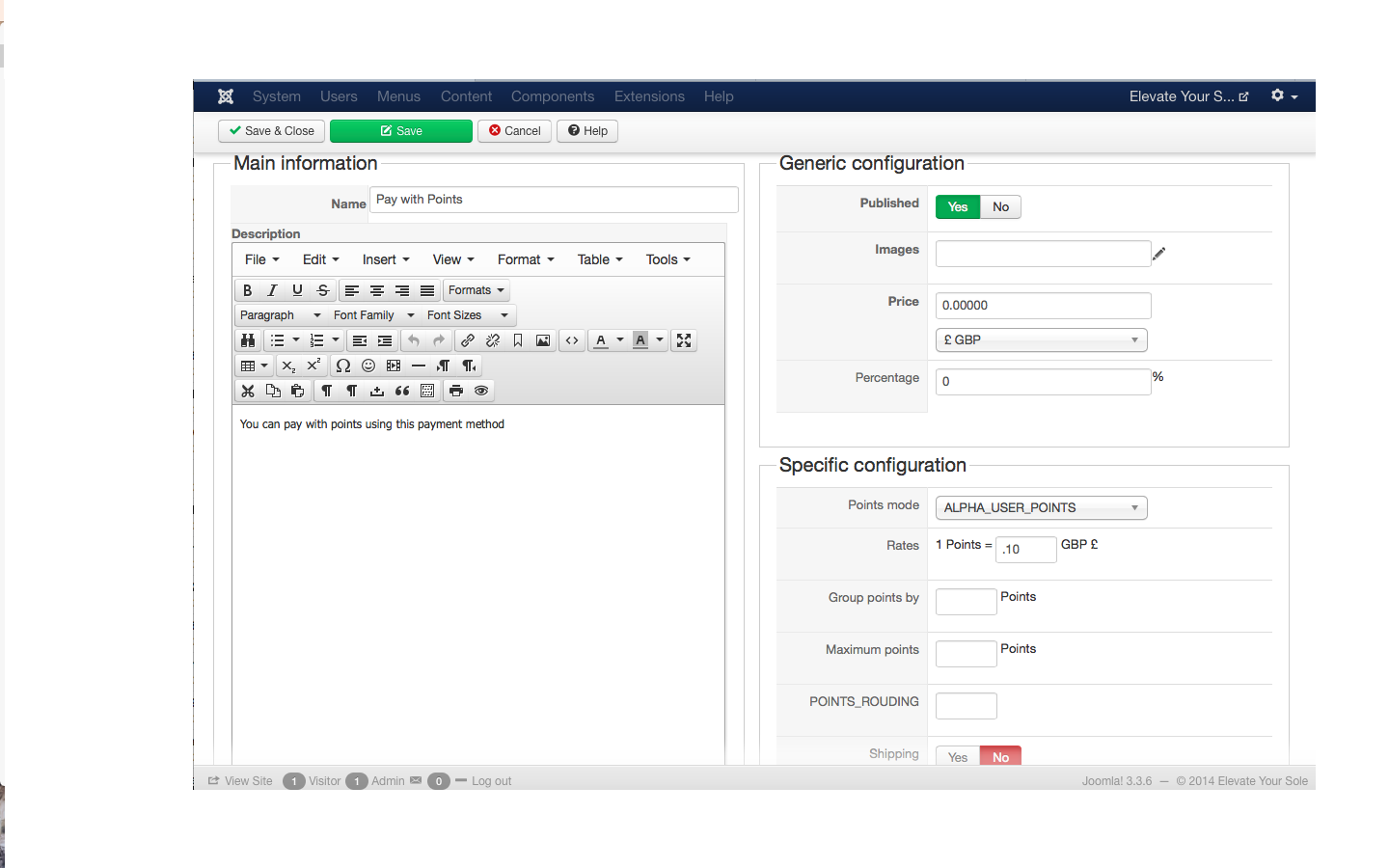

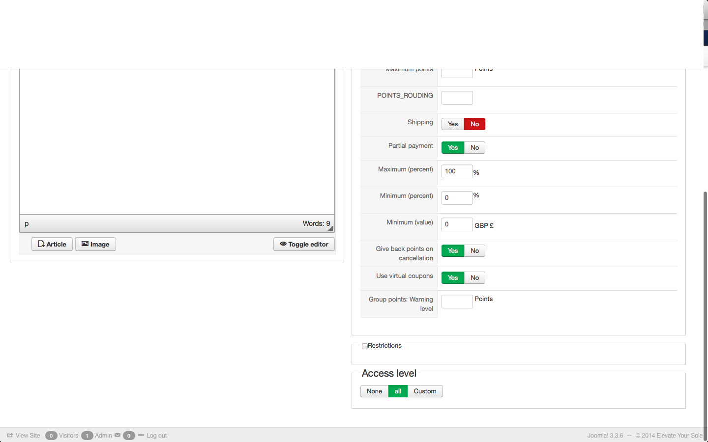

Can you please provide a screenshot of your plugin configuration ?

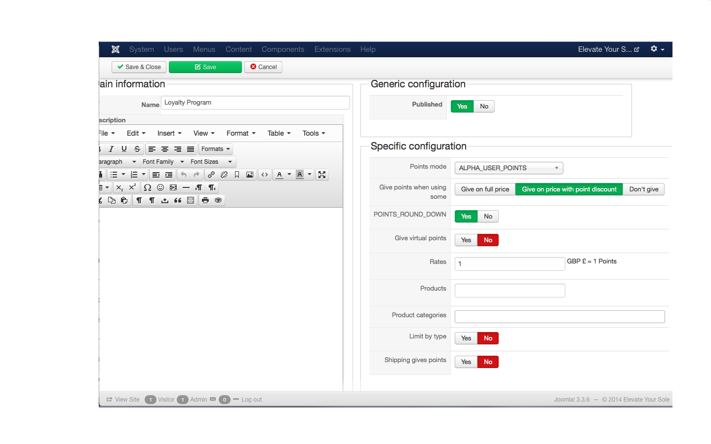

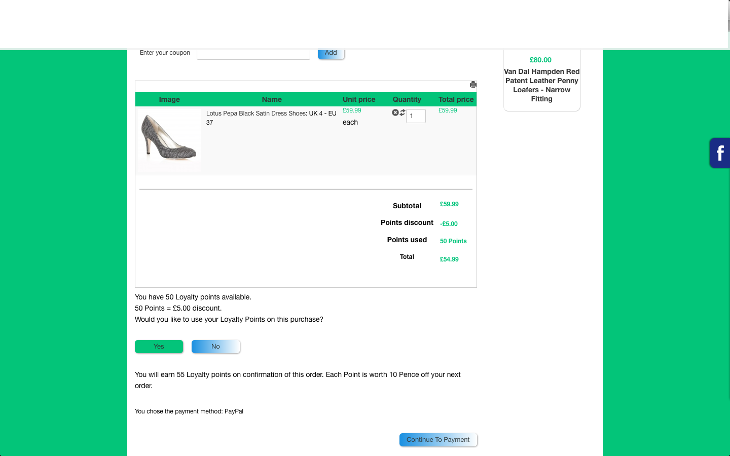

  • Posts: 265

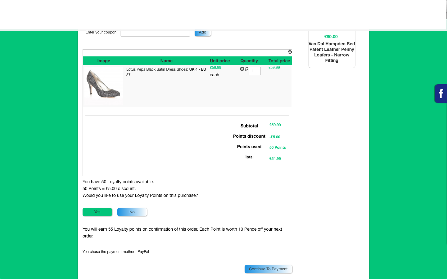

11 years 10 months ago #176628
HI Jerome,
Please find attached screenshots and the message from the checkout. In this instance it says that you will receive 55 points, but after confirmation the customer is awarded with 60.
Thanks,
Hal
11 years 10 months ago #176671
Please update HikaShop with the latest version ( 2.3.4 ) ; it contains improvements for the plugin "HikaShop - user points" about the processing and of the earn points when using points discount in the same time.
www.hikashop.com/support/support/documen...ashop-changelog.html
We improved the "user points" plugin with a new mode for the "give points when using some" option

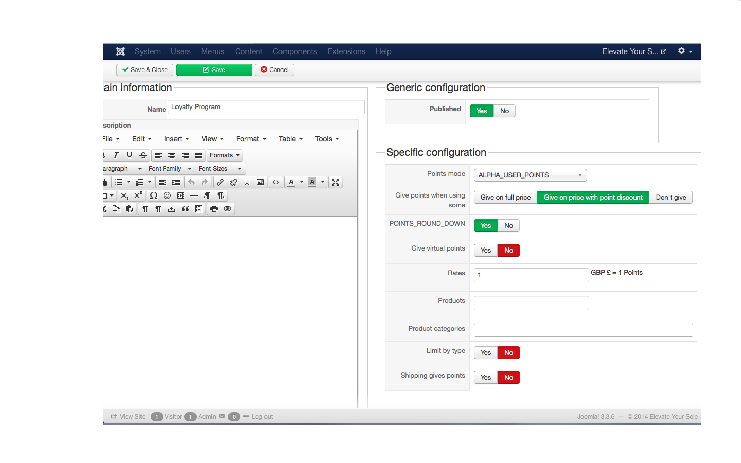

Can you please provide the screenshot of the "hikashop / user points" configuration with the new version ?
The new plugin have now 3 values for the option "give points when using some".
It is weird that the value is different before and after the order processing ; it is the same function which is used.

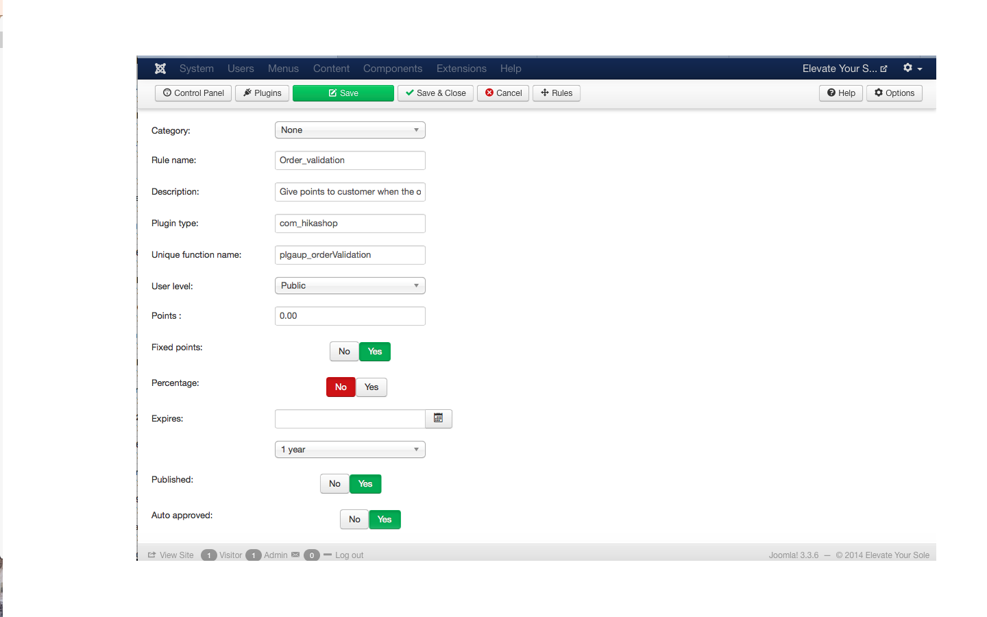

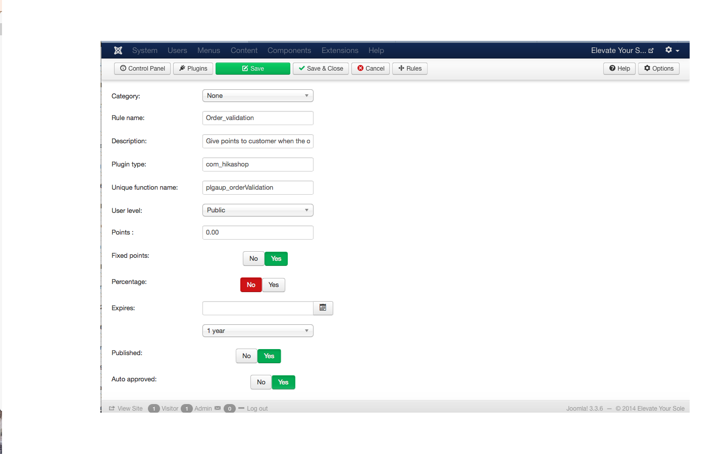

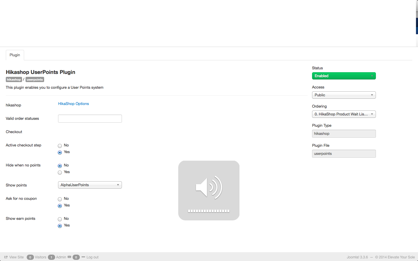

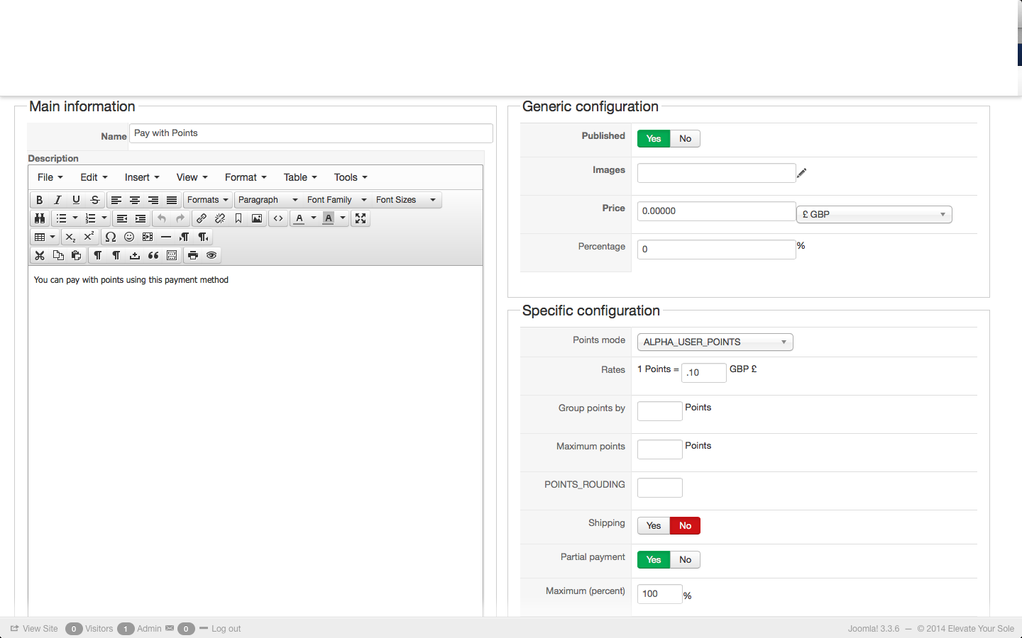

  • Posts: 265
11 years 10 months ago #177149
Please find attachments. I have also included the configuration of the rule within AUP.
I only realised when I checked someones account and they had earned 50 instead of 45 that I started to investigate...
Please feel free to take a look for yourself.
Thanks,
Hal
11 years 10 months ago #177174
Please edit the file "plugins/hikashop/userpoints/userpoints.php" and replace
if(!empty($this->plugin_params->notgivewhenuse) && (int)$this->plugin_params->notgivewhenuse == 2 && !empty($order->additional['userpoints'])) {
	$calculatedPrice += (float)$order->additional['userpoints']->price_value;
By
if(!empty($this->plugin_params->notgivewhenuse) && (int)$this->plugin_params->notgivewhenuse == 2 && !empty($order->cart->additional['userpoints']))
	$calculatedPrice += (float)$order->cart->additional['userpoints']->price_value;
It should fix the context problem.
  • Posts: 265
11 years 10 months ago #177217
Brill,
Thats done the trick.
Thank you!
