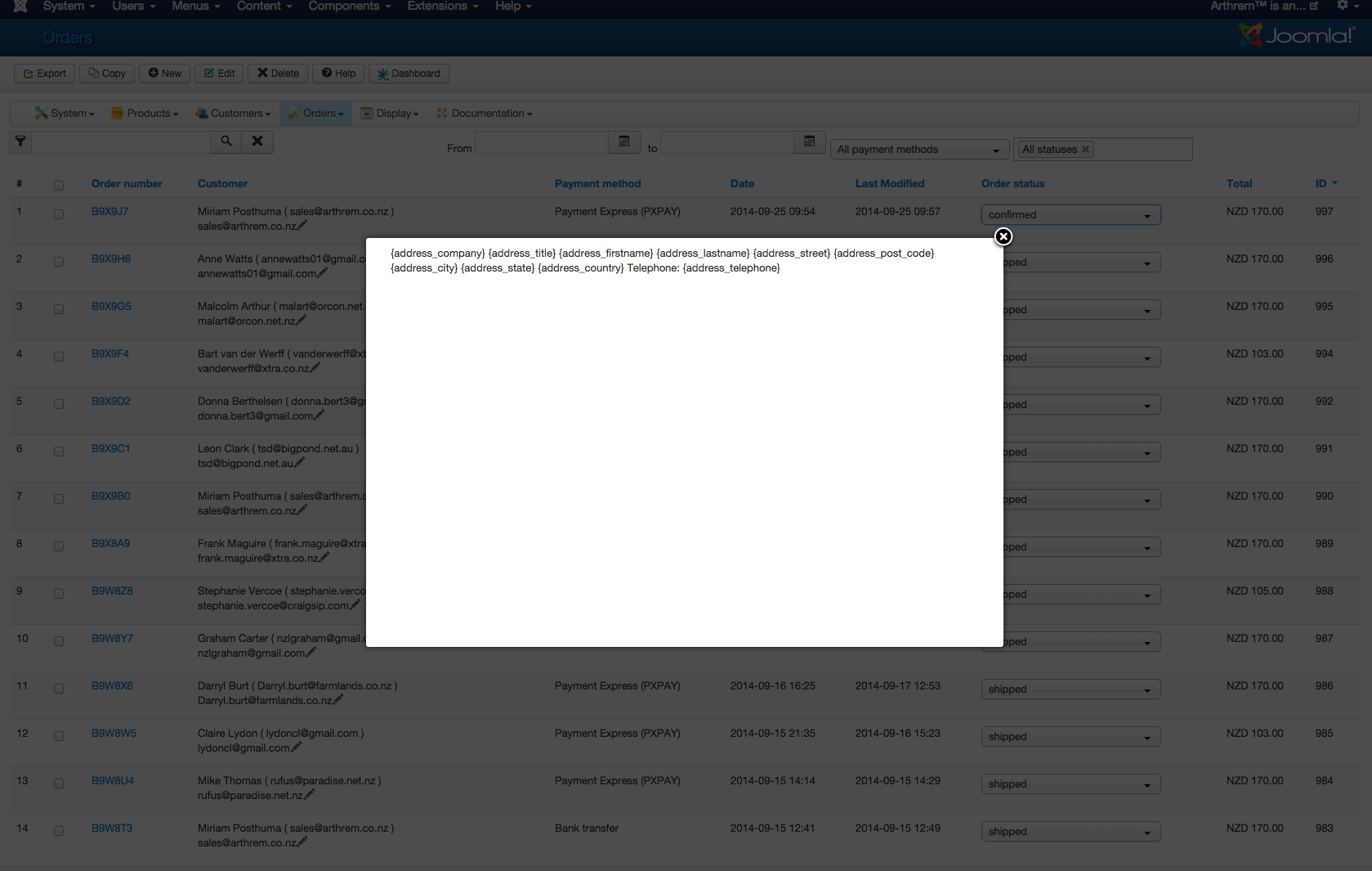

After Update to 2.3.3, Cannot Change the Order Status.
The pop-up window just gives gibberish instead of usual window.
See screenshot.
All caches have been cleared.

1. See : www.hikashop.com/forum/orders-management...r-update.html#172850
2. Please re-download HikaShop 2.3.3 to get the Joomla 3.3.4 patch.

11 years 11 months ago #172982
Hi Jerome -
The updated install did NOT fix the issue.
  • Posts: 293
  • Thank you received: 9
11 years 11 months ago #172983
I did the manual patch as per your post.
That worked fine.
Thanks.

11 years 11 months ago #172987
Downloading the latest version of HikaShop Business did NOT fix the problem for me.
I had to do the patch manually.
  • Posts: 86104
  • Thank you received: 14203
11 years 11 months ago #173024
We did update the demo website with the latest build of the 2.3.3 and it works fine there without applying the patch so it means that the patch was correctly added in the latest build of the 2.3.3.
So you probably used the install package from before we added the patch in it.

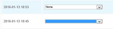

Hello!
I have updated hikashop to 2.6.1.
I was unable to change the order status.
Refer to the picture to see what it looks like when i change to any of the statuses.
10 years 7 months ago #226539
You're not in the right topic.
Your issue is related to a Joomla 3.4.4 - 3.4.8 bug.
You should use "vex" popup to fix that issue or patch your Joomla.
www.hikashop.com/support/documentation/3...-hikashop-2-6-1.html
