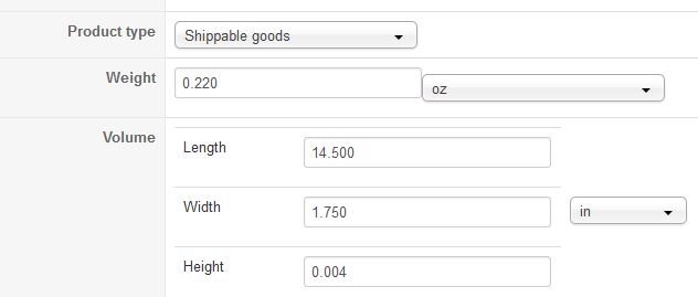

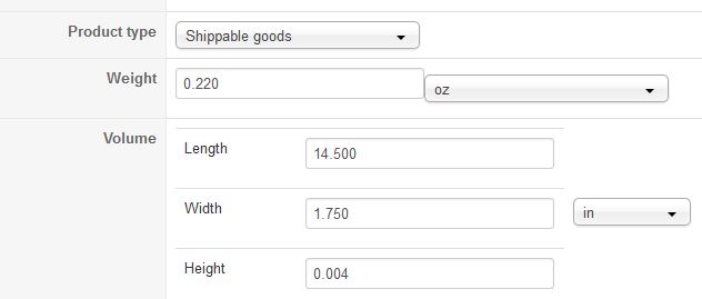

Hello, I am getting the following error for a USPS shipment to Taiwan:
USPS error: -2147218043 Unable to calculate international postage. No services available. According to the dimensions entered, your package is too large to be mailed
The quantity ordered is 144 PCS. See attached for the item dimensions and weight. Even if i change the quantity to 10 i still get the same error. Changing the quantity to 1 seems to work ok. Any Ideas?

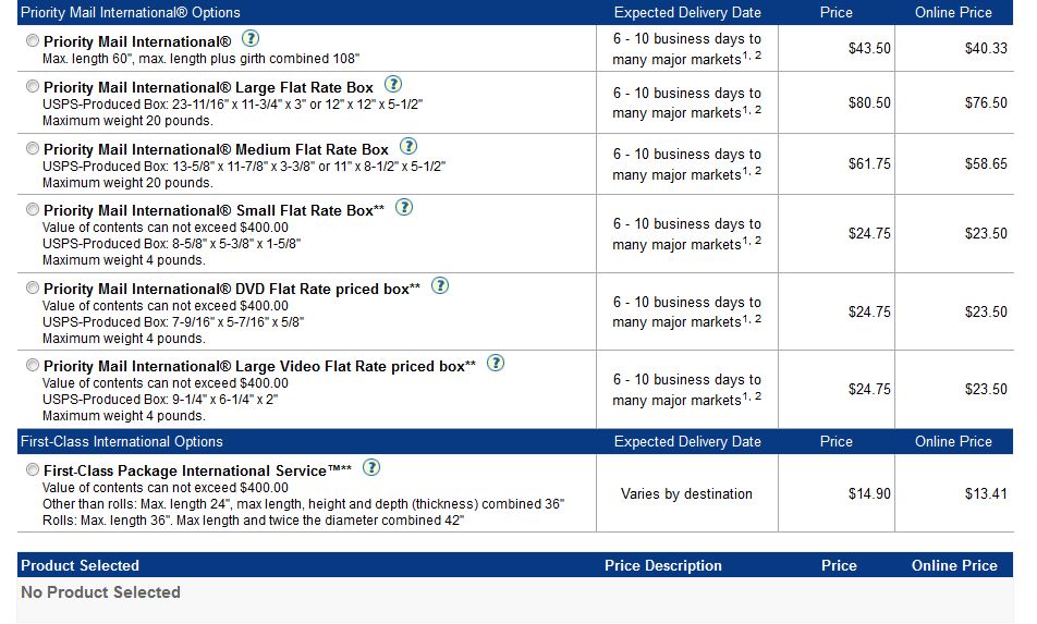

11 years 10 months ago #178559

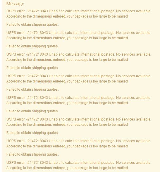

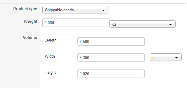

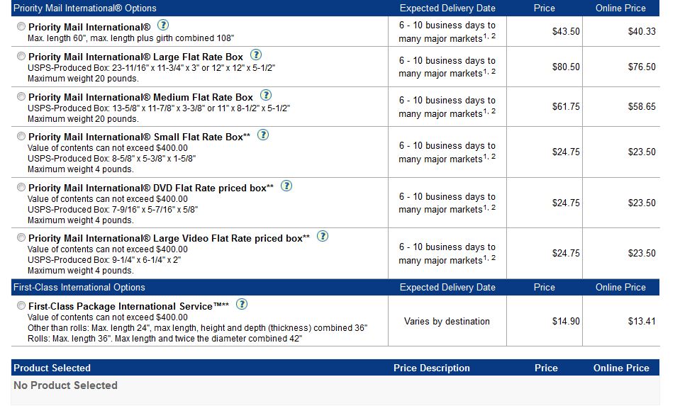

Hi I am still having having problems with this issue. Please see the attached images. Hikashop declares no shipping available however if i put the same information on the USPS web site it gives me several rate options. 25% of my orders are international so this is a big problem for me.
11 years 10 months ago #178666
The USPS shipping plugin is only sending to USPS your order product weight / dimensions and then just displaying the rates/prices that USPS gave to your USPS shipping plugin.
So the solution will probably be to directly contact USPS about their API.

11 years 10 months ago #178713
Hi, Works fine with opencart and prestashop? Hikashop uses a different API? I believe the problem is related to the way hikashop is calculating the dimensions of the product. For example if the product is 5x5x1 inches, if i add 5 items to the cart hikashop makes the total package dimension 25x25x5 inches and sends that to the usps api. In reality five items that are 5x5x1 inches will fit in a box less then 8x8x8 inches. What do you think?

For my product 14.5x1.75x0.004 in ; with 4 products in the cart I got
array (size=4)
  'l' => float 14.5
  'w' => float 1.75
  'h' => float 0.016
  'g' => float 18.032
Which looks normal regarding the documentation or other instructions that we can found on the Internet.

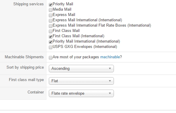

  • Posts: 12
11 years 9 months ago #179556

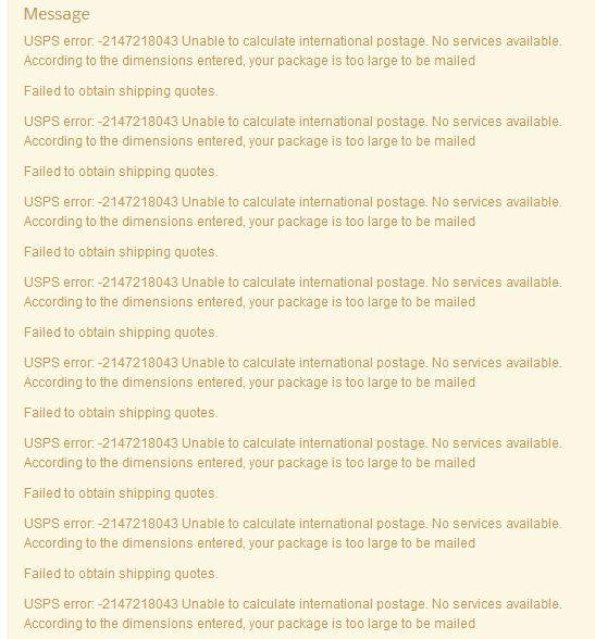

Installed it. Selected First Class Mail (International) and Priority Mail International (International) but still the same errors:
Message
USPS error: -2147218043 Unable to calculate international postage. No services available. According to the dimensions entered, your package is too large to be mailed.
If I change the address to a US with the same size envelop the error goes away.
going-natural.com the source for a new generation.

  • Posts: 12
11 years 9 months ago #179642

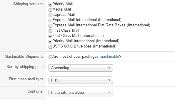

I don't get it. Can you please tell me exactly what to check so maybe I can get it to work? See the attachment to see what I checked. Let me know if I am missing something.
