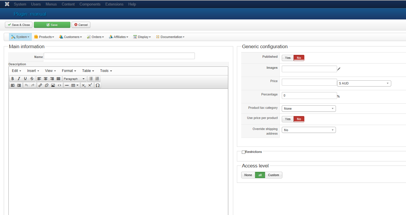

11 years 11 months ago #174907
Hello, Mohamed Thelji.
Good afternoon!

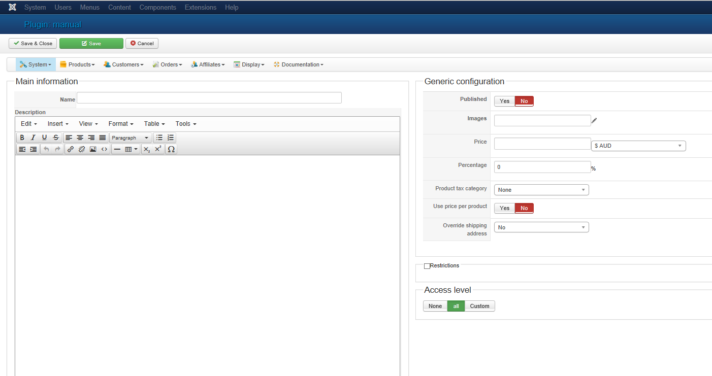

Thanks for the suggestion. I cannot find the maximum and minimum weight settings that you talked about. Please see the attached file. I am using Hikashop Business v 2.3.2.
Thanks.
Take care!
11 years 10 months ago #174917
You'll just have to check the "Restrictions" checkbox :).

11 years 10 months ago #176103
Good evening!
Silly me! Yes, something so obvious.

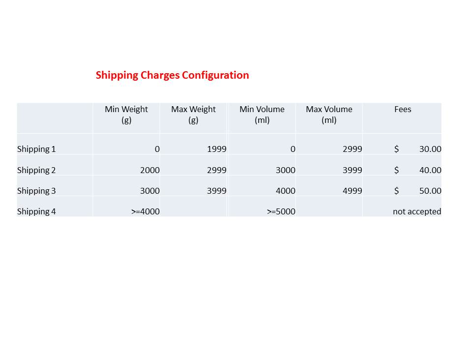

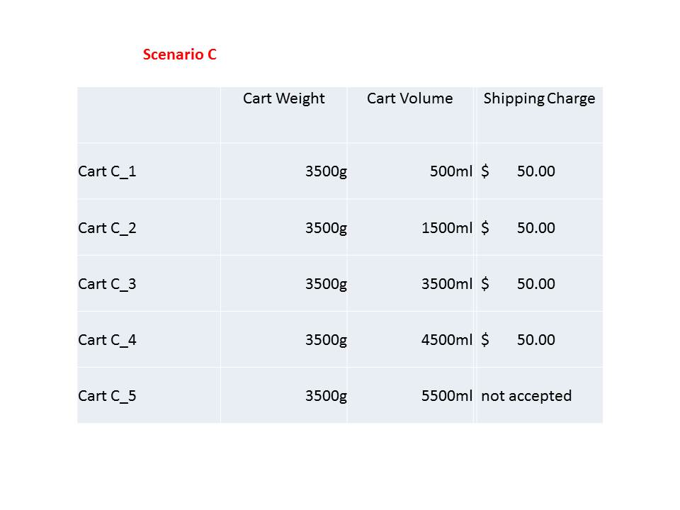

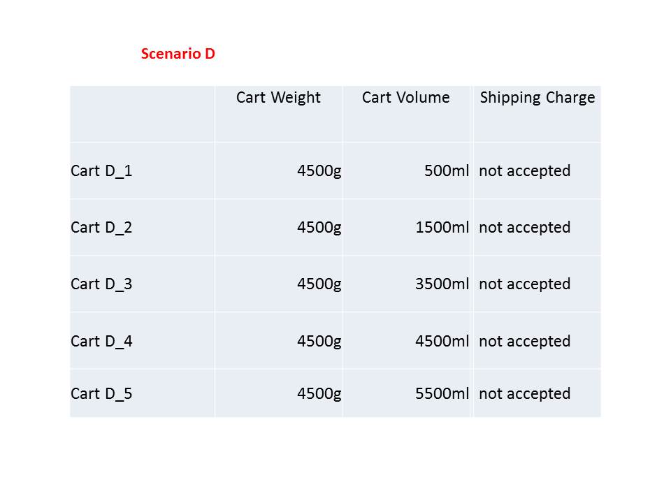

Please could you help with the following 2 questions regarding shipping charges? They are:
1) Configuring Shipping Charges for Weight or Volume
The requirement here is to charge based on a weight range or volume range, and the greater shipping charge that is triggered based on the cart weight and volume will apply (please refer to the attached example).
When the cart weight or volume exceeds the configured volume, the system will not allow the user to check out and a message will be displayed.
Please let me know how to configure Hikashop and/or customise the code to enable this to happen. A sample code and the name(s) of the file(s) to edit will help greatly.

1. The solution will be to directly create one shipping method per case.

11 years 9 months ago #179541
Thanks, Mohamed Thelji.
Please could you clarify "directly create one shipping method per case"?

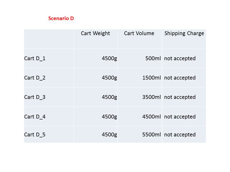

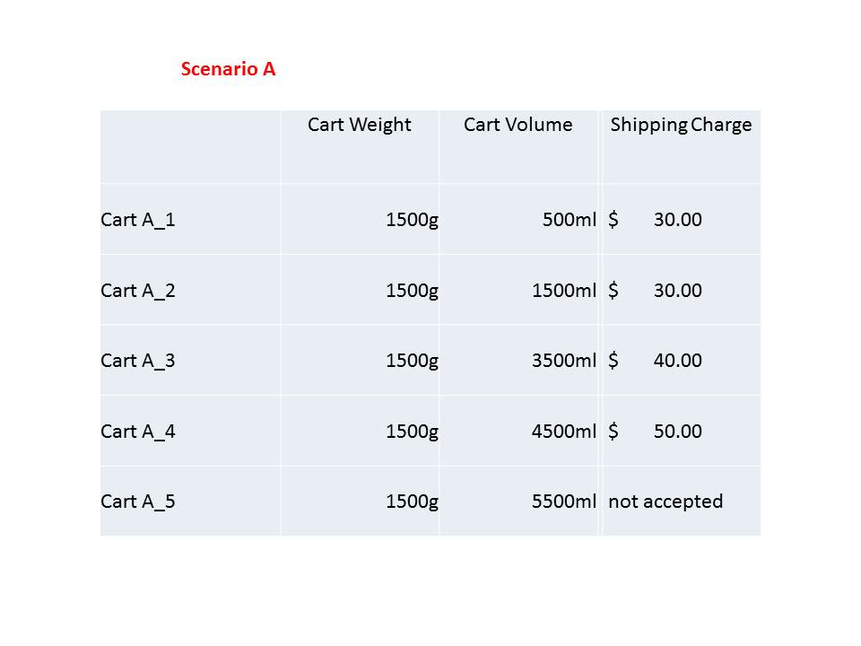

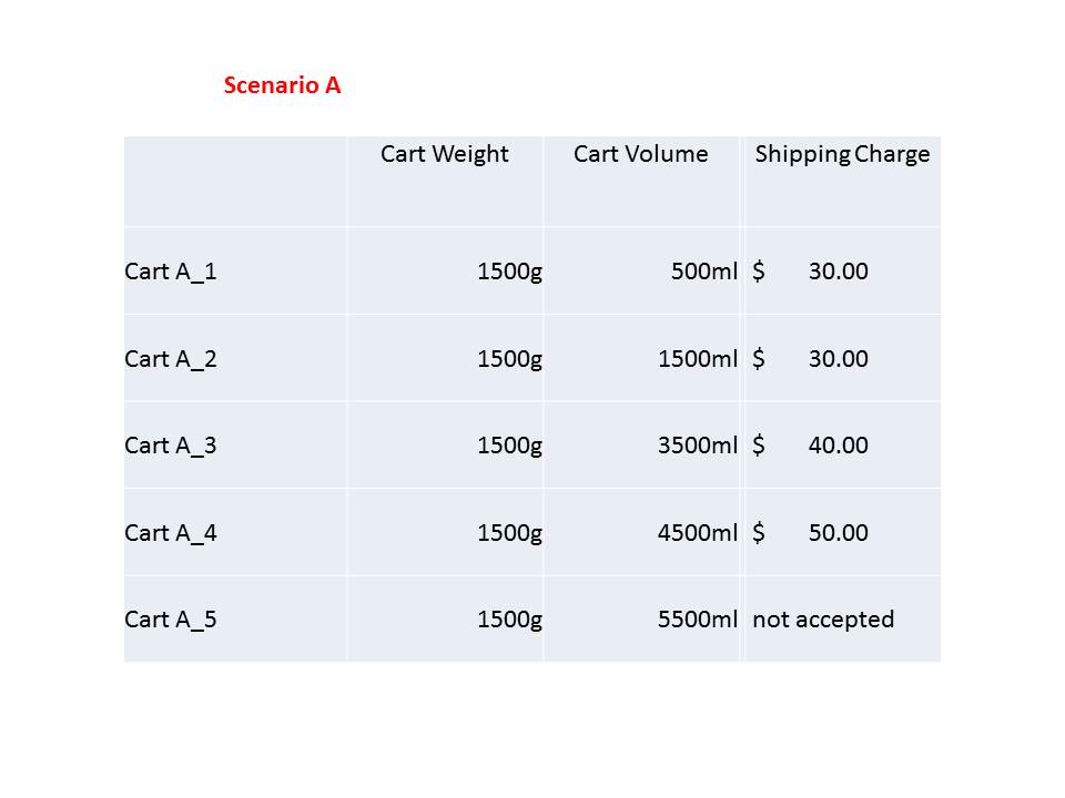

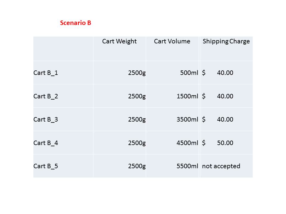

Perhaps, I should clarify the scenarios in the previous illustration. The scenarios refer to the total cart weight and volume as the user adds items to the cart. For instance:
a) Cart A_1 refers to the total cart weight of 1500g and total cart volume of 500 ml, in which case the shipping charge will be $30.00
b) as the user adds more items to the cart, the total cart weight and total cart volume will increase; for example, Cart B_2 refers to the total cart weight of 2500g and total cart volume of 1500 ml, in which case the shipping charge will be $40.00
By "cart level", I am referring to the Hikashop cart module (as in product/cart.php file).

11 years 9 months ago #179617
1. You'll have to make sure that you have created a shipping method for each case (all the combination of cart dimension/weight).

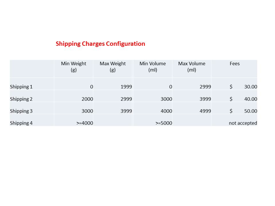

11 years 9 months ago #180147
Good evening!
Regarding having "to make sure that you have created a shipping method for each case (all the combination of cart dimension/weight)", does that mean that the following shipping methods are required? They are:
a) Shipping 1a
Min Weight = 0
Max Weight = 1999
Fee = $30
b) Shipping 1b
Min Volume = 0
Max Volume = 2999
Fee = $30
c) Shipping 2a
Min Weight = 2000
Max Weight = 2999
Fee = $40
d) Shipping 2b
Min Volume = 3000
Max Volume = 3999
Fee = $40
e) Shipping 3a
Min Weight = 3000
Max Weight = 3999
Fee = $50
f) Shipping 3b
Min Volume = 4000
Max Volume = 4999
Fee = $50
g) Shipping 4a
Min Weight = 4000
Fee = not accepted
h) Shipping 4b
Min Volume = 5000
Fee = not accepted
Regarding point 2, "display a shipping price regarding the cart total weight/dimensions", are you able to provide the snippet of code that refers to the object and element for the shipping price?
Thanks for your help.
Take care!
11 years 9 months ago #180169
1.
My advice was just to make sure that all your shipping method can handle the calculation of the shipping price regarding every combination of order weight/volume.
For example :
- Cart weight 1500g/ Volume 500 ml ==> $30
- Cart weight 1500g/ Volume 4500 ml ==> $50
- Cart weight 2500g/ Volume 500 ml ==> $40
- Cart weight 2500g/ Volume 4500 ml ==> $50
2. That won't be that simple to do it, you'll need some development skill to write your shipping calculation algorithm, the best solution will probably to find a third party developer via the " commercial jobs " section for example.

11 years 9 months ago #181330
No you will not have to create one solution per gram and ml.
You just have to create as many shipping methods as prices.
The system work with intervals, so set the min weight, max weight allowed and min volume and max volume for the $30 shipping. Then another one with the correct restrictions for the $40 one, etc.
So creating many methods like that, one per price range and which are covering all the possible weight and volumes is enough ;)

c) If Cart Weight = 1500g and Cart Volume = 3500 millilitre, what is the shipping fee? No shipping method
d) If Cart Weight = 1500g and Cart Volume = 4500 millilitre, what is the shipping fee? No shipping method
e) If Cart Weight = 2500g and Cart Volume = 500 millilitre, what is the shipping fee? No shipping method
f) If Cart Weight = 2500g and Cart Volume = 1500 millilitre, what is the shipping fee? No shipping method
g) If Cart Weight = 2500g and Cart Volume = 3500 millilitre, what is the shipping fee? Shipping2
h) If Cart Weight = 2500g and Cart Volume = 4500 millilitre, what is the shipping fee? No shipping method
~~~~~~~~~~ END OF TEXT ~~~~~~~~~~
In particular, I have the following questions:
1) why is answer to c) above "No shipping method"? How do I configure Hikashop such that the answer will be "Shipping2"?
2) why is answer to d) above "No shipping method"? How do I configure/customise Hikashop such that the system will throw up an error message and disallow the user to check out?
3) why is answer to e) above "No shipping method"? How do I configure Hikashop such that the answer will be "Shipping2"?
4) why is answer to f) above "No shipping method"? How do I configure Hikashop such that the answer will be "Shipping2"?
5) why is answer to h) above "No shipping method"? How do I configure/customise Hikashop such that the system will throw up an error message and disallow the user to check out?
Essentially, the business rules that I am trying to configure will be:
A) to charge the higher shipping fee between total cart weight and total cart volume
B) to disallow the user to checkout if either the total cart weight or total cart volume exceeds the highest limit
Thanks again.
Take care!
11 years 9 months ago #181453
1.
A )
Because for :
- Shipping 1 : the weight is OK (1000g < 1500g < 1999g) But not the volume (1000 millilitre<2999 millilitre<3500 millilitre)
- Shipping 2 : the volume is OK (3000 millilitre < 3500 millilitre < 3999 millilitre) But not the weight (1500g<2000g<2999g)
B )
You'll have to enlarge your weight restriction so that 1500 will be included.
2. Because 4500 millilitre isn't included in your 2 shipping volume restriction.
3. Because 500 millilitre isn't included in your 2 shipping volume restriction.
4. Because 1500 millilitre isn't included in your 2 shipping volume restriction.
5.
A ) Because 4500 millilitre isn't included in your 2 shipping volume restriction.
B ) Having a "No shipping method was found" or "Package too large" will be enough to throw up an error message and disallow the user to check out
Last edit: 11 years 9 months ago by Mohamed Thelji.
