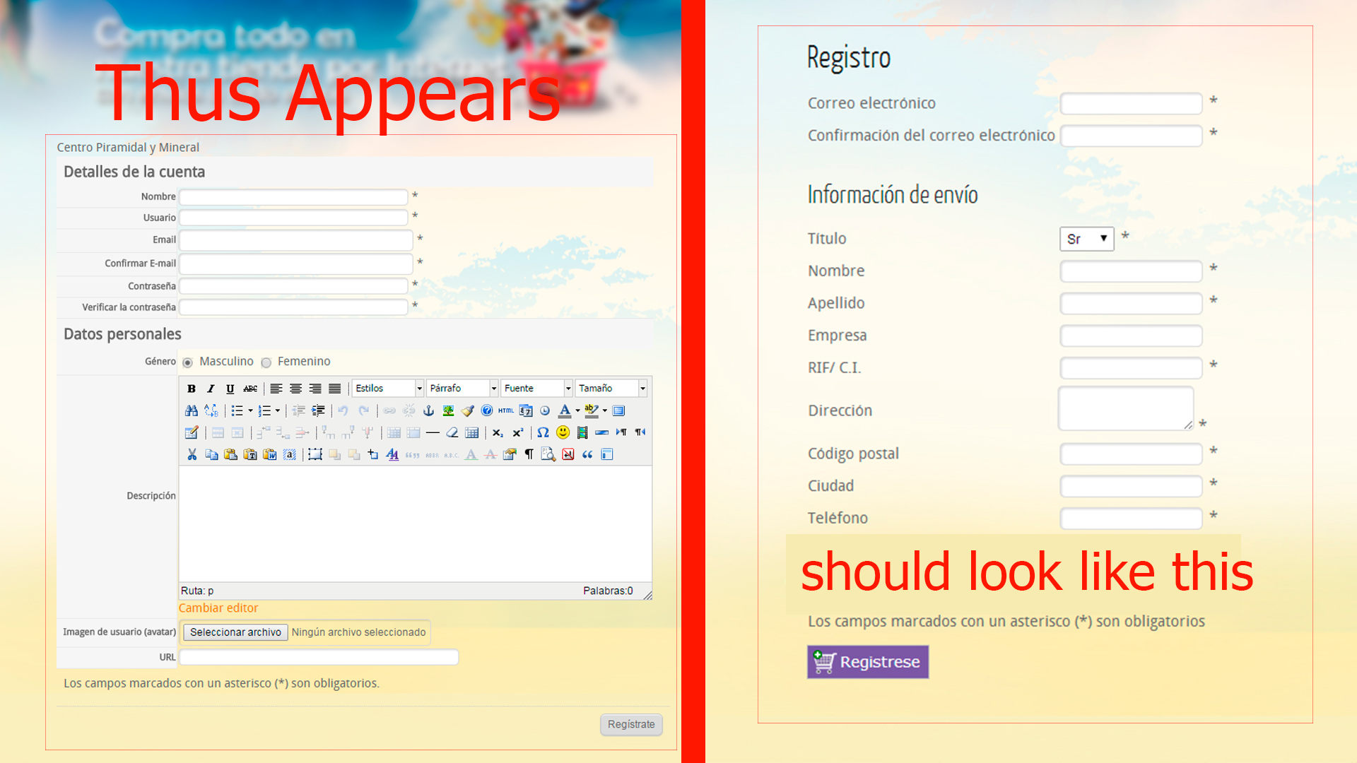

  • Posts: 13
11 years 7 months ago #178022
Now update the system again and is well on the checkout, I no longer have the loop, but for user registration, it appears to me, default template of joomla and not to HikaShop, and reCapchat not appear, not allowing me to registration . :S

  • Posts: 13
11 years 7 months ago #178406
Does not look like should the form and calls for a ReCaptcha who is disabled and who do not use this form for registration
Attached photo of the look and how it should be seen

  • Posts: 26355
  • Thank you received: 4068
11 years 7 months ago #178407
@southpaw3229
Depending your Joomla configuration, the user creation might require a email validation.
At this moment it's not possible to login the user because it has not been activated.
HikaShop read the Joomla configuration in order to know if he can (or not) login the user otherwise it will try to login ; but it is possible that the login made by HikaShop fails (but I don't know what could be the reasons exactly ; I just know that we call the Joomla login function so we can't be sure with the rest of plugins, etc).
@nuevaera
The system plugin "hikashop registration" which redirect the Joomla registration page to the HikaShop one got some errors that should be all fixed now.
We updated the package so you can re-download HikaShop 2.3.4 to get the modifications.
