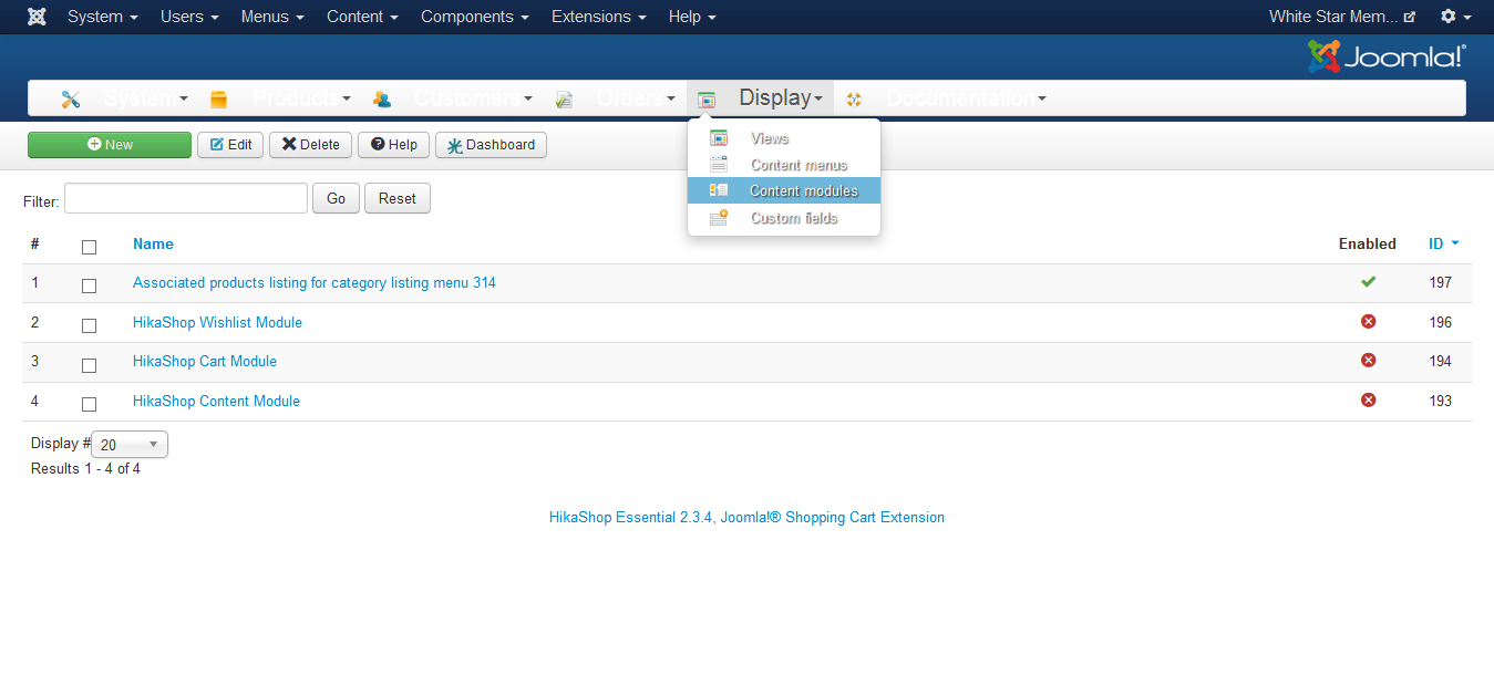

  • Posts: 5
11 years 10 months ago #178140
Thank you Nicolas.
However, no matter what I do - I cannot get the front end to appear.
Clearly I am doing something wrong - but all I want is to make Hika Shop appear like it does on the webinar video you appeared in.
How do I do this if my wizard doesn't work? For your information, in 'Display' :-
1) The content menus page is empty
2) The content modules has 4 modules - wishlist, cart, content and associated products listing for category listing menu 314.
That's it.
There is not even a menu item/button for the front end!
Also, my display looks like the attached - is this right as I can't read the menu bar unless a word is highlighted by the cursor?
I cannot believe getting the front end to appear should be this difficult! I accept that I must be doing something wrong - but what?
Many, many thanks for your help,
Rupert.

  • Posts: 5
11 years 10 months ago #178276
Hiya Nicolas,
Thanks for the comprehensive answer, it's appreciated. I will do as you say and do it manually. I think I will learn more that way too!
Lastly, is the image that I attached of the almost invisible text on the menu bar correct - or is that a glitch?
Anyway, many thanks again.
All the best,
Rupert.
11 years 10 months ago #178281
The menu bar is not really a glitch ; the best is to change his position.
See the option "menu position" in the HikaShop configuration. In Joomla 3 the best is to use "above the main area".
www.hikashop.com/support/support/documen...html#display_general
