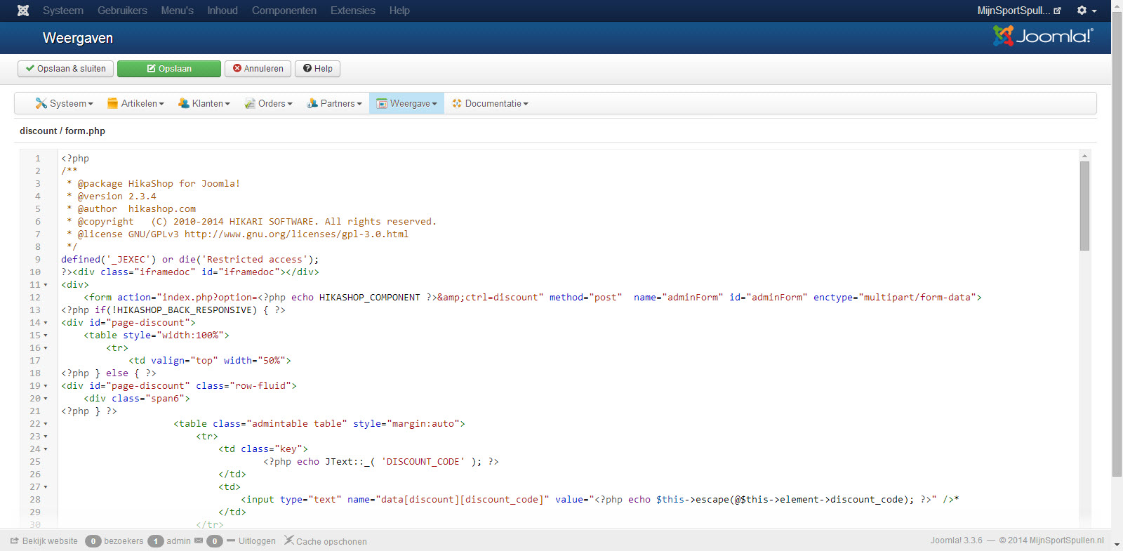

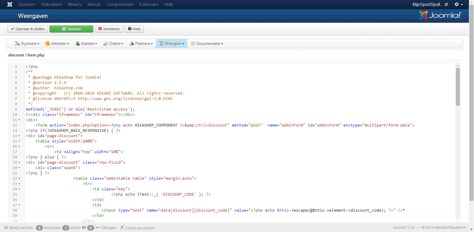

11 years 10 months ago #178470
Unfortunatally there is no such code there.
See attachments.
Jan
11 years 10 months ago #178482
There is such code there.
Please use the search function in your text editor ;)
