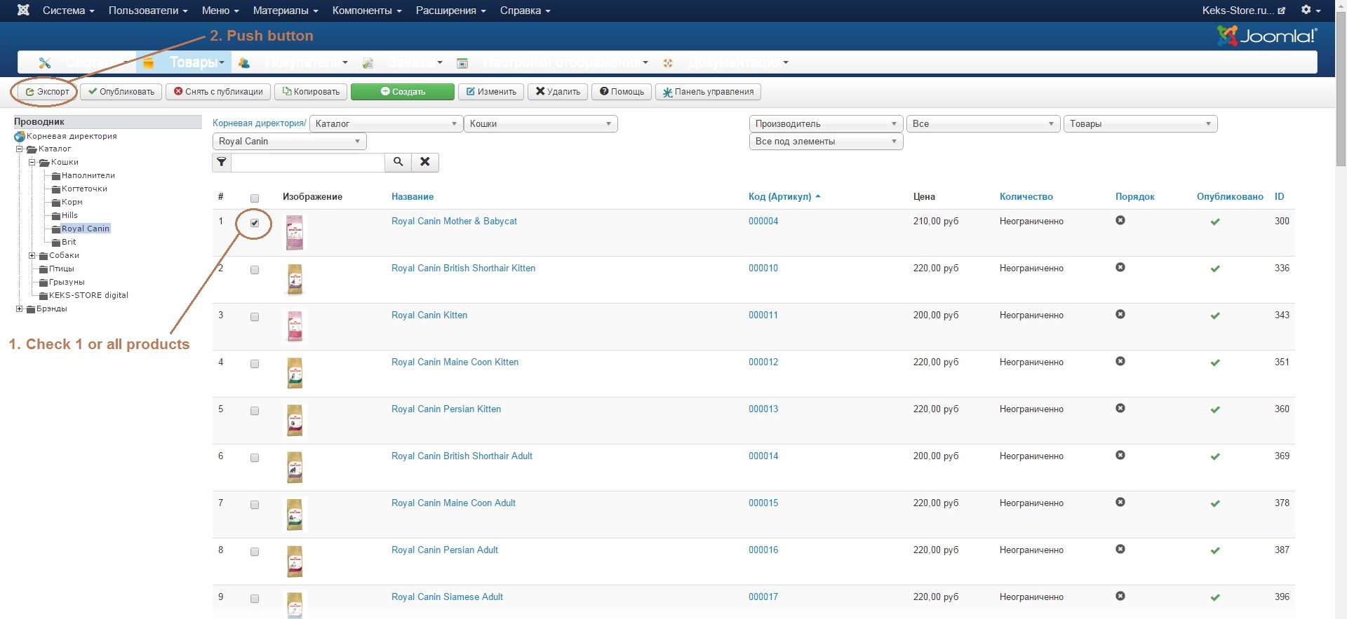

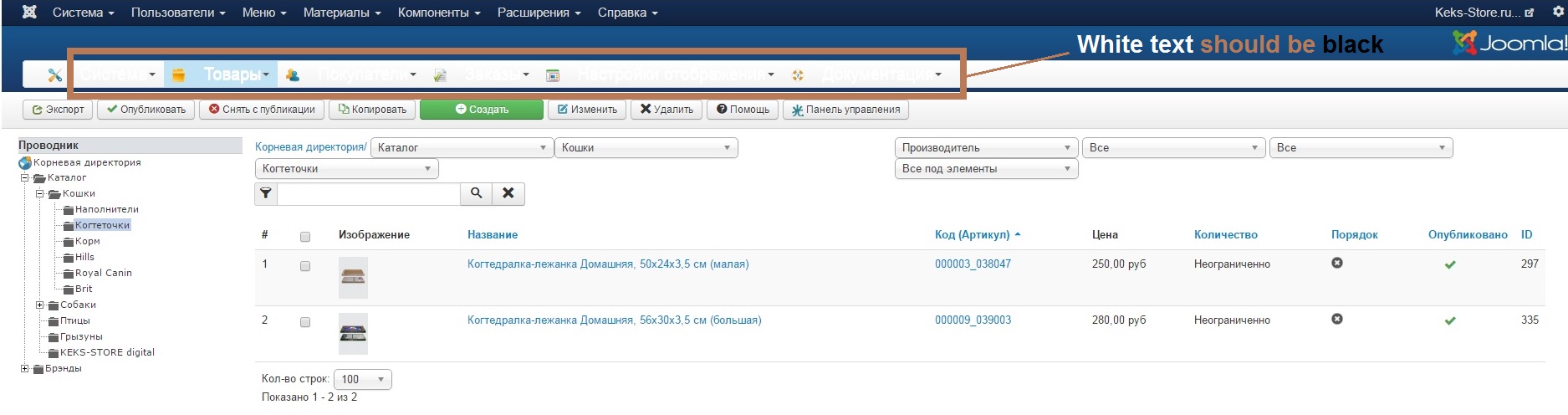

After update i have several problems with HikaShop back-end.

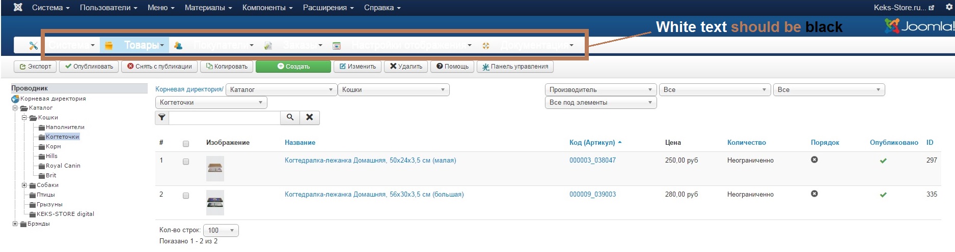

1. Top menu item became white, and were black (image 1.jpg)

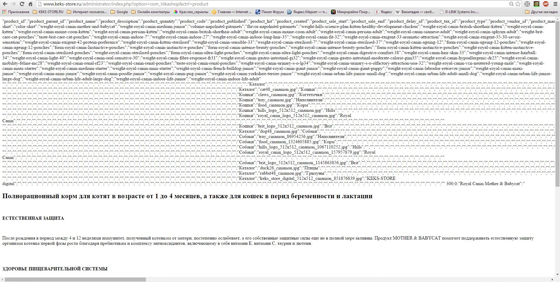

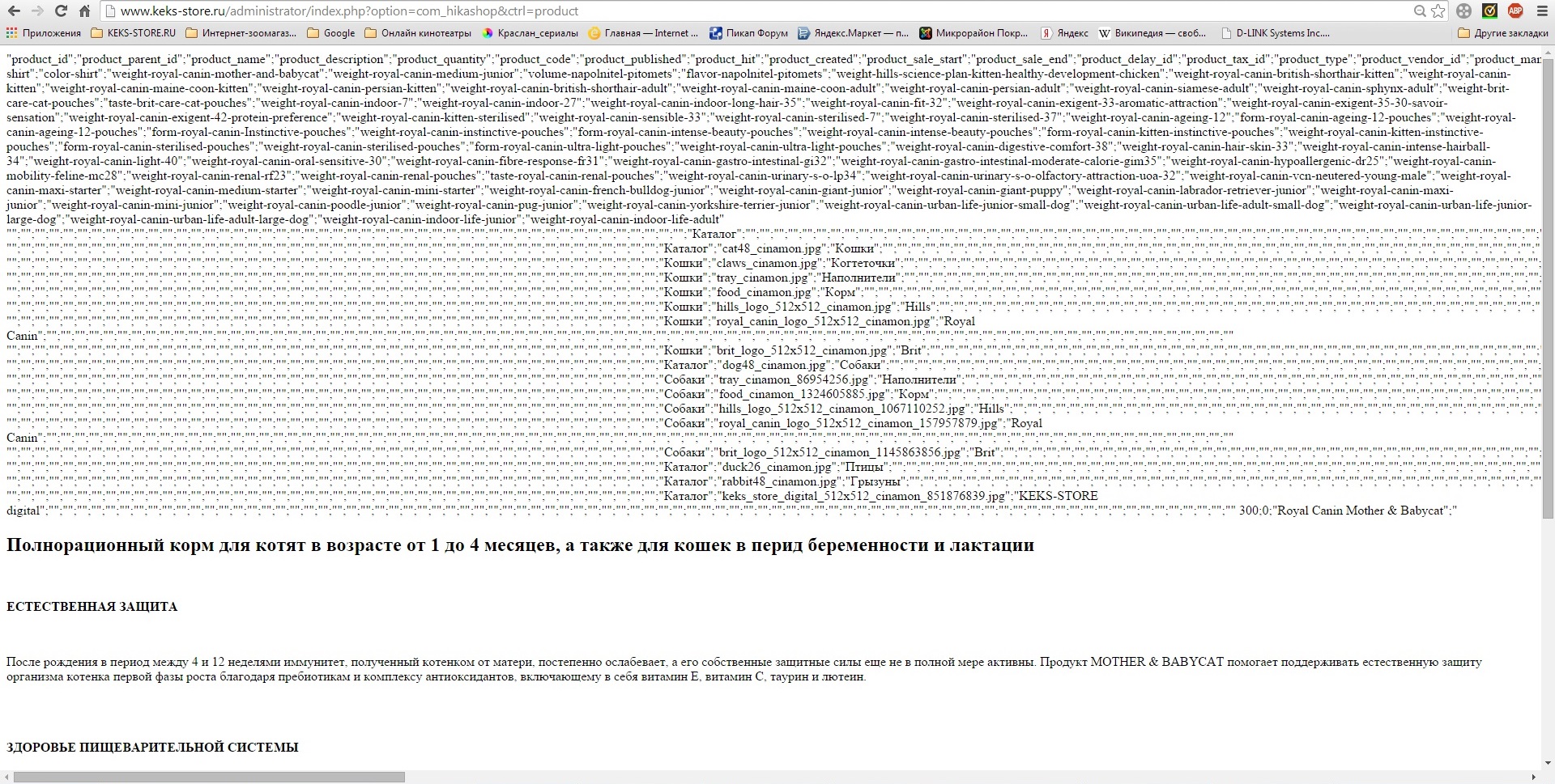

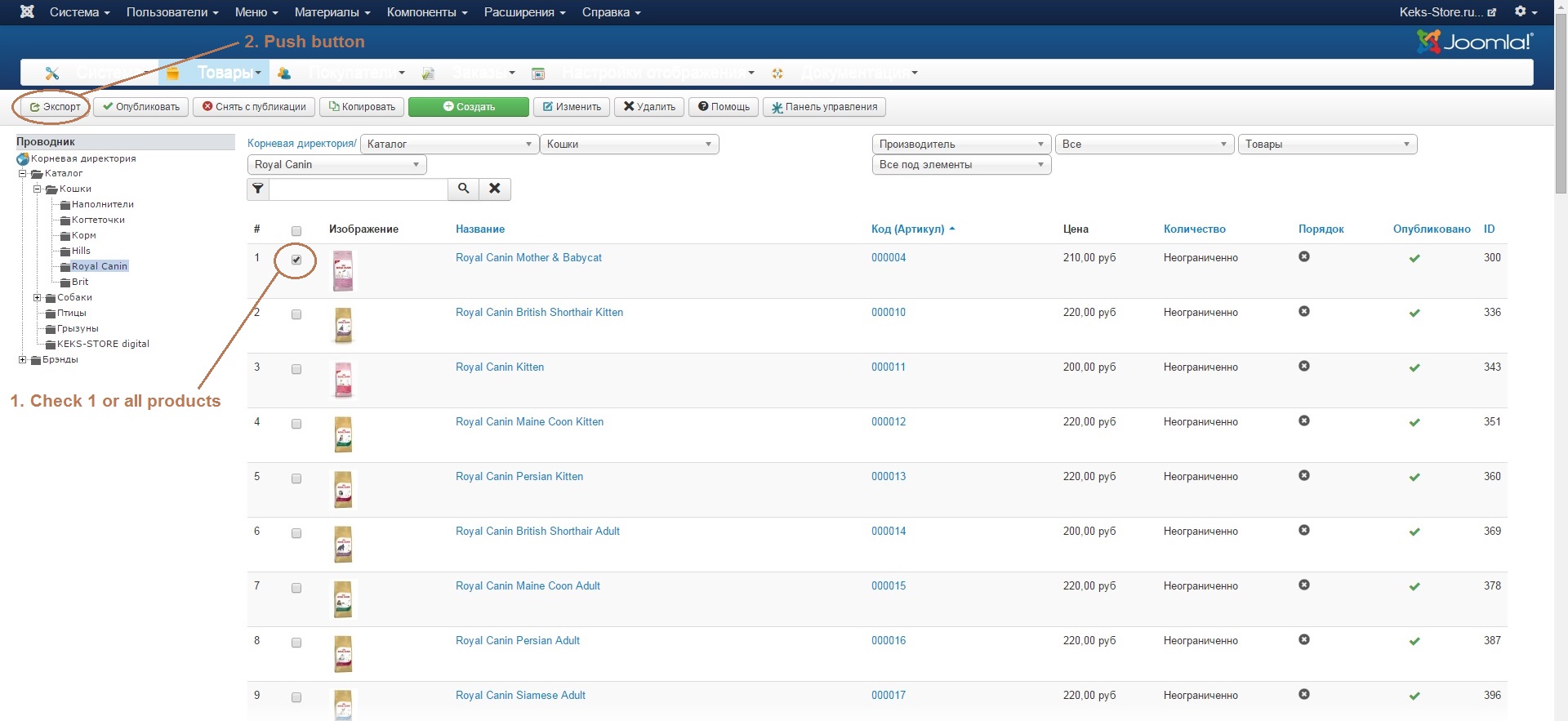

2. I want to export to csv file and do the following steps (as is usually the case).
3. And get in the same window.

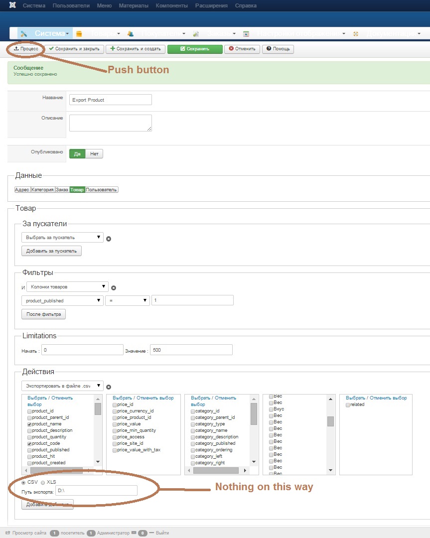

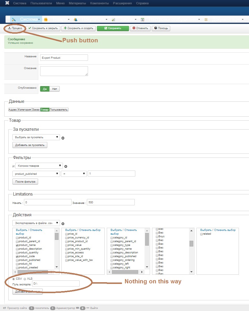

4. Mass action is not working. I created an example, but when I run the process csv file is not created.
Please, help me solve this problems?
11 years 10 months ago #178339
1. Please display our menu "above the main area".
www.hikashop.com/support/support/documen...html#display_general (menu position)
2-3. Do you have a system plugin which could alter the headers ?
The Spreadsheet helper in HikaShop set the headers so the generated CSV is see as a downloadable file and not as a webpage.
(you can see the function "send" in the Spreadsheet helper).
4. When you specify a filename in a mass action, you should specific the full filename ; not just a path (folder).
So please use instead " D:\my_export_file.csv "

1. OK, it works!

11 years 10 months ago #178446
2-3: There was maybe an error when updating, please try to re-install HikaShop over the current installation.
4: You have to set a valid path on your server, not on your computer. If you want to download it directly, you can let this field empty.
