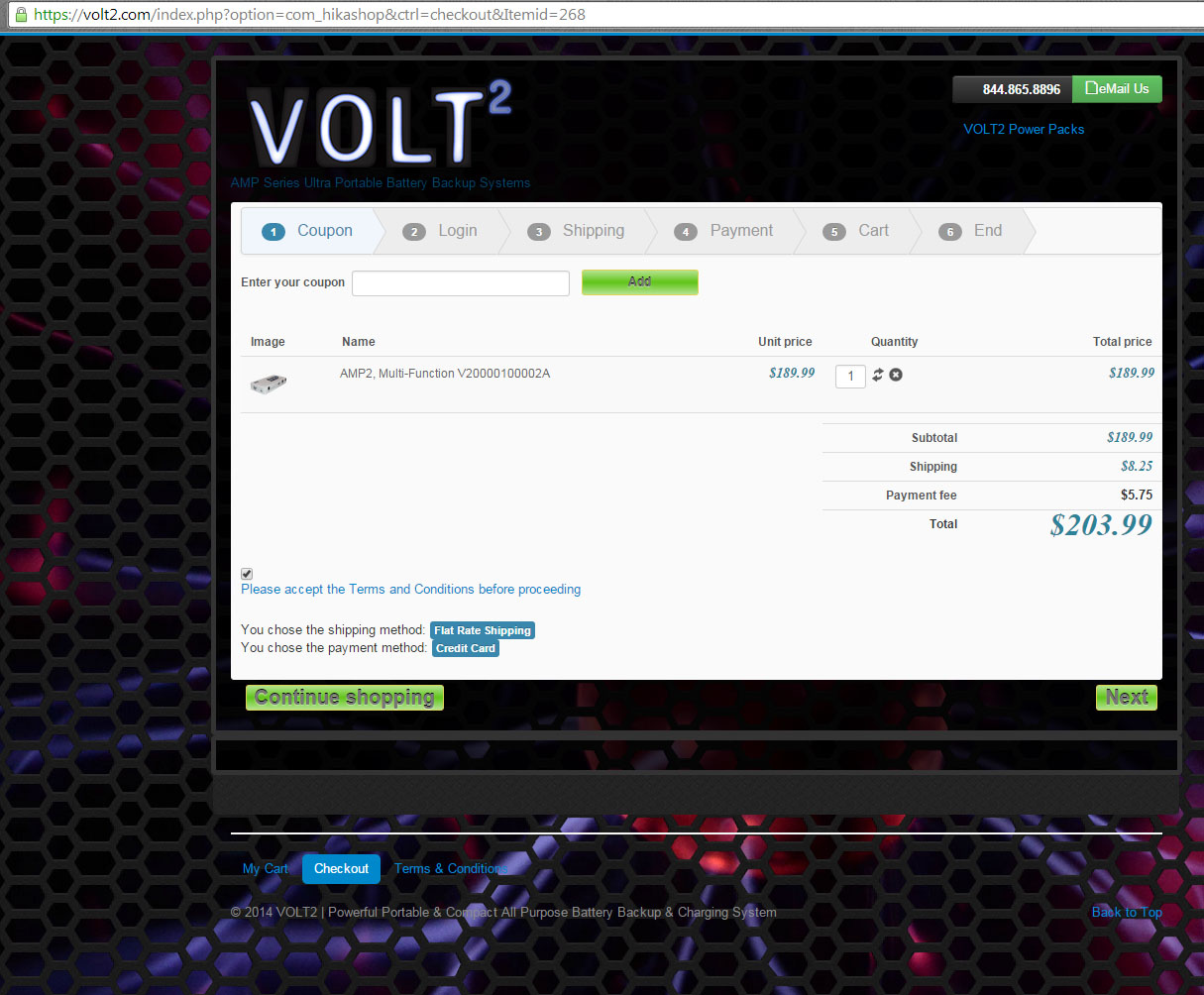

Carts fail when when selecting next on first steps, usually kicks back to index page, sometimes just refreshes the current view. seeing this across all my carts. I've got 4 and all the sudden none of them are working, this has been the status for a couple weeks and I need to get this figured FAST

It appears possible to process through the cart by clicking the "progress bar" links after I disable "auto submit of shipping & payment options". I can get all the way to the cc form. If attempting to use the "next" & "finish" buttons the cart just kicks the browser back to the index page, with and without SEF
