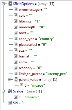

There is an error "field "0" not secured" when trying to save custom field with "Display limited to" set to custom field of type with multiple choices.
How to reproduce:
- Create product custom field with field type Checkbox or Multiple Dropdown
- Create second product custom field, save it and then set "Display limited to" to custom field from step 1, set at least 1 value and save it.
Problem is in the file administrator\components\com_hikashop\classes\field.php on line 1019.
For field types Checkbox and Multiple Dropdown $value is indexed array, therefore $id is 0 and call to
hikashop_secureField() with integer argument results in die().

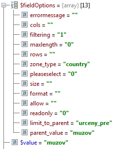

Here is var_dump($fieldOptions) for field type dropdown
and var_dump($fieldOptions, $value) for field type Checkbox.
11 years 9 months ago #179646
Thanks for the report.
For the moment I fixed the value thanks to
$fieldOptions = JRequest::getVar('field_options', array(), '', 'array');
foreach($fieldOptions as $column => $value) {
	if(is_array($value)) {
		foreach($value as $id => $val) {
			if($column != 'parent_value')
				hikashop_secureField($id);
			$fieldOptions[$column][$id] = strip_tags($val);
I'll talk with Nicolas in order to get his opinion.
