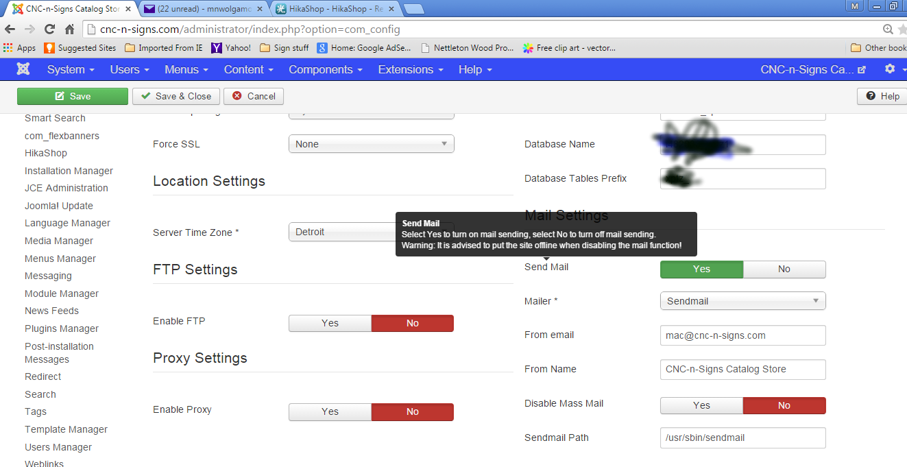

11 years 4 months ago #200295
If the Joomla registration is turn off will that cause the Hikashop registration problems?
I did see where mass mail can be turn off in Joomla would that help? Under Global configuration>server>Mail settings>Disable Mass Mail>toggle Yes or No
I will also study the Joomla documents, they will not tell m
e how Joomla interacts with Hikashop.
  • Posts: 86105
  • Thank you received: 14206
11 years 4 months ago #200336
1. If you turn off the registration of users in Joomla, HikaShop will follow that setting and the registration will be disabled in HikaShop too. Which is why I recommended, instead of that, to activate the Redirect Joomla registration to HikaShop plugin via the Joomla plugins manager.
2. If you turn off the email sending in Joomla, no email will be sent at all from your website. While that's a possibility, I don't recommend it as you won't get payment notifications, nor order notifications.
