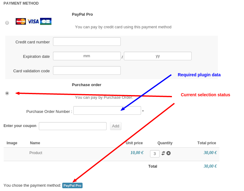

  • Posts: 45
11 years 7 months ago #188157
Dear Jerome,
Your account has been enabled now. Sorry for the inconvenience.
A screenshot showing the plugin data is attached.
Thanks and regards, Paul

  • Posts: 45
11 years 7 months ago #188792
Dear Nicolas,
Thanks you for your reply.
I think I understand your concern that lead to the decision of disabling the auto submit. However, the current behavior is not particularly user friendly.
I play the following story:
  1. I select my product, which brings me to the checkout page.
  2. I log in or register myself
  3. I select Purchase order as payment method. Now, the radio button in front of Purchase order is selected, and the field for the Purchase Order Number appears. Note, that the status at the bottom still shows PayPalPro as payment method.
  4. I enter a Purchase Order Number and press the Finish button. I end up at the same screen (step-1), and the purchase order number is erased. However, the status at the bottom reports now that the payment method is now set to Purchase order.
  5. re-entering the Purchase Order Number allows me to finish the checkout
Is this the expected behavior? What can I do to optimize this story?

  • Posts: 86104
  • Thank you received: 14203
11 years 7 months ago #188805
It's not the expected behavior.
The purchase order field should not be erased. That's a problem of the purchase order plugin which I didn't saw when putting it together as the checkout workflow I used (in several steps) wasn't displaying again the payment methods form a second time.
It can easily be fixed by changing the line:
$method->custom_html='<span style="margin-left:10%">'.JText::_('PURCHASE_ORDER_NUMBER').'<input type="text" class="hikashop_purchase_order_number inputbox required" name="hikashop_purchase_order_number"/> *</span>';
to:
$method->custom_html='<span style="margin-left:10%">'.JText::_('PURCHASE_ORDER_NUMBER').'<input type="text" class="hikashop_purchase_order_number inputbox required" name="hikashop_purchase_order_number" value="'.@$_SESSION['hikashop_purchase_order_number'].'"/> *</span>';
in the file plugins/hikashoppayment/purchaseorder/purchaseorder.php (modification that will be in next version of HikaShop)
But as you can see, it's not a problem for the credit card payment method for which you don't have to enter the credit card twice.
