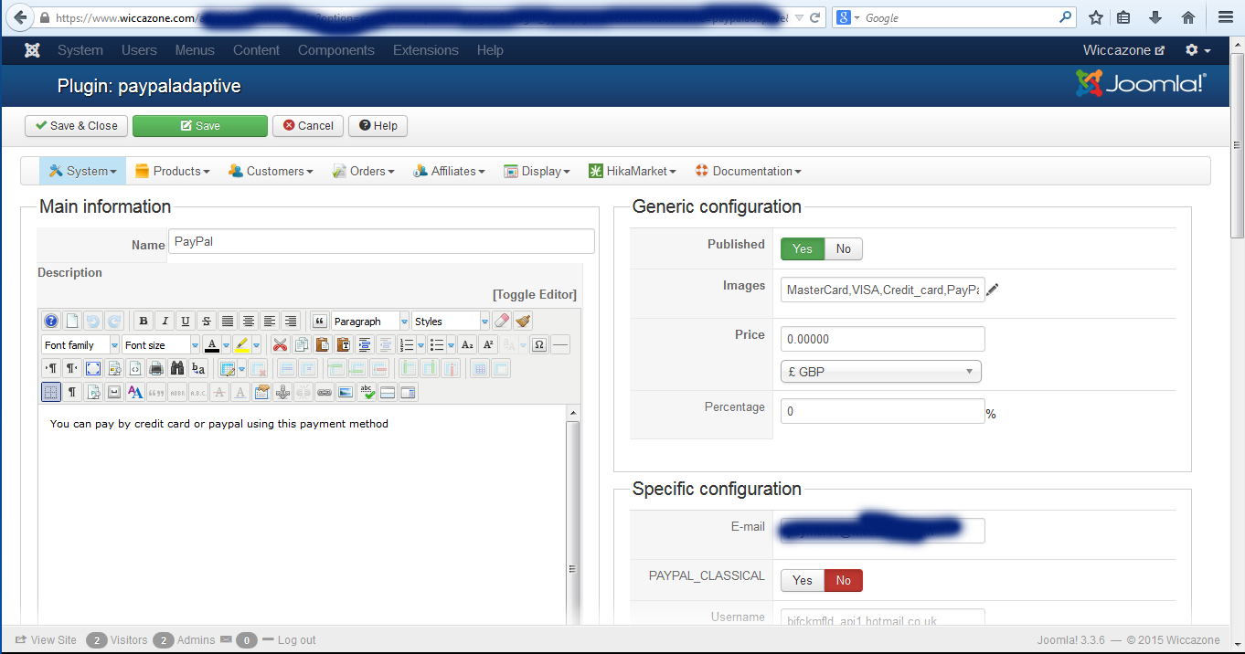

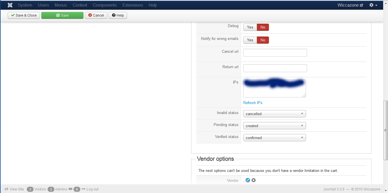

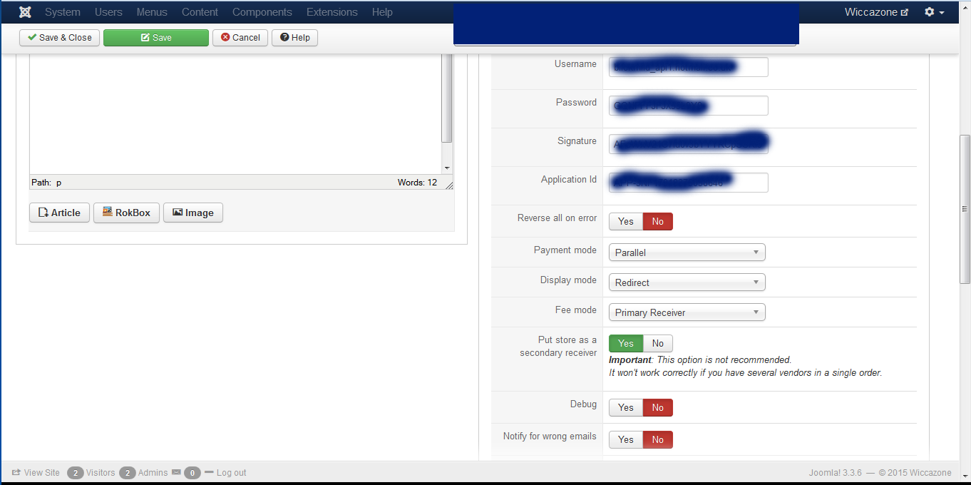

I am using paypal adaptive and have attached some screen shots.
in the screenshot - the payment mode is set to parallel, but I have also tried the mode as chained - and still get the same problem
Thanks for any help in advance.

11 years 7 months ago #188816
Why did you activate the setting "put store as secondary receiver" ?
  • Posts: 24
11 years 7 months ago #188839
My reason for this is because paypal say I need to be the secondary receiver because if a customer makes a purchase from more than one vendor in the same transaction and I am the main receiver, if they request a refund, as main receiver, all vendors will have to refund regardless of only needing to refund from one vendor.
Thanks for your quick response
Last edit: 11 years 7 months ago by steflosco36.
11 years 7 months ago #188842
Regarding the error, it looks like you making an order without any vendor.
But if the store must be the secondary receiver without any primary receiver, the plugin can't work ; it becomes in contradiction with his configuration.
Am I right ?
  • Posts: 24
11 years 7 months ago #188851
Hi Jerome - thanks for your reply.
In honesty, I am unsure who is right, all I was saying is that paypal said I needed to be the secondary seller. However, if this option is not suitable to use, is there any point in having it as an option?
I have fixed the problem now and all seems to be working again - but thanks for your time anyway.
Stef
11 years 7 months ago #188908
We added this option because it was added by some users but I am still not fan of it.
That's why I put a warning message when the option is selected.
