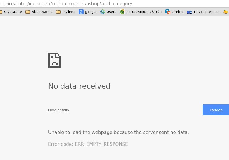

-- Joomla version -- : 2.5.25
-- Browser(s) name and version -- : chrome 40.0.2214.94
-- Error-message(debug-mod must be tuned on) -- : Unable to load the webpage because the server sent no data. Error code: ERR_EMPTY_RESPONSE
I just installed hikashop locally,
I am at the control panel of hikashop, however whatever link I click on, for example "categories"I get a page with the error no data received "Unable to load the webpage because the server sent no data. Error code: ERR_EMPTY_RESPONSE"
Please, help, thank you

  • Posts: 2
11 years 5 months ago #194835
@Manton,
Did you manage to fix the error? I have the same issue and it's driving me crazy!
@Xavier,
I have the same issue as Manton and I tried you suggestion to him but it didn't work for me.
This error appears ONLY when I want to access the following sections: Products, Categories, Users and Orders. All other sections in Hikashop work perfectly. Me thinks it's either a bug in hikashop or my web server.

  • Posts: 5
10 years 11 months ago #215381
thedarkwarrior wrote: I have the same issue as Manton and I tried you suggestion to him but it didn't work for me.
I have the same problem as above, Products, Categories, Users and Orders give an err_empty_response error page.
We are using version 2.5, we have used it for some time on another server.
After migration this was the only thing not working. So it is server based.
I have deleted the old installation, dropped the database, and reinstalled from zero, only to find, that at the end of installation, the wizard also gave an err_empty_response page.
I need help, what should I change on my server to get HikaShop running?
