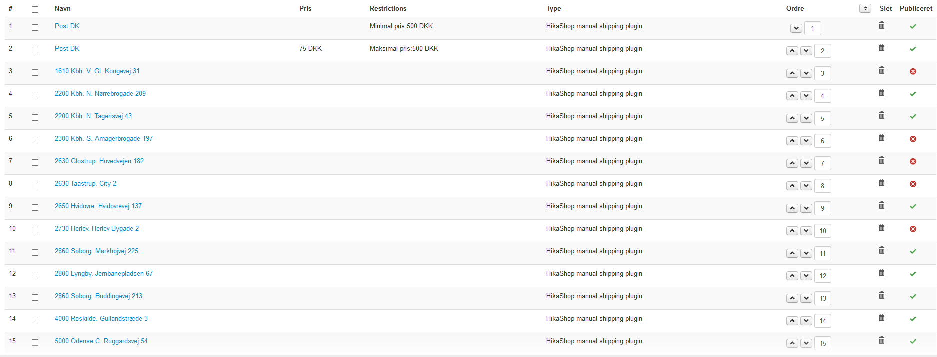

Can you provide a screenshot of your shipping methods listing so that we can see how you configured their ordering ?
  • Posts: 171
  • Thank you received: 4

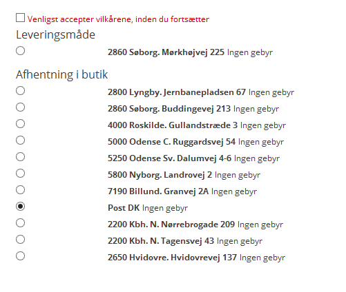

11 years 5 months ago #197319
Here is screenshots of both frontend and backend

11 years 5 months ago #197373
We did a test on our end but the shipping methods are in the proper order.
Could you provide a backend access of a copy of the website with the latest version via our contact form so that we could check your settings and look at the problem ?
