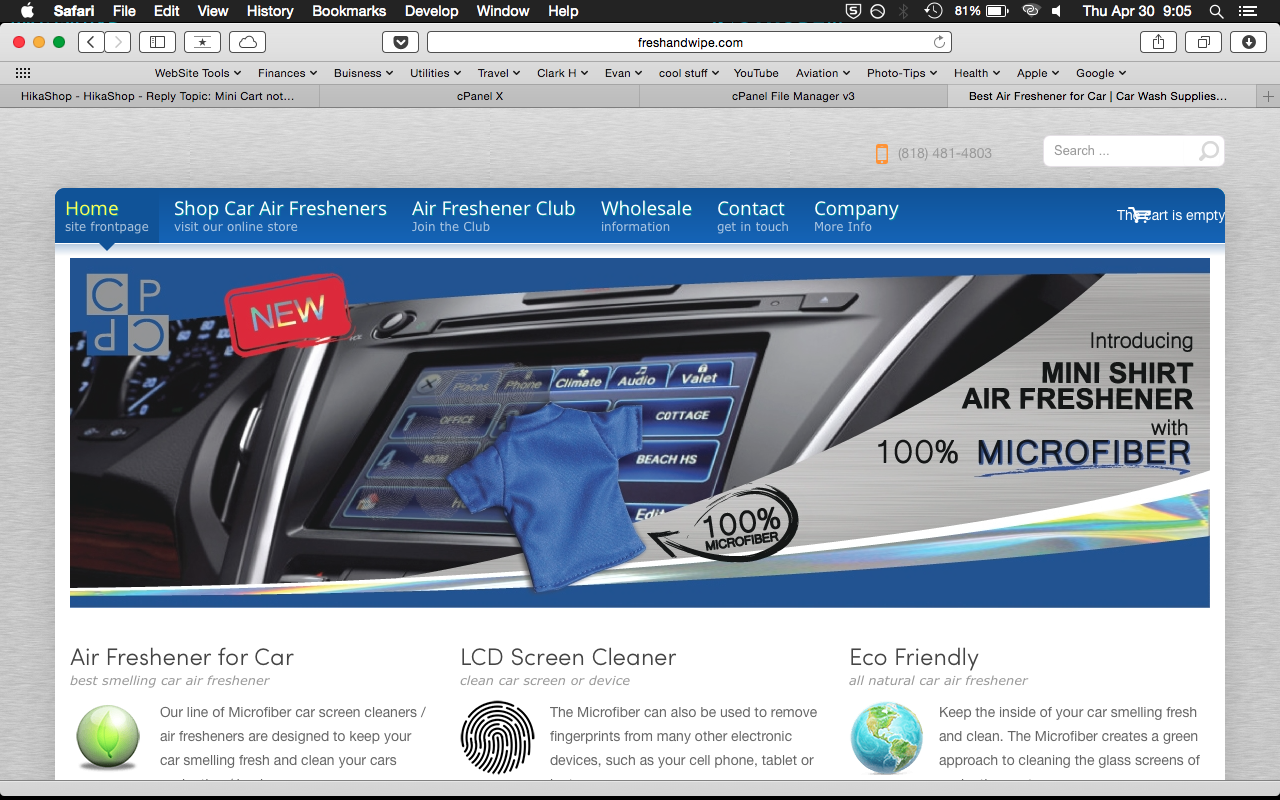

My Mini Cart Module stopped linking to the checkout page. When I click on it now it just links to
www.freshandwipe.com/#
How can I get the Mini Cart to show the products again or link to the checkout page?

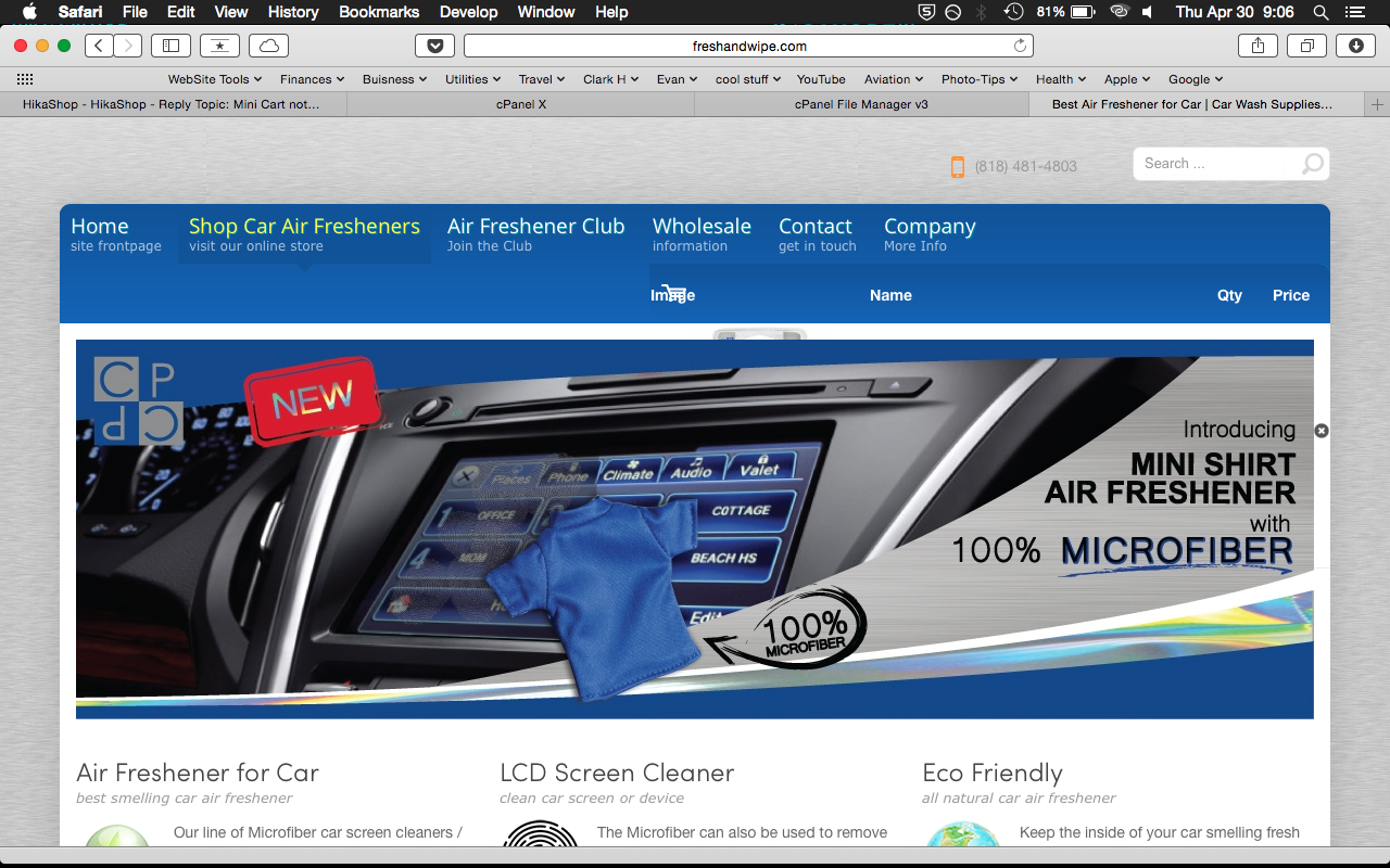

I tried to rename the file as you stated but that re-aranged my Menu Items for my website here is an image.
Thank You

If there was no customization to the cart module, you should not have the file templates/YOUR_TEMPLATE/html/com_hikashop/product/cart.php at all on your website.

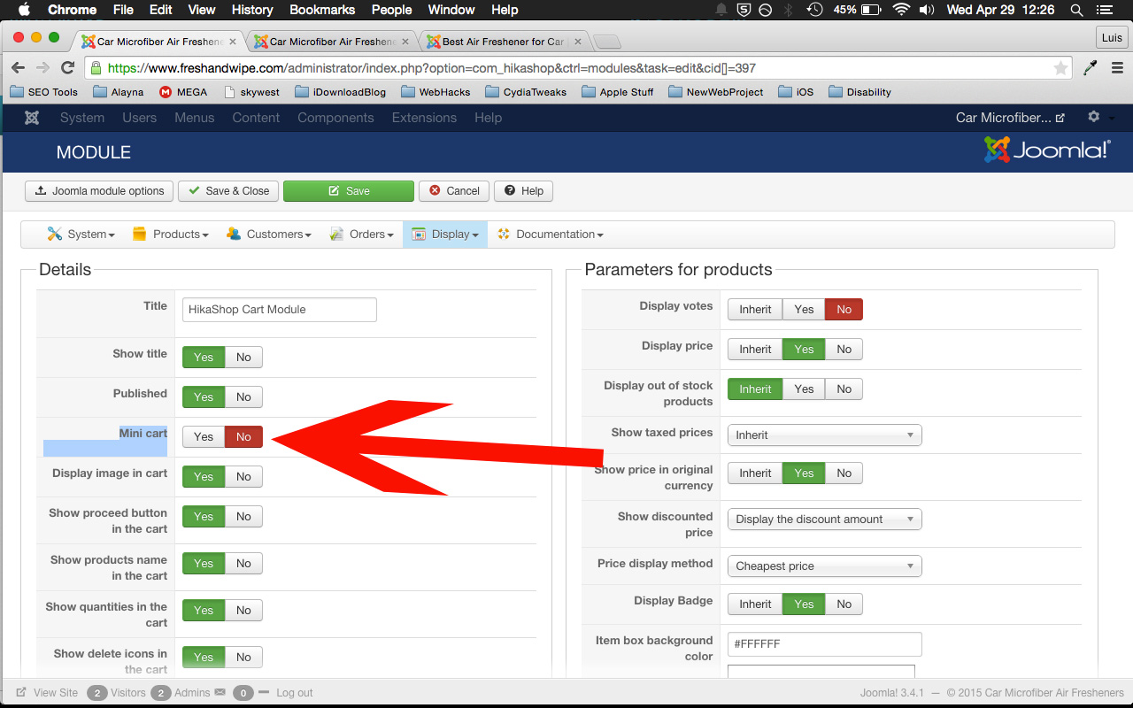

Renaming that file means that the cart module uses the normal display again. And since you have the "mini cart" option turned off in the cart module options, it's normal that you see the full cart there.
This even indicates that your cart module view had been heavily customized as it is not taking into account that setting of the module.
So turn on the "mini cart" option of the cart module and it will look a bit better and the link to the checkout will work.
Now the display will probably be different from what you had since by renaming that file, you basically remove all the customization done to the cart module.
