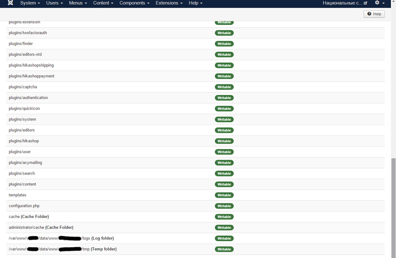

  • Posts: 4
10 years 11 months ago #215407
Hi, I have the same problem on J3.4.4 and hikashop_starter_v2.6.0 (Can't open file /tmp/dataexample/script.sql).
The permissions are ok (all green).
After the error page, in the tmp folder there is a file dataexample.zip, but it's empty (0 kb).

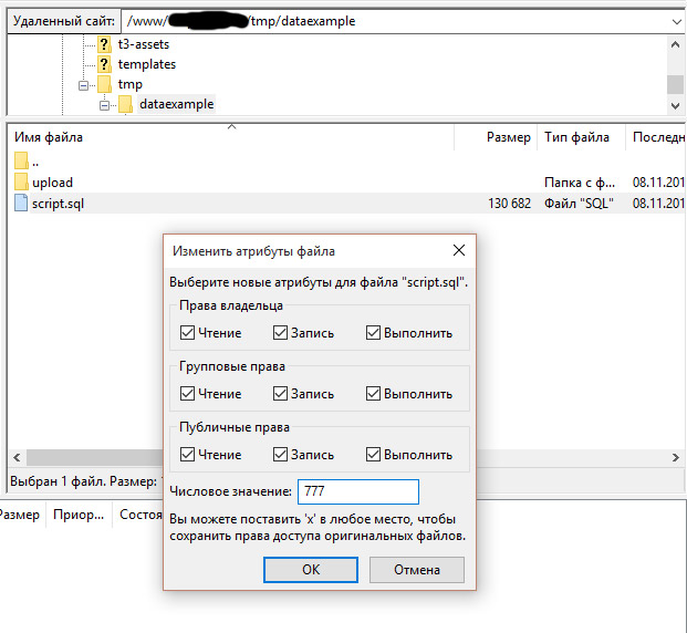

  • Posts: 178
  • Thank you received: 5
10 years 10 months ago #219893
Chang File Permissions of Dataexample folder to 777 and it works.
But there is no category or product images now, only one barcode image.
  • Posts: 86104
  • Thank you received: 14203
10 years 10 months ago #219915
You probably have a similar issue with the folder /images/com_hikashop/upload/ where the images are supposed to be stored in.
You can manually copy them from the dataexample/upload folder to there.
