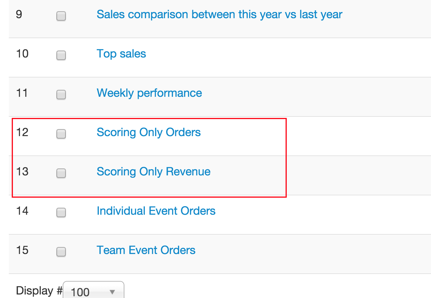

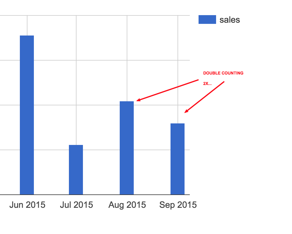

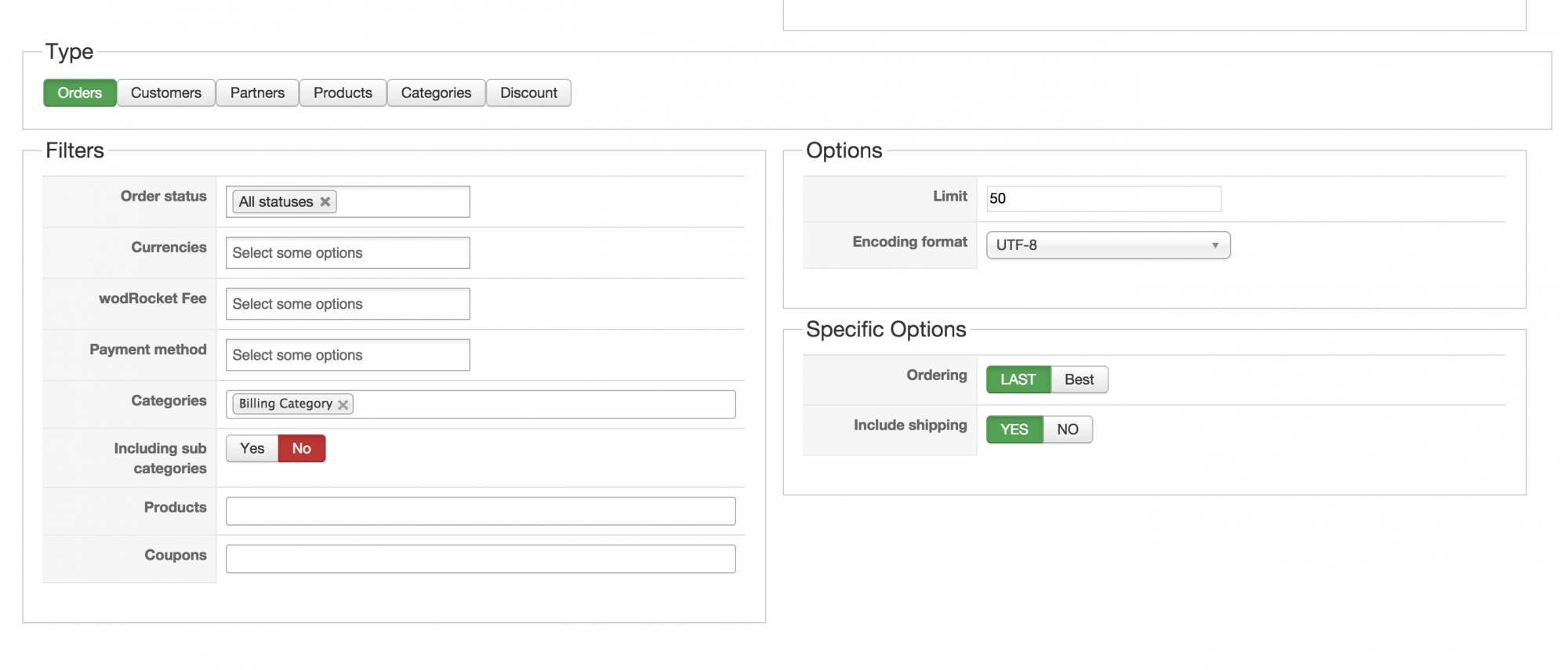

We have a report to track the orders for a type of revenue we receive "scoring only" revenue and have a bug where the report is now double counting the orders as seen in the screenshots below of settings.
Do you know what might be causing this?

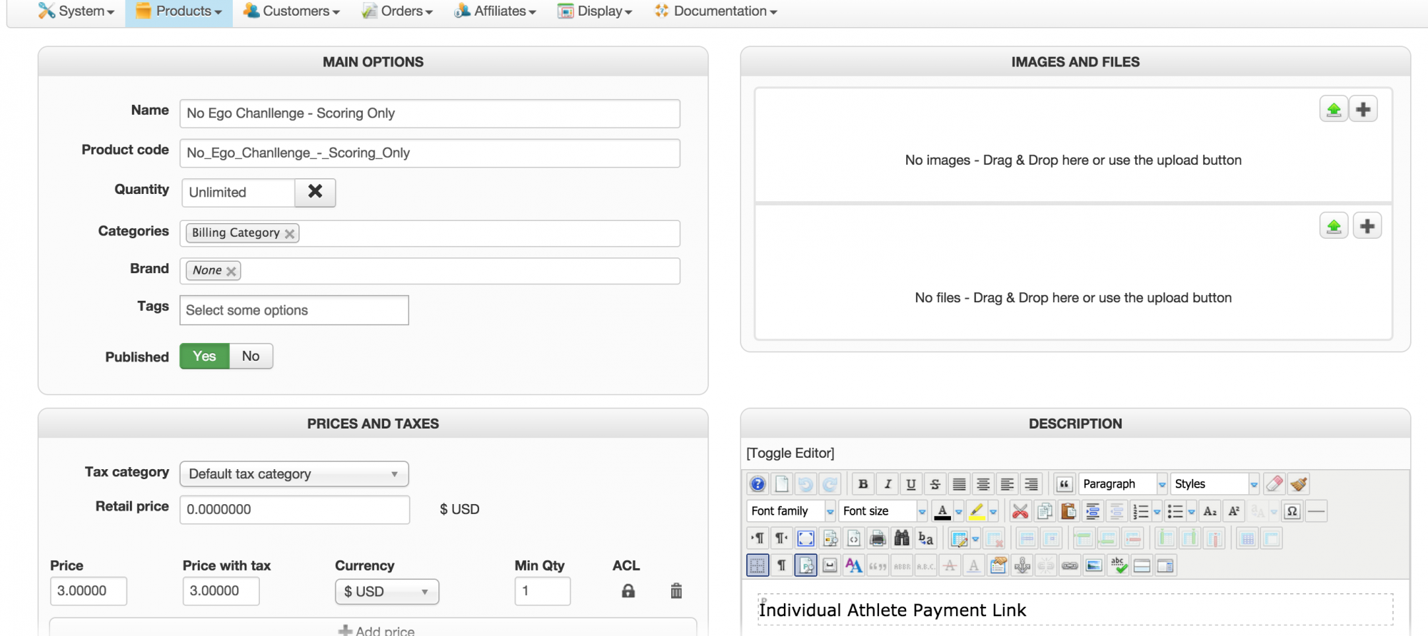

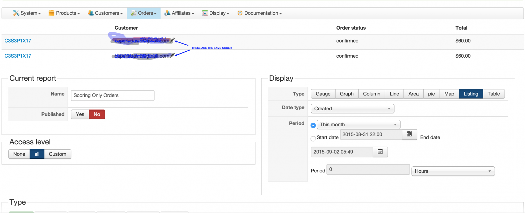

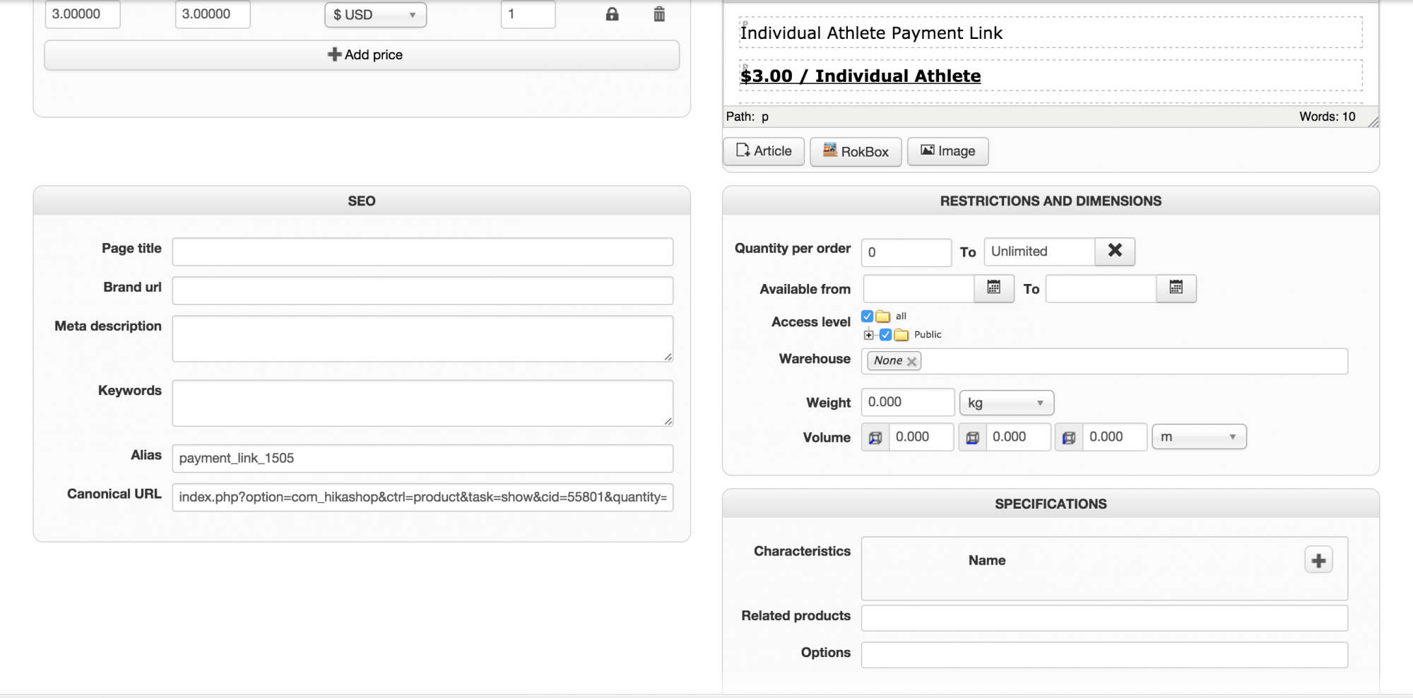

Does that order contains several products ? Or maybe it is a variant product ?
Knowing more about the order and his content will help us to understand the issue.

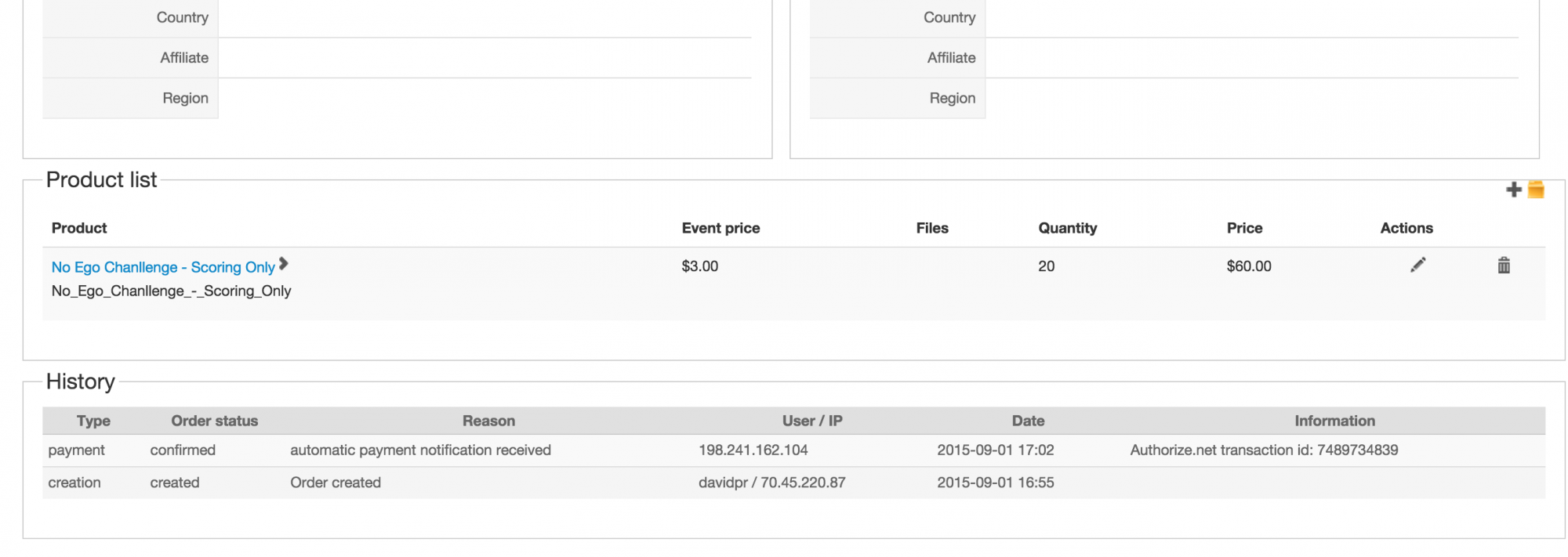

  • Posts: 241
  • Thank you received: 5
10 years 9 months ago #213258
No the order only contained one product/variant.
I have included screenshots of the order and the product below.

I am sorry but I am confused. If you tested it on your end, the only difference would be the browsers.
We have tried various computers and cleared cache and the 2x counting continues.
To see the duplicates:
1. please login to our back end
2. go hikashop > orders > reports > "Scoring Only Orders"
There you will see the double entries for each order. Please confirm it is really working on your end.

Ok. 1/2 way there. I replaced the code and everything looks good for "scoring only orders" but in "scoring only revenue" the bar graph (screenshot below) is still 2x counting. It is now 2x the corrected (due to the new code) the "scoring only orders" when exported to spreadsheet and summed.

The report we run has "Filters" "Categories" = "Billing Category" but for some unknown reason a bug happens where (for this month only) it is capturing a single product who has no product, variant, or option related to "Billing Category"
