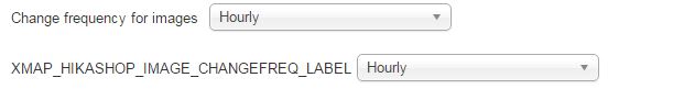

I've tried to use the new plugin, but things only get worse. Instead of a image sitemap with no images in it I now end up with a blank browser screen for the image sitemap.
Befor I made any changes to OSMap and the HikaShop plugin frequency for the sitemap was set to weekly and the frequency for the HikaShop image sitemap plugin was left on de thefault setting "Use parent menu settings".
After installing your new version of the plugin I ended up with two fields for image frequency. See image.
I set the frequency for the sitemap to hourly and afterwards I also set the image frequency in both fields to hourly.

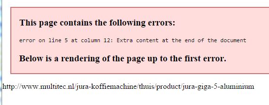

That was exactly the problem. At first the image sitemap was working, but dit not contain images. After installing the latest plugin version I ended up with a blank browser screen.
This morning I completely removed everything about OSMap and Xmap for Hikashop. Installed OSMap again and installed the latest V2 Xmap for HikaShop plugin.
Instead of a blank screen, the Xmap HikaShop plugin is now giving an error:
Note: I'm using Rokbooster. When Rokbooster is disabled the error is on line 7
Any suggestions?
Last edit: 10 years 11 months ago by jvstratum. Reason: Additional info
  • Posts: 26384
  • Thank you received: 4077
10 years 11 months ago #214408
Your browser display your that message.
You must see the source of the page in order to get the XML content ; there you will be able to see what is the problem on line 5, column 12.
I perform a test using mapX (which is globally the same as OSMap, using the same base) and the hikashop xmap2 plugin ; it was working fine.
Looks like that the "images" sitemap is just a sitemap but which should list pages which contain images.

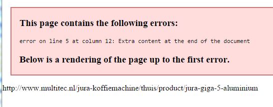

  • Posts: 54
10 years 11 months ago #214470
OK, I looked at it, but I still don't have any clue what is causing the problem or how to solve it.
  • Posts: 26384
10 years 11 months ago #214500
You can share that information with us ; otherwise I'm afraid that I won't be able to have any hint for you.
