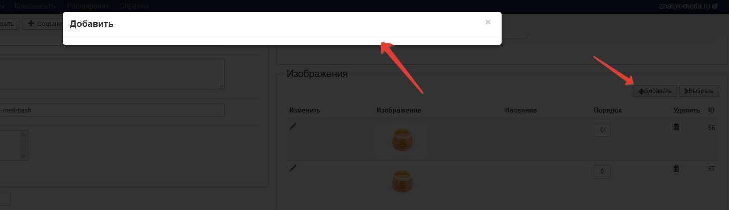

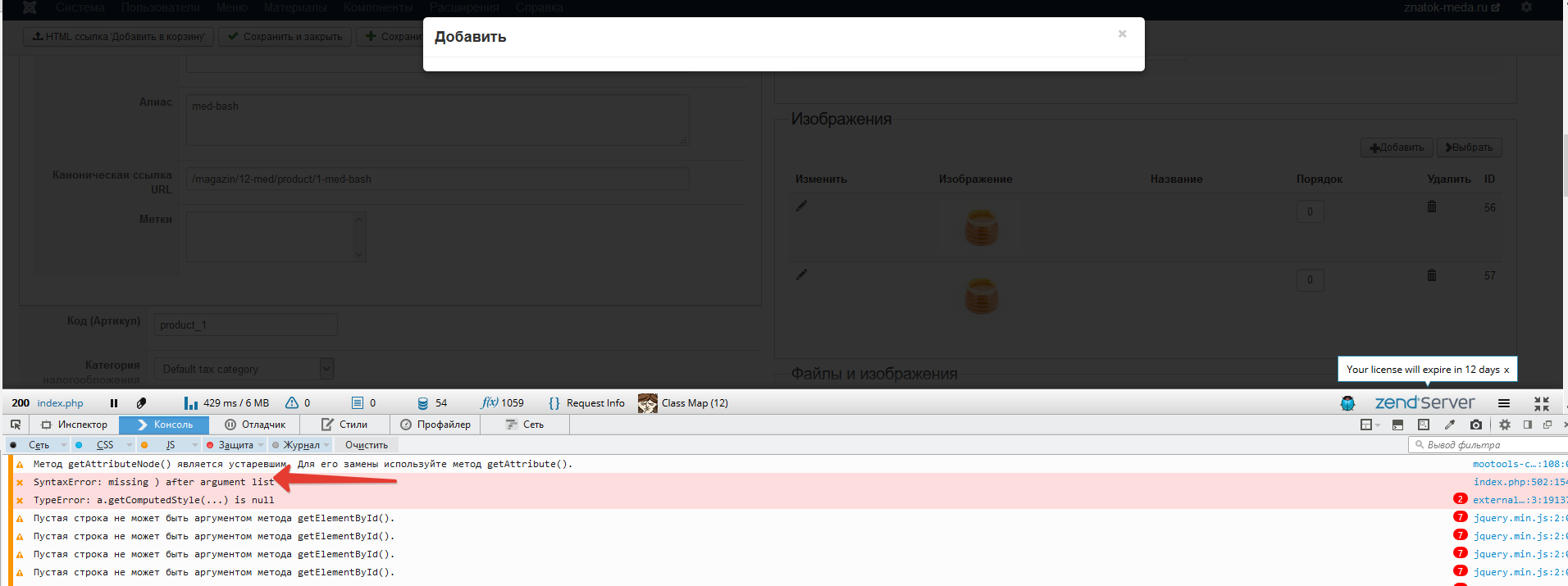

If I upgrading from 3.4.3 Joomla to 3.4.4 I have a bug in the "IMAGES AND FILES".
I can't delete images
the problem with iframe.php file
If I restore it from backup - it is ok.

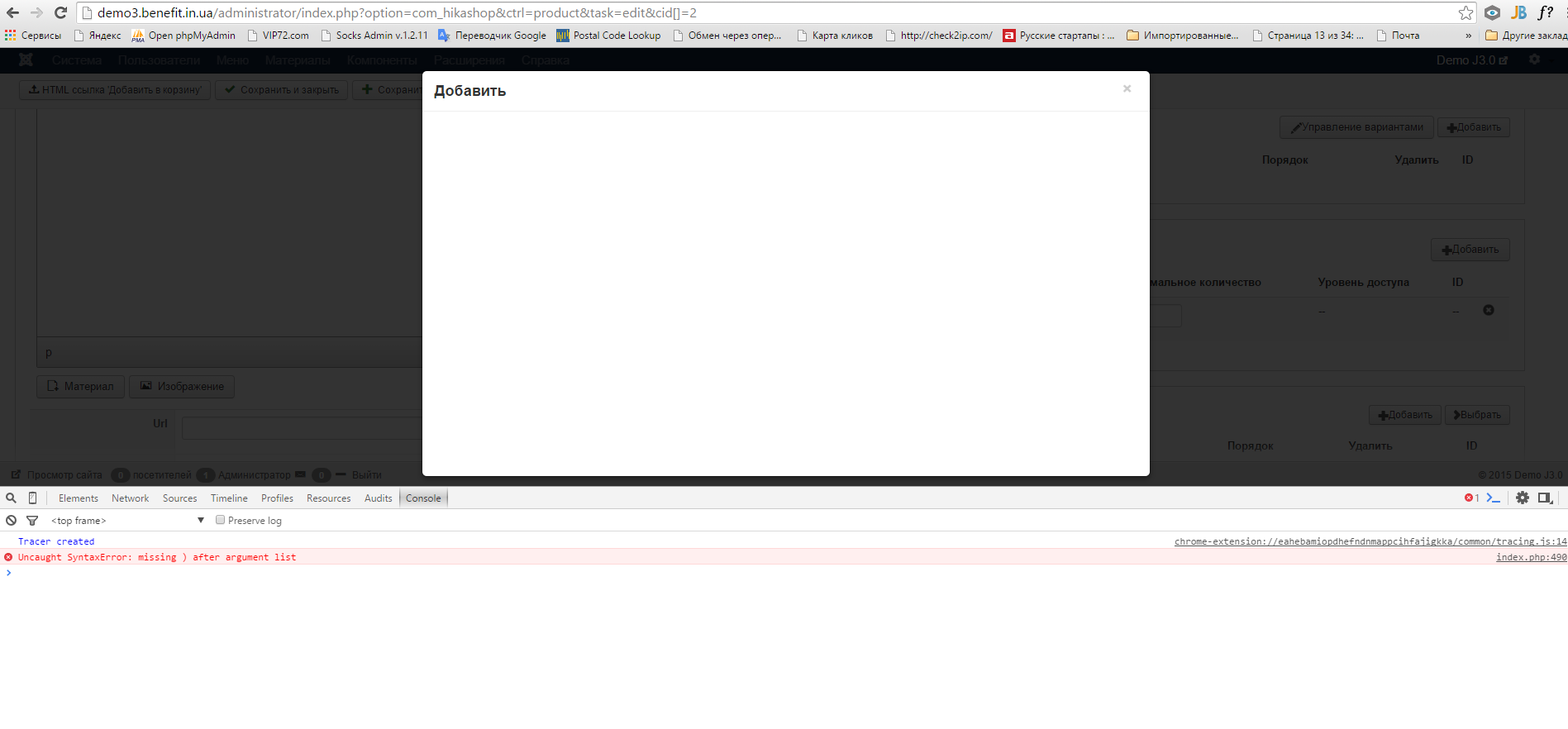

This indicates that there is a javascript error on the page. Open your browser's error console and look for the javascript error which appears for that page.
That should give more information in order to identify the problem.

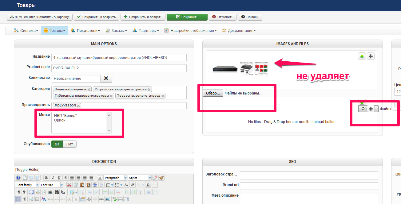

I have tested many sites and see that the problem with all versions of hikashop - 2.4.3 and 2.5.0 - all versions have problem after upgrading Joomla from 3.4.3 to 3.4.4
I have feedback from 4 customers that have the same problems.
Try to install hikashop on 3.4.3 Joomla and after that upgrade to 3.4.4
Here is screenshots:
Я здесь добровольно!
Last edit: 10 years 11 months ago by progreccor.

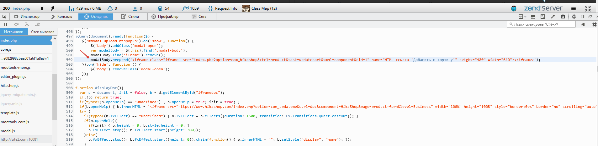

I found the problem
Here is the trouble string:
Before:
ADD_TO_CART_HTML_CODE="HTML ссылка 'Добавить в корзину'"
After:
ADD_TO_CART_HTML_CODE="HTML ссылка - Добавить в корзину"
I think that problem was with apostrophe (') symbol.
So please change this line in Russian translation and it will fix the problem

So in the file "administrator/components/com_hikashop/views/product/view.html.php" you can replace (twice)
array('name' => 'popup','icon'=>'upload','alt'=>JText::_('ADD_TO_CART_HTML_CODE'),'url'=>$url),
By
array('name' => 'popup','icon'=>'upload','alt'=>JText::_('ADD_TO_CART_HTML_CODE', true),'url'=>$url),
It should activate the "jsSafe" from the Joomla Text, and avoid the javascript issue.
Last edit: 10 years 11 months ago by Jerome.

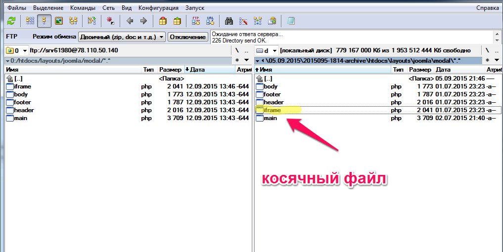

The problem with /layouts/joomla/modal/iframe.php file
Need to see the changes from latest version of the file to understand what's wrong with it
