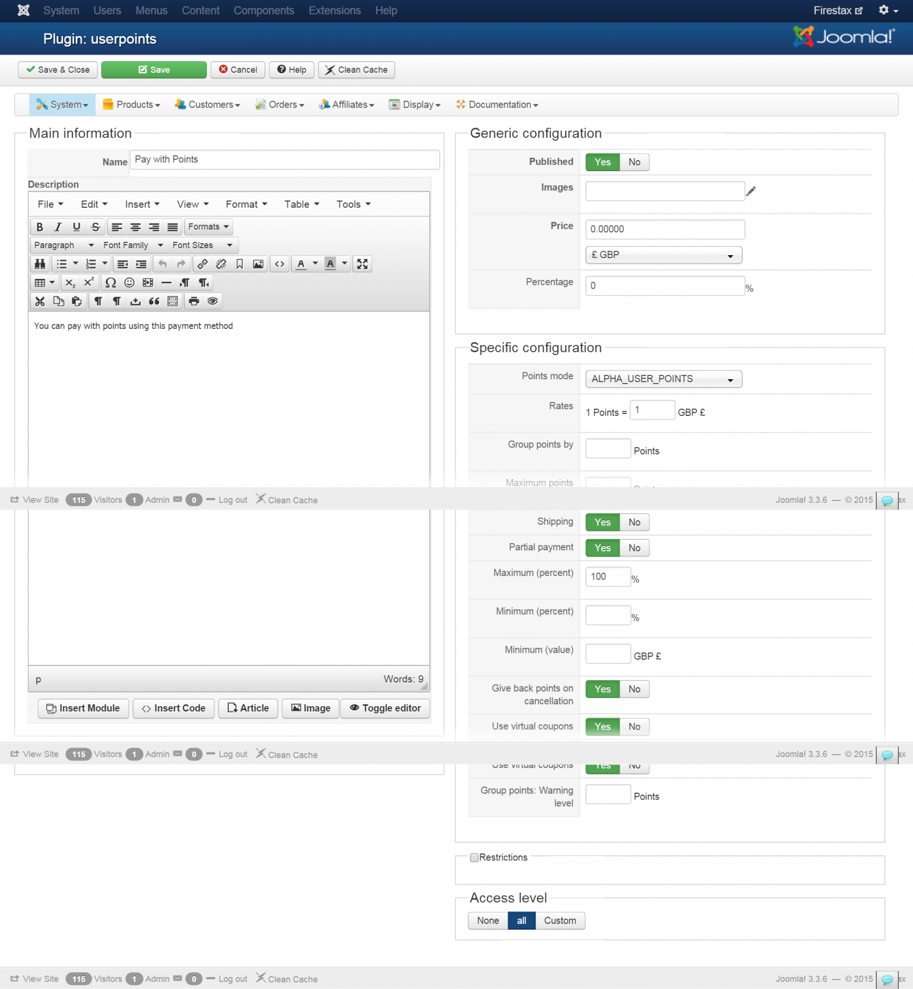

Could you provide some screenshots of how you configured your HikaShop User Points plugin and your HikaShop Payment User Points plugin ? Also, make sure that you're not using the AlphaUserPoints plugin which is deprecated (instead, you can use the two others above-mentioned).
  • Posts: 57
10 years 10 months ago #218116
So i need to have Hikashop AlphaUserPoints Payment Plugin unpublished? I am attaching screenshots.

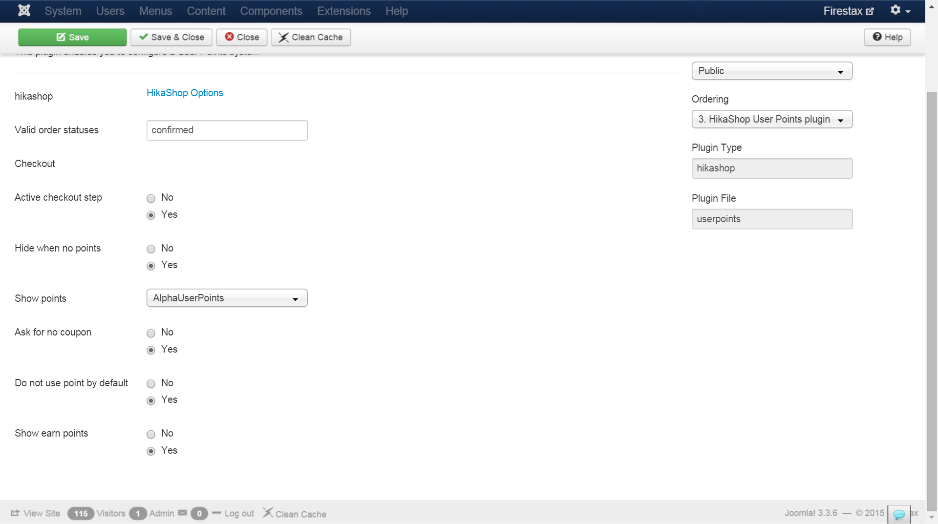

10 years 10 months ago #218132
For the setting "valid order statuses" ; I recommend you to leave that field empty and the plugin will use the HikaShop setting (from the invoice statuses option).
Otherwise, with that current configuration, if a order is modified to "shipped", it will revert the points that the customer earn/used to confirm the order.

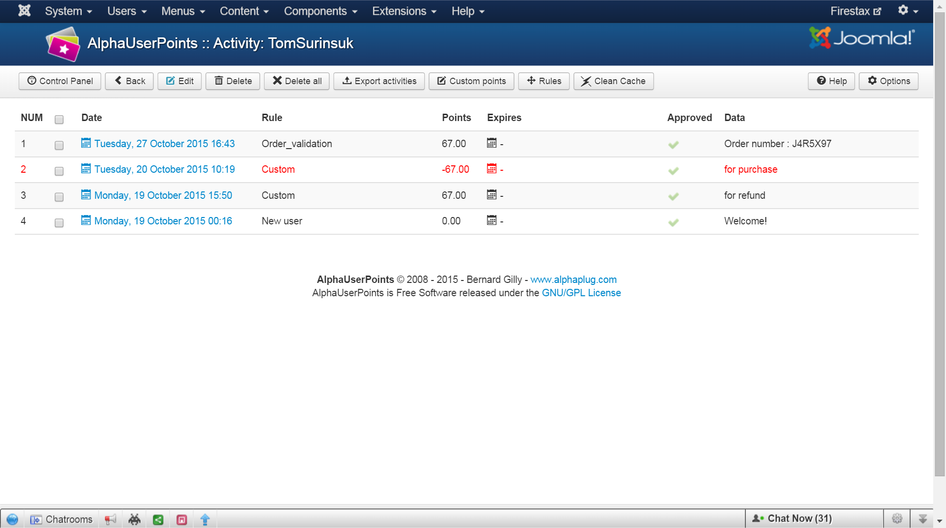

  • Posts: 57
10 years 10 months ago #219329
The one with the order_validation rule added points to the customers account when I changed the order status. How do I get it to not do that?
10 years 10 months ago #219358
CF your screenshot in post "#218116"
For sure if you do not list all valid order statuses in the field and your setting "invoice order statuses" in HikaShop is also not good ; you will have bad side efect when you change the order status of an order.
So please configure these settings like I recommended you more than one week ago.
And please provide real details to help us to understand what is going one.
I'm sorry but
is really unclear and miss crucial information...
