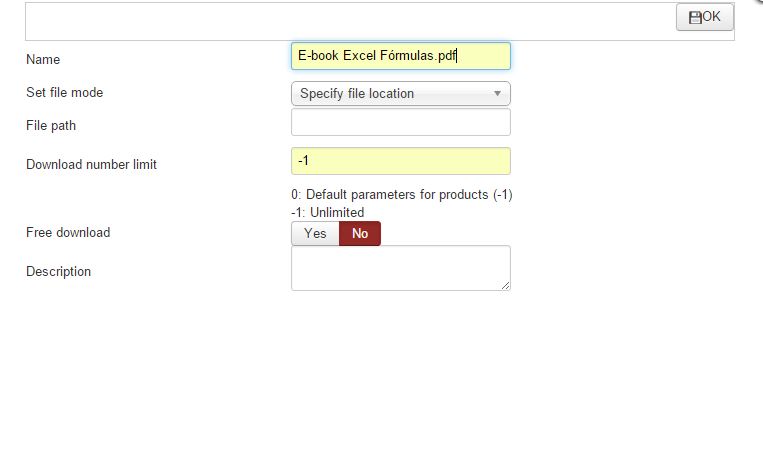

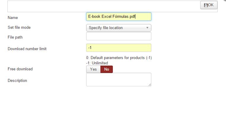

  • Posts: 111
10 years 9 months ago #220471
I have typed the file name instead of uploading the file as usual (I uploaded via FTP to /safe directory).
Now, users are downloading a file with 0Kb with the name "safe" instead of the actual file.

  • Posts: 111
10 years 9 months ago #220688
Here it is:
10 years 9 months ago #220698
In the field "file path" ; you must provide the filename of the file.
Please understand that the "name" is the name of the file which will be display in the email, in the order summary, etc. It is not the file name.
Providing a blank file path will not work and result the side effect you're facing.

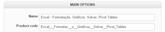

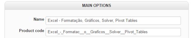

  • Posts: 111
10 years 9 months ago #220747
I'm sorry, but I still can't get it working:
What do I have to write in "File Path?"
I tried both names and also the file name, but none works.
10 years 9 months ago #220760
Your screenshot is for the product main options.
You upload a file using FTP in the "safe" folder ; so you should know the name of that file (aka : filename).
www.hikashop.com/support/documentation/i...uct-form.html#images
