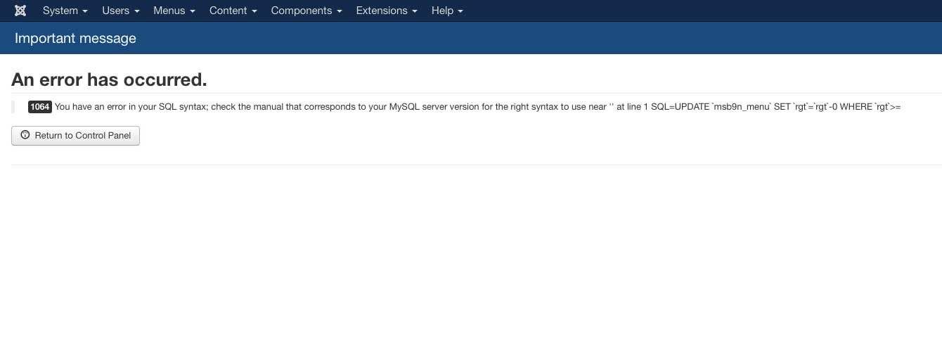

-- Error-message(debug-mod must be tuned on) -- : 1064 You have an error in your SQL syntax; check the manual that corresponds to your MySQL server version for the right syntax to use near '' at line 1 SQL=UPDATE `msb9n_menu` SET `rgt`=`rgt`-0 WHERE `rgt`>=
I purchased the upgrade to 2.6.0 and am unable to install the file.
I tried both the .zip file and the tar.gz file

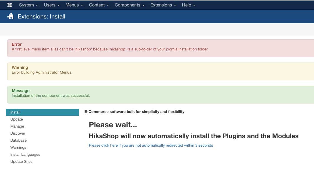

The file uploads and installs, with a couple of error messages, and then I get the message "Installation of the Component was Successful," but then I get the error message:
"An error has occurred.
1064 You have an error in your SQL syntax; check the manual that corresponds to your MySQL server version for the right syntax to use near '' at line 1 SQL=UPDATE `msb9n_menu` SET `rgt`=`rgt`-0 WHERE `rgt`>="
See the attached screen shots. What do I do?

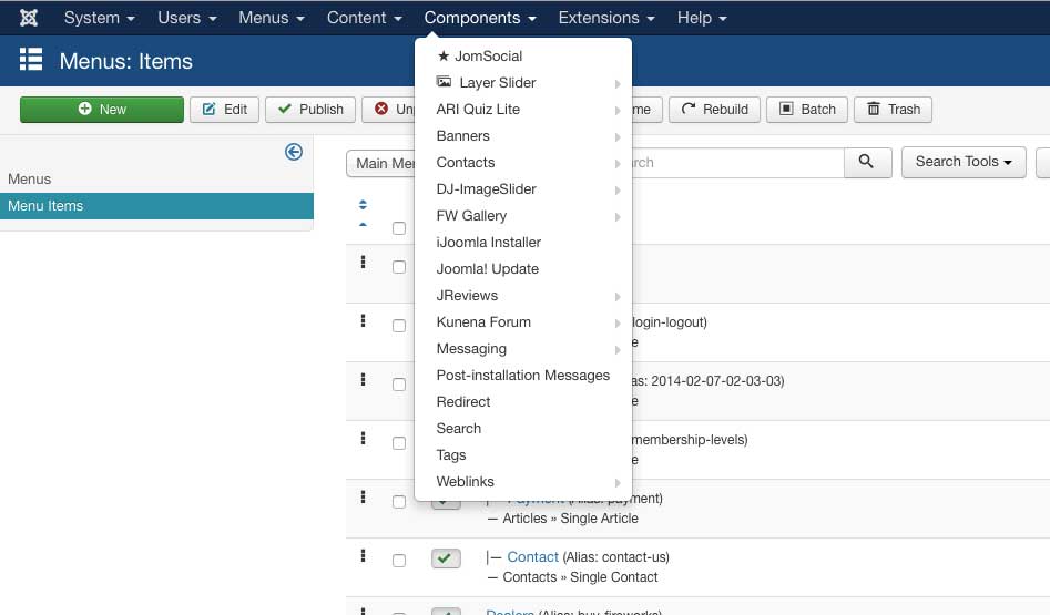

Thank you. I restored a backup that had 2.4.0 installed, and I rebuilt the menus, then I installed 2.6.0 using the Extension Manager. The extension manager shows that 2.6.0 is installed, and the front end works fine. But... Hikashop does not appear in the back end under the "Components" menu. See the attached screen shot...
