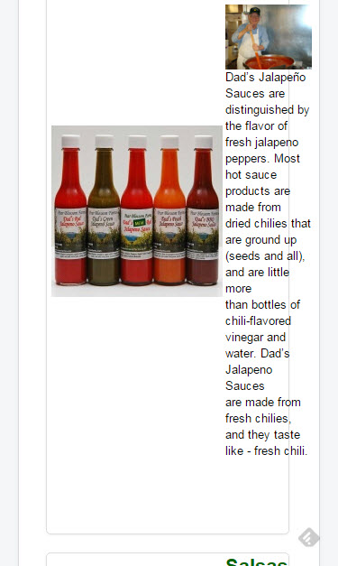

At the site pearblossomfarms.com/ my client very specifically wanted the layout that is currently visible on the home page. That category layout is not responsive and looks terrible on a narrow screen because it is enclosed inside a <table>
I am using the Joomla default template "Protostar" because the site is so simple it didn't seem worth it to make the site any heavier and the only thing I have added to protostar beside Hikashop and the usual security/backup software is a Megamenu component. All the rest is default.
The home page of pearblossomfarms.com uses a Category Display module to display the top level categories in the shop with a picture to the left and the title/text to the right.
On a desktop browser it looks exactly like what my client wants.
Problem is that for some reason it is rendered as a table. So when the same display is viewed on a narrow screen the Category image doesn't scale and the text remains to the right of it, becoming narrower and narrower until the whole thing looks ridiculous.
I don't see why that layout even needs a table. But I have tried to change a number of parameters and the only option seems to be rewriting the view of the category display, which is frankly a lot of work.
Have I missed some setting that will allow me to display my top level categories in the same fashion but using a mobile friendly, responsive layout without tables?
Should I be stuck with tables, could I at least eliminate the cells inside a <tr> so that on a narrow screen I end up with the category picture above or below the text instead of the current, very ugly side by side layout?
If so, what file should I be looking for, if anyone knows.
Please, keep in mind that the desktop layout is exactly what my client wants. No changes should be done there.
Thank you.

The CSS doesn't work. I added it to the shop as in the tutorial, then I added it as a overall rule, as an inline rule to the <td> tags. I simply don't see how I can take this:

EDIT: I was able to find the page in question and take out the table. A few lines of CSS have made it so it works fine in most browsers/platforms, but I'll have to fine tune the CSS and do more testing later. I am aware it's not yet perfect. But it is a sight better than it was before on small screens.
