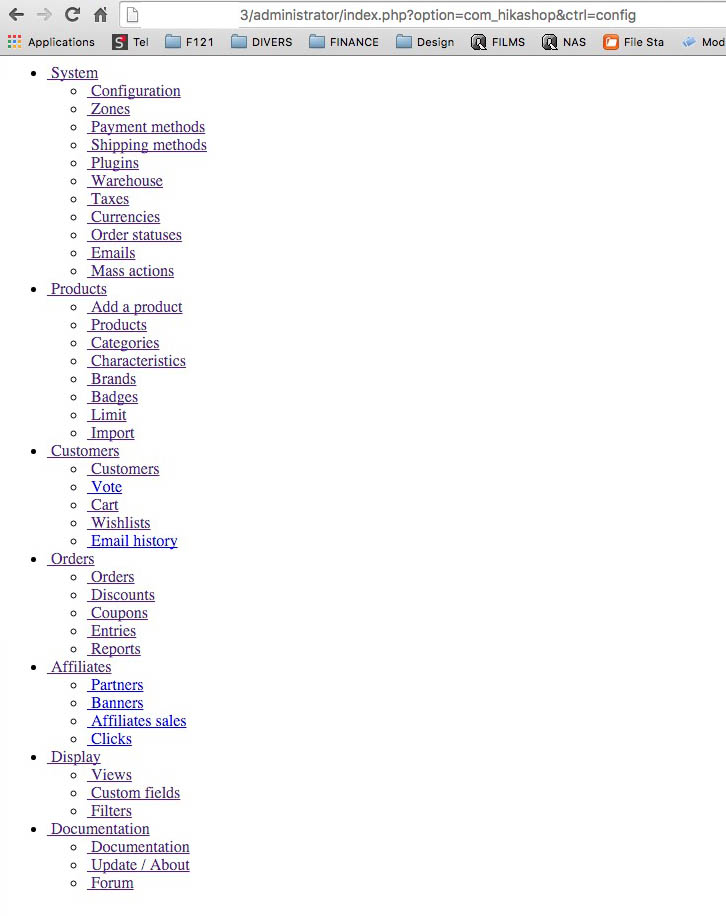

I couldn't update the status of an order (no popup) unless I replace the popup.php file in administrator/components/com_hikashop/helpers/ like explained in a previous post
It solved my first issue, but after the upload, the Hikashop Configuration page displays only links (like a site map) and further the "Configuration" link doesn't work, so I haven't access to all the configuration section of Hikashop :-(
Would you have an idea?
Thank you in advance !

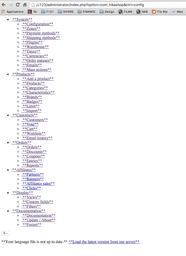

10 years 7 months ago #226171
Can you :
- Activate the Joomla debug mode ("Administration->Global configuration->System->Debug System/Language")
- Set the "error reporting" option of the Joomla configuration to "maximum"
- Test it again so that you can see if it display an error message which will help you to understand from what your issue is coming.

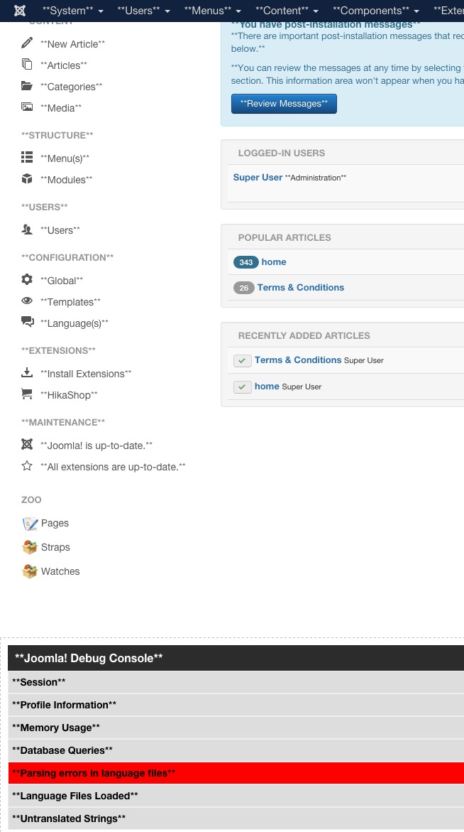

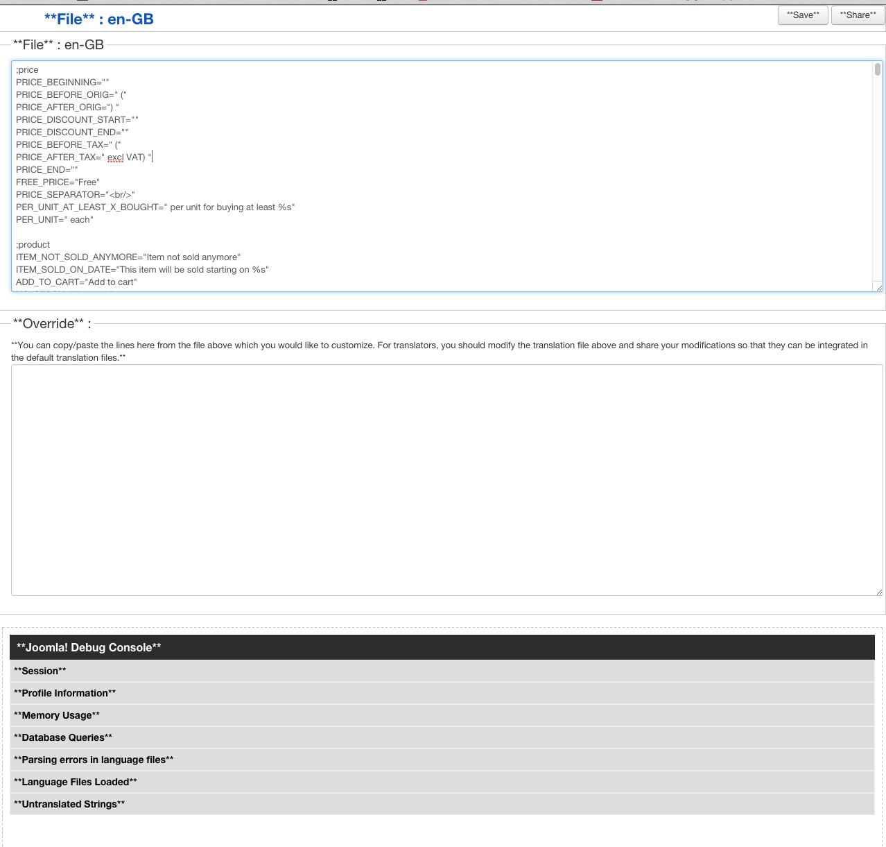

10 years 7 months ago #226196
Thank you, I found this. Does it help?
I give you with pleasure an access to the backoffice...
Thank you Mohamed
Last edit: 10 years 7 months ago by jean-loup.

10 years 7 months ago #226291
Hello tbroderick,
You activated the language debug mode ; unfortunately, that's not what we need
