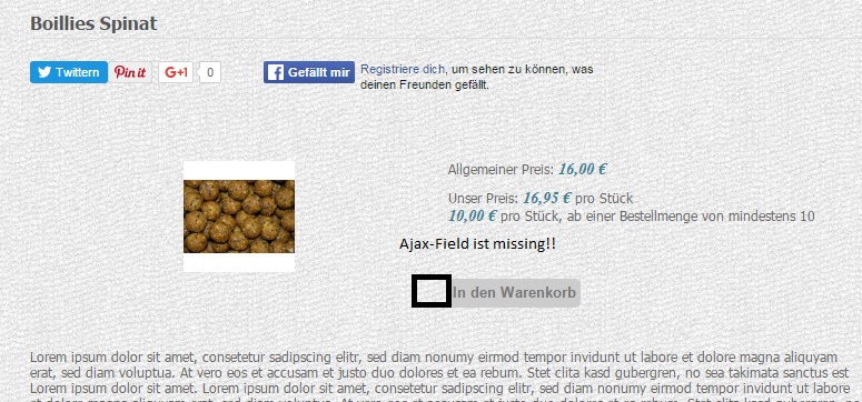

Hallo,
habe eine Probelm. Und zwar geht nach der Installation von Hika Shop auf der Produktseite die Ajax-EIngabe nicht. Sie wird erst gar nicht angezeigt. Was kann ich da tun, dass diese funktioniert?

I'm sorry but we don't speak your language. Please ask your question in English. Also, please provide screenshots of the issue and a link to the page so that we can see the issue.

I have an problem with the Ajax-Display on the product-site in my Hika-Shop. After the first installation from Joomla und Hika-shop, the Ajax-field ist missing. I can not send any linkt to the Site, because it is a offline-project.
Has anybody an idea, waht ist the problem??
Thank you for the effort...

You're talking about the quantity field.
Make sure that the "Display the quantity field on the product page" setting is set to either "normal input" or "ajax input" in the settings of the HikaShop configuration.
Also, please check the "Quantity input" setting of your product and make sure that it's not set to "inherit" or "none" but to "default" or "show simple".
