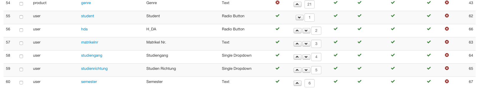

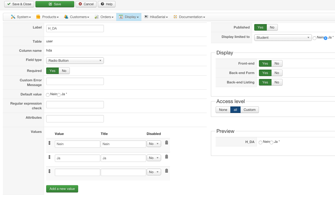

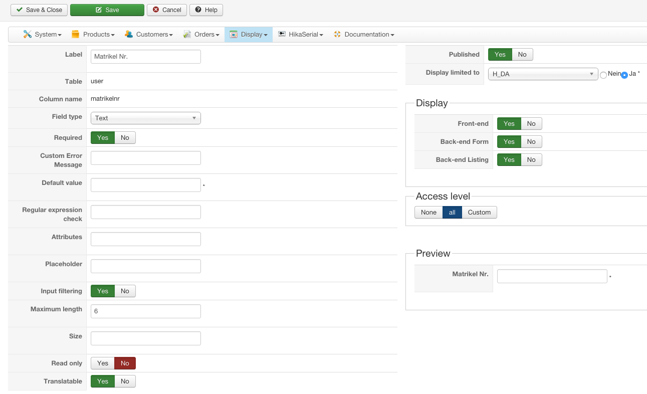

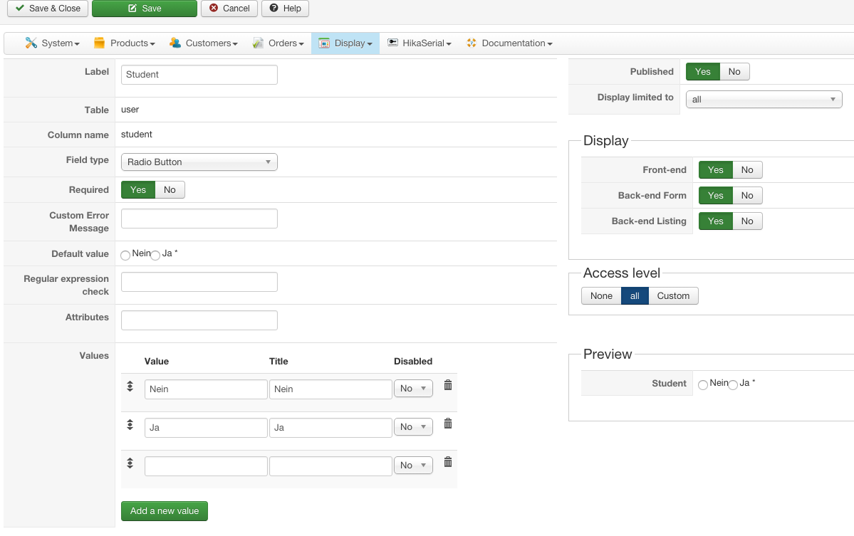

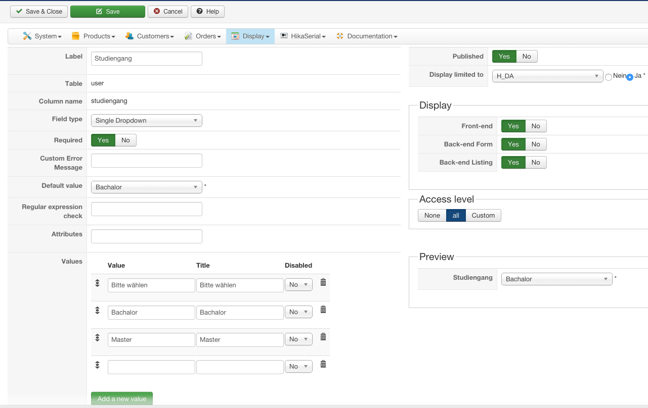

i just tried to set up a simple constrained field set for the user registration process.
So i have a radiobutton group for "are you a student" yes /no. This is mandantory. I f yes then a second radiobutton group is/should be shown shown "university name hda" yes/no. After user clicks yes several other fields and dropdowns should be shown. So i setup these constrains like explained in the documentation of fields but all fields are always shown. For my understanding the second radiobutton group should show if the user selects in the first radio button group "yes" and if he selects yes in the second group the other fields that are dependent to the second radio button group should be shown.
At the moment everything is shown right from the first moment.
You can try this on my devsite -> Login -> Register new account. For a better understanding i add some screenshots of the configuration.
Did i miss anything with constraining fields as it seems to be very simple?
Thanks for your help in advanced !
