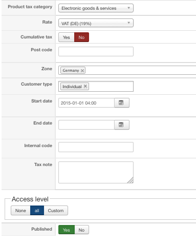

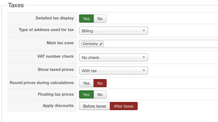

Please give us a screenshot of your settings in Configuration > Main > Taxes.
And of one tax rule configuration.
  • Posts: 159
10 years 4 months ago #236774
HI Xavier,
here are the screenshots:

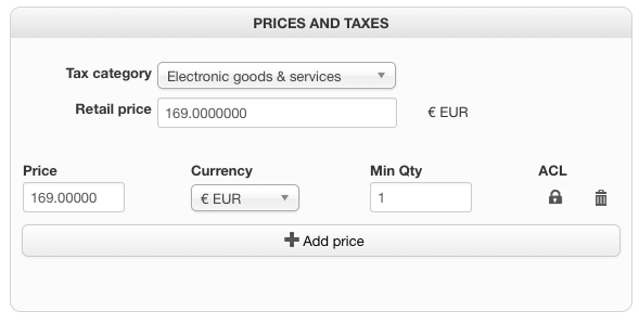

Please make sure that the "Electronic goods & services" tax category is selected in your products or the tax rules won't be used.

yes, the products are set to "Electronic goods & services" tax category. I checked the FAQ list again (I did it before I posted the problem) and can't find the reason, why the tax is not showing.

The "default address type" setting of the HikaShop configuration wasn't set correctly.
I've set it properly and it's working fine now:
take.ms/fwjaO

That option has actually been removed in recent versions of HikaShop and thus has been removed from the FAQ.
It's only visible if you had set it to something else than its default value (which should not be changed in the vast majority of the cases).
