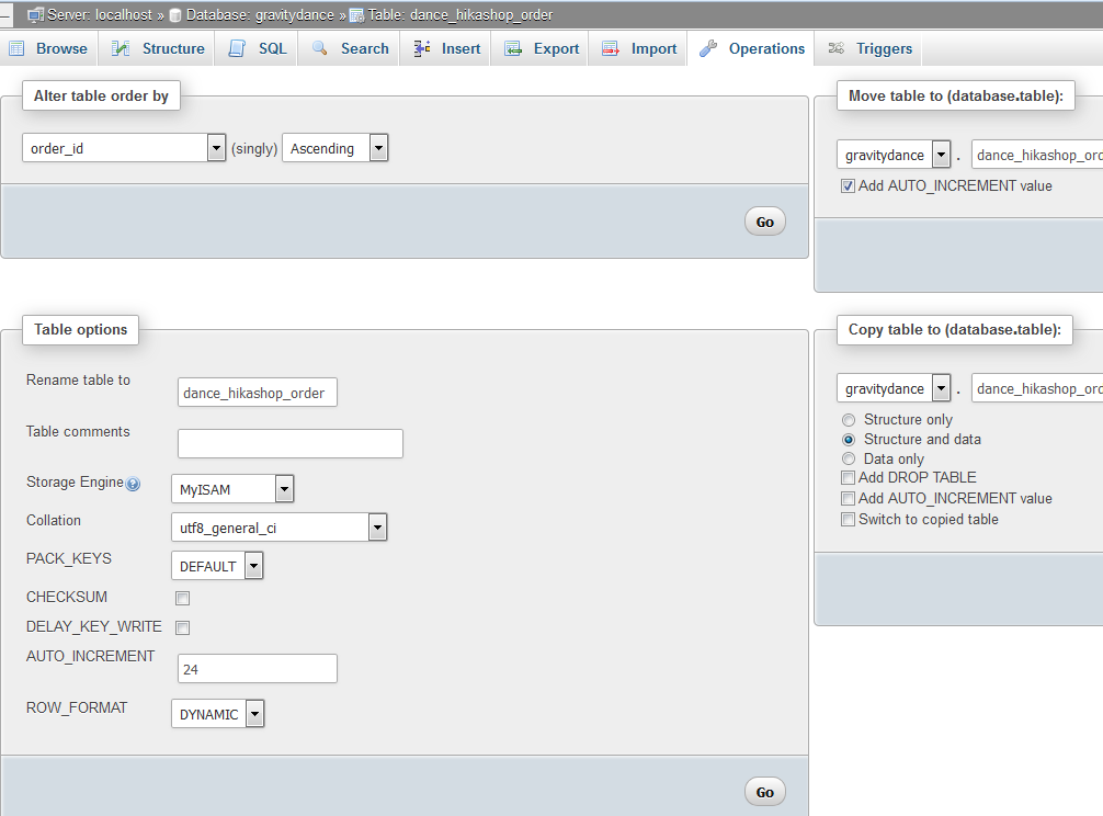

The AutoIncrement field will need changed to 8000.
Here is a screen shot from phpMyAdmin. Do you have direct access to your database?
Kelso
10 years 3 months ago #240108
See AUTO_INCREMENT setting in your screenshot
Last edit: 10 years 3 months ago by Jerome.
