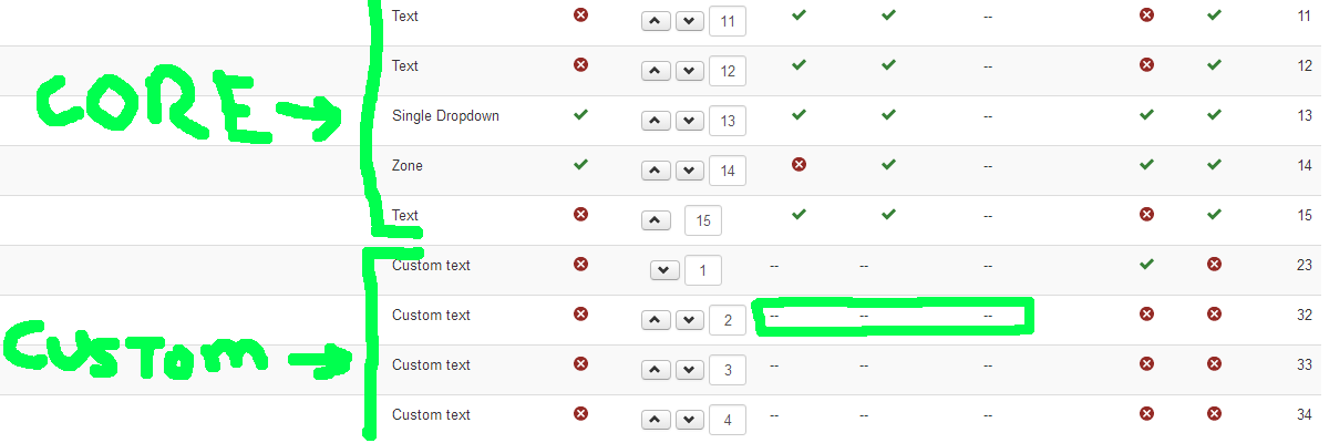

I need to use a number of custom fields on product pages and during checkout. After the 2.6.3 upgrade I noticed a problem with my custom fields. None of the fields that I have setup have the green tick buttons for Front-end Back-end Form Back-end Listing settings. Core custom fields still have the green tick buttons. I have attached a screenshot to demonstrate this. Is this a feature of hika 2.6.3 or a problem? The behavior i describe does not happen if I upgrade with hika 2.6.2

It is a HikaShop 2.6.3 feature ;)
If you edit a custom field you will see that they can be restricted to some layouts only.
Only on listings, on product page, etc. That's why there is no more the green tick button, because it is no more as generic as before.
You can to enable the display of the custom fields in the emails in the new custom fields settings.
