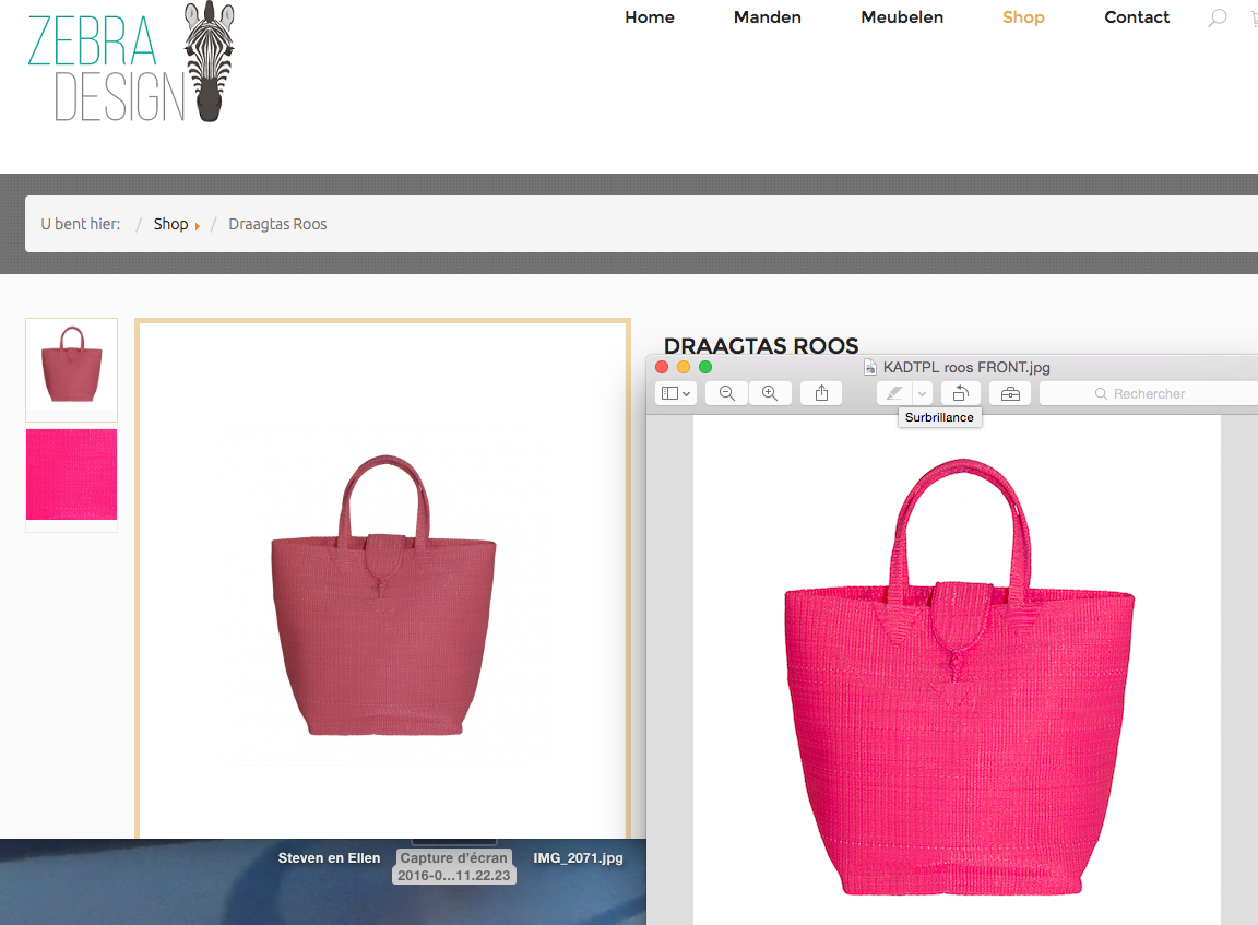

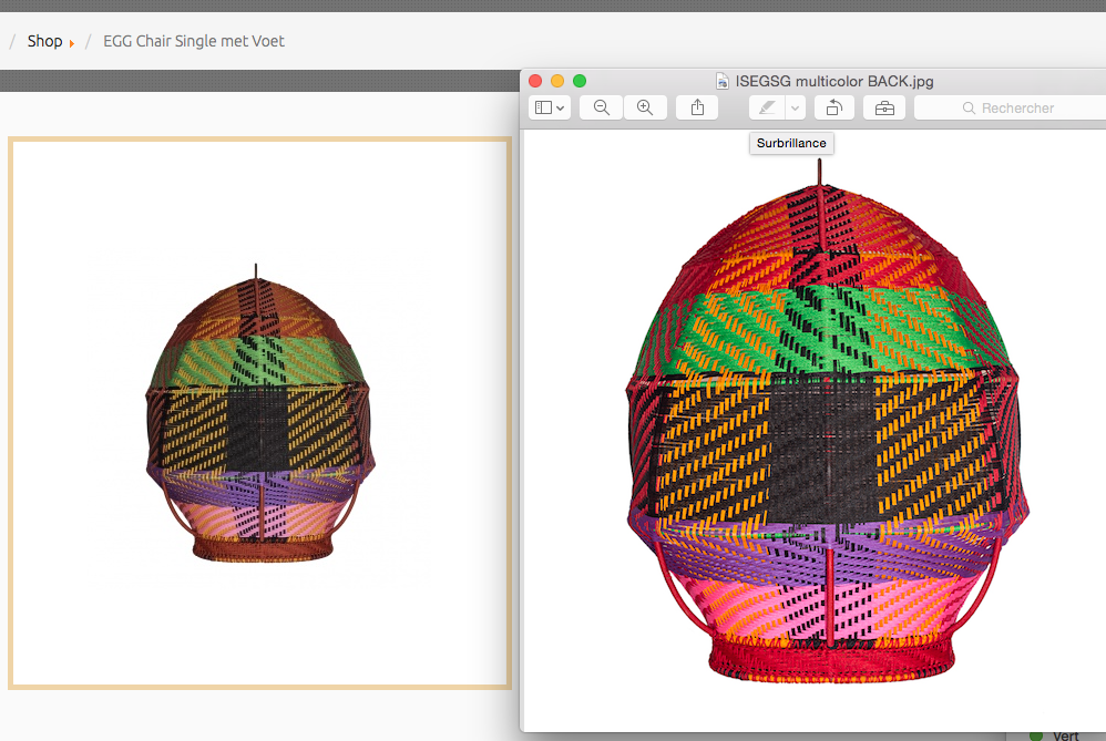

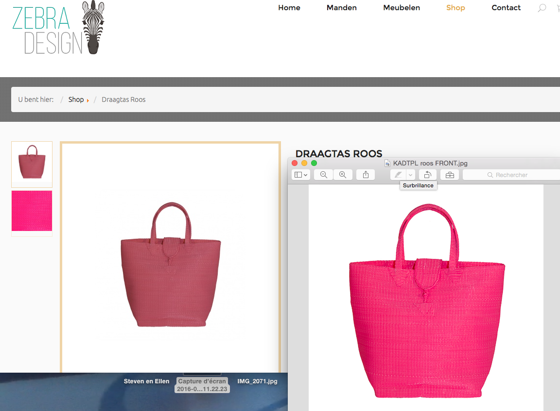

Dear,
the colors of images after upload in Hikashop are not the original colors sometimes ?
See some examples:
www.zebra-design.be/index.php/shop/product/106-draagtas-rood
www.zebra-design.be/index.php/shop/product/121-draagtas-roos (see upload 1)
www.zebra-design.be/index.php/shop/produ...hair-single-met-voet (see upload 2)
It is important that the original colors are shown.
How can I solve this please ?
TIA
Thierry

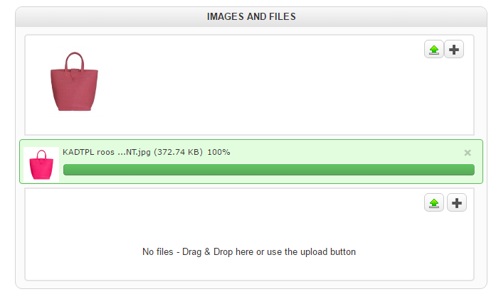

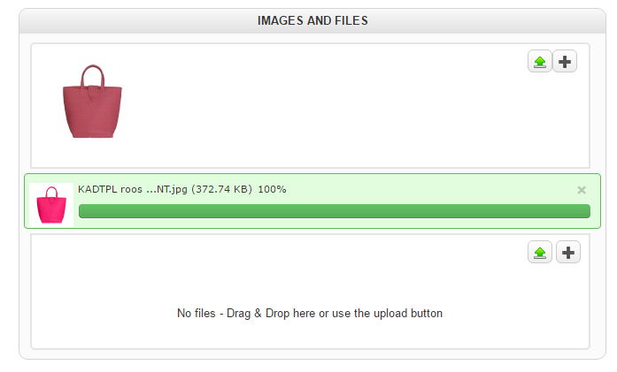

10 years 2 months ago #242870
I send a mail to the support with login information :)
I go to Hikashop / Categories
choose the correct category
e.g. Accessoires / Draagtassen / Plastiek
click on Products / Products
click on New
click on Upload image (green arrow)
you see while it's uploading the correct color and then it changes
see image
TIA
Thierry
Last edit: 10 years 2 months ago by sindb. Reason: explanation how upload image product

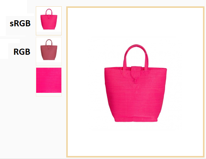

  • Posts: 86105
  • Thank you received: 14206
10 years 2 months ago #242948
I think that your problem is this:
stackoverflow.com/questions/5773032/how-...upon-resizing-images
Your image is saved with a color profile different than sRGB.
And GD2, which is the PHP library to handle images transformations only supports sRGB.
It is recommended to only use sRGB images if you want to use them on the Internet.
So please check that and make sure that you use images with sRGB.
As written on the link above, the only solution to supporting images with other color profiles would be to use ImageMagick instead of GD2 to process the images, but only GD2 is installed by default with PHP so if we were to support ImageMagick library, it would work only for a handful of users of HikaShop. And even then, you would have issues with customers of yours using old browsers not supporting the color profiles you're using in your images. So it's best to stick with images in sRGB.

10 years 2 months ago #242986
sRGB isn't the same thing from jpg.
jpg or png or else bmp are file format, sRGB or RGB or else are the way picture is encoded.
You have to have the good configuration in your program like photoshop by example) in order to save your picture in sRGB encoding.
Hope this will help you.
Regards.
The following user(s) said Thank You: sindb
  • Posts: 49
10 years 2 months ago #243188
Thank you :)
as you can see the image has the correct color now :)
this ticket may be closed.
Friendly regards,
Thierry
