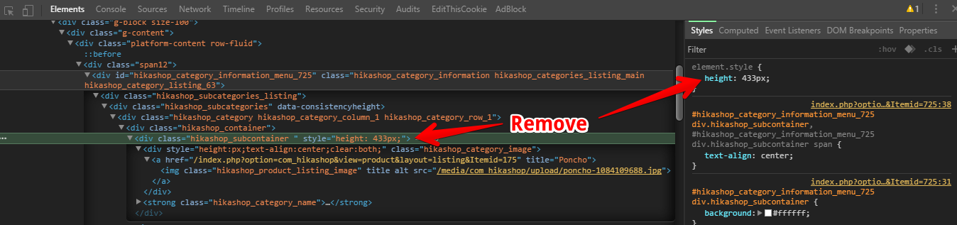

can you please tell me how can I remove the inline height added to the hikashop_subcontainer div on categories listing page?
Where can I find the code?
thanks!

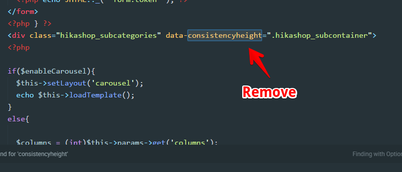

10 years 2 months ago #245103
Shouldn't the code above be assigned to a variable, because it doesn't work.
I've removed the code listed in the attached screenshot. Will this be a correct solution?
thanks!

You can also remove that code yes.
You actually have an old version of the view which is why it didn't work.
The code you're talking about is actually like that by default with the latest version of HikaShop:
$attributes = '';
	if($columns>1 && $this->params->get('consistencyheight',1)){
		$attributes .= 'data-consistencyheight=".hikashop_subcontainer"';
	<div class="hikashop_subcategories" <?php echo $attributes; ?>>
