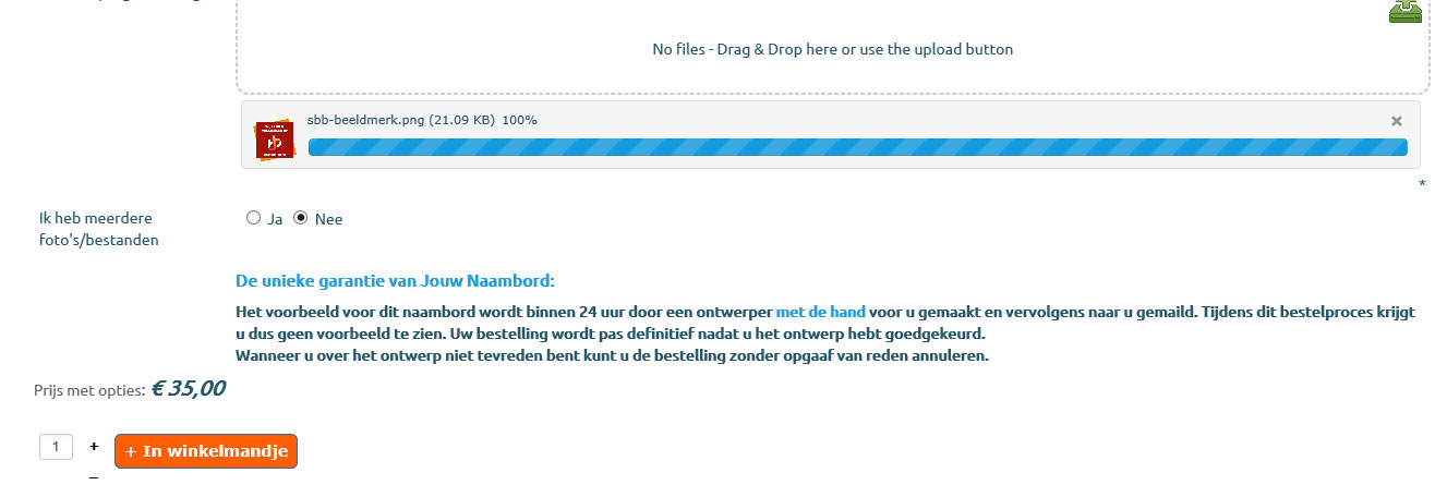

10 years 2 months ago #245008
Works good for me.
IE11 : pasteboard.co/8zhr3mtCE.png
Edge : pasteboard.co/8zjtmGh23.png
