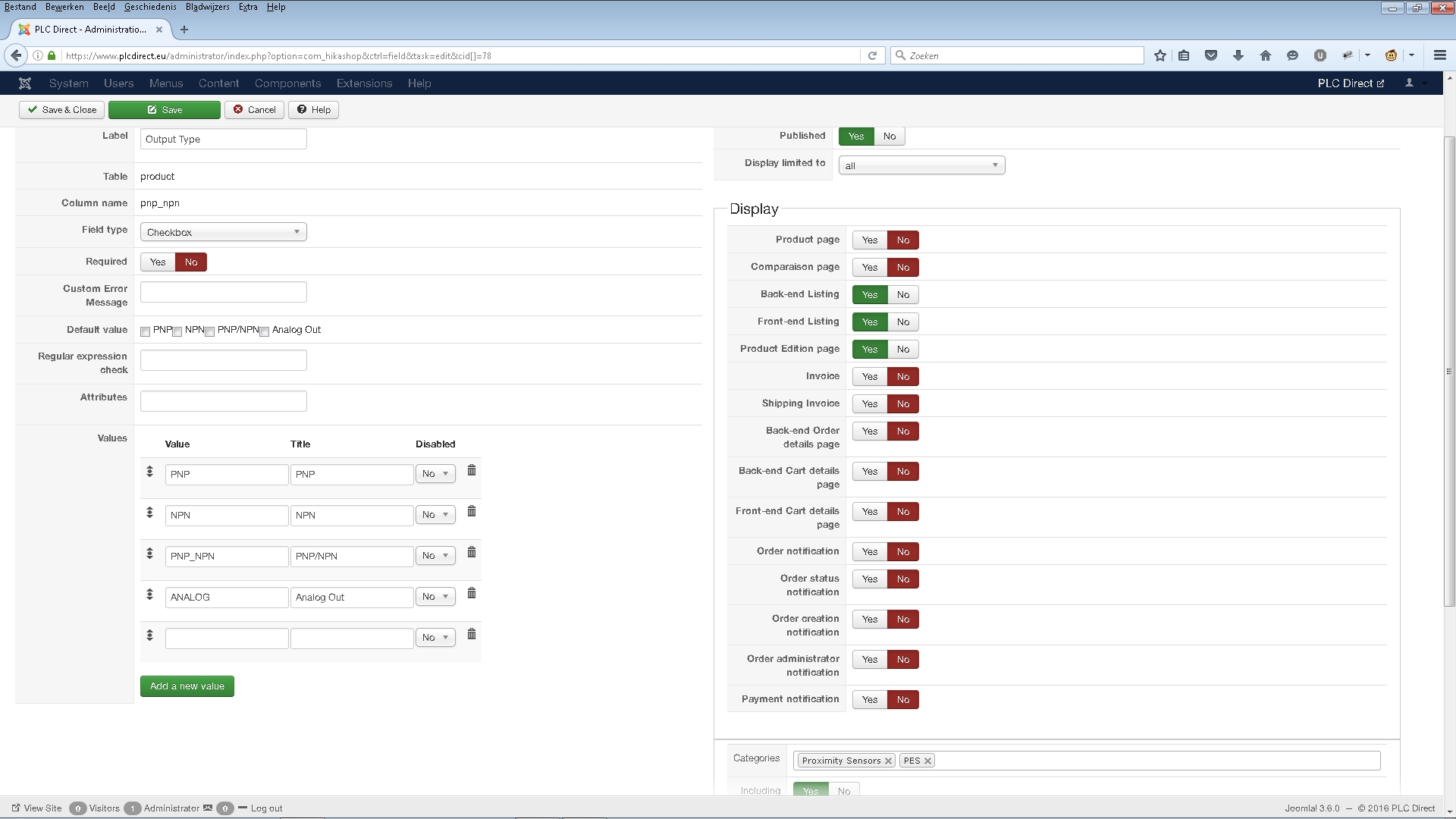

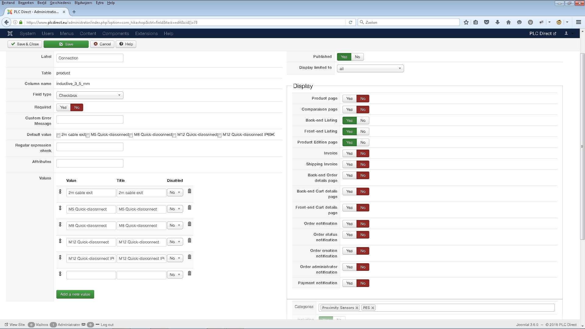

2. I suppose that the problem must come from the values that you're using in your custom field which must overlap and thus the filter system finds a match for the selection of the value.
Could you provide a screenshot of the setting of the custom field of that output type filter ?
  • Posts: 26
9 years 9 months ago #248710
1. We've added a language override in Joomla backend > Extensions > Languages > Overrides > Site
HIKASHOP_NO_RESULT='No results found!'
Still the same issue as mentioned in my initial post.
2. See the attached files.
