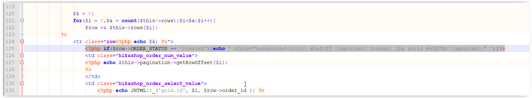

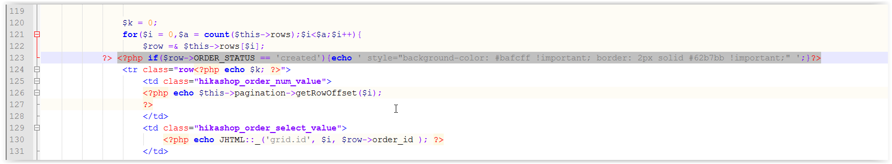

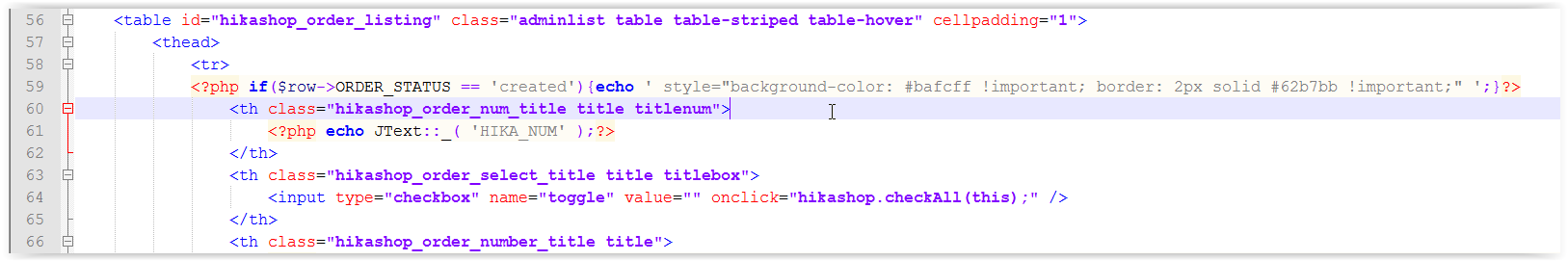

  • Posts: 5
9 years 7 months ago #259211
Hello!
I paste the above code, and unfortunately it does not work at all. What am I doing wrong? :(
All configuration (in attachement) not work...

  • Posts: 5
9 years 7 months ago #259501
Hi :) Thx for answer..
I paste this code to "admin/component/hika/view/order/tmpl/listing.php". Where should I paste the code that worked correctly?
  • Posts: 86106
  • Thank you received: 14207
9 years 7 months ago #259513
As I said in my previous message, you need that code in the tr tag there.
In your screenshots, I can see that you put the code either before the tr tag or after it, not inside it... like that:
<tr <?php ....PHP code.... ?>>
Also, you've used the variable name ORDER_STATUS. That's not valid. It should be order_status, as in the example I provided.
