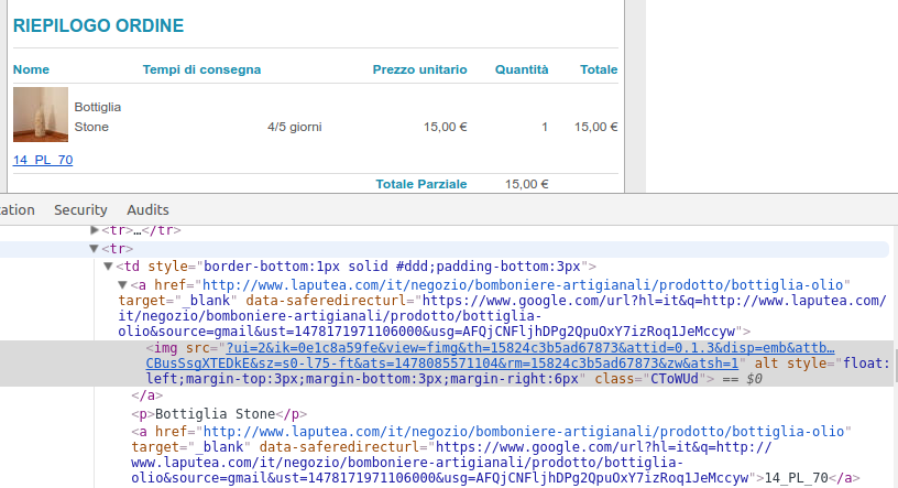

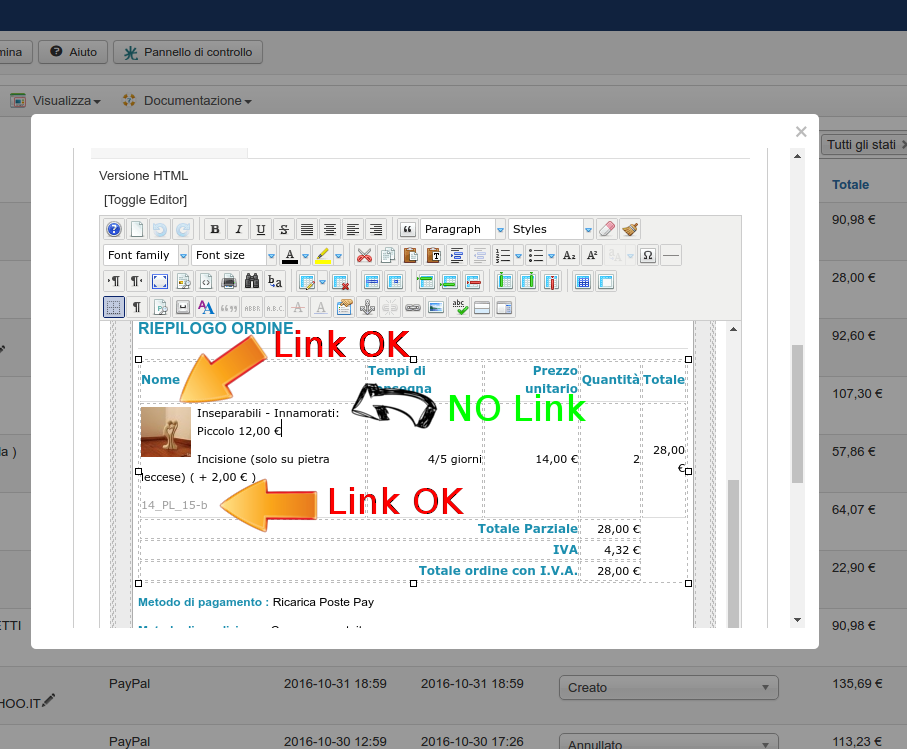

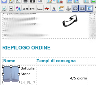

Screen 1: email preview (see the link above the arrow). Link correct in image and product code

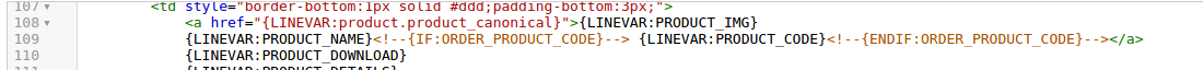

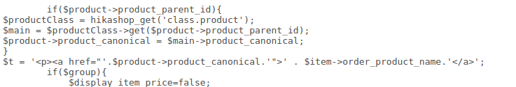

Screen 2: email code in System > email

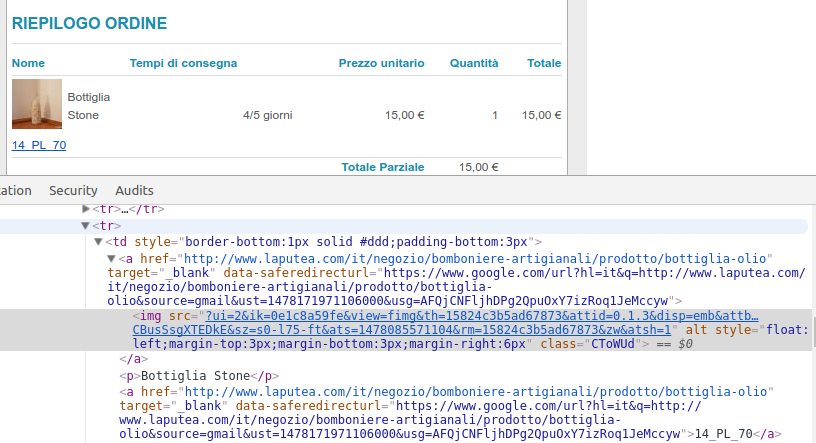

Screen 3: email code in google chrome page analysis
Thank You!

It might be that gmail doesn't link for the p tag around the product name to be inside the a tag as it's not valid HTML.
Try instead to change the line:
$t = '<p>' . $item->order_product_name;
to:
$t = '<p><a href=" mywebsite.com/ ' .$product->product_canonical.'">' . $item->order_product_name.'</a>';
in the preload section of the email.

hello Nicolas,

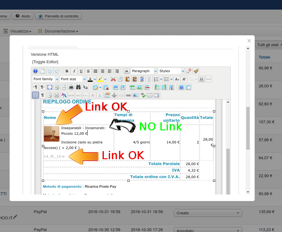

I do not think that the problem depends on gmail, because the product name is not linked even in the preview sending the mail backend. I attach screenshots.
So it will be a code problem.

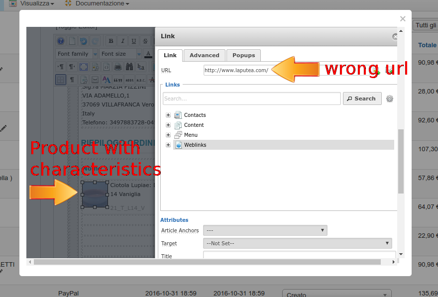

But there is another problem! The product is properly linked if not features. If there is a product that has the characteristics then the canonical url does not work. It does not appear the canonical url, but is only the link to the home page! It is not strange?

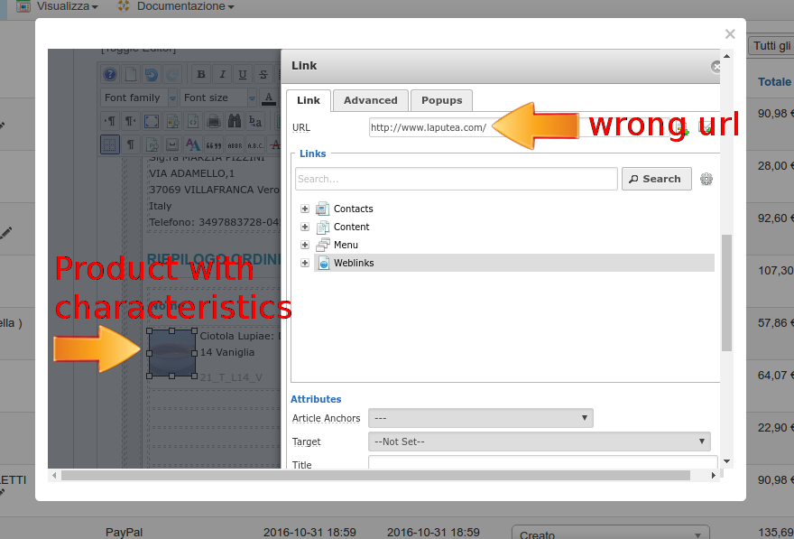

However, it remains the other problem: if a product has the characteristics (variants), the canonical url does not work, the link leads to the home page. How can solve this problem?

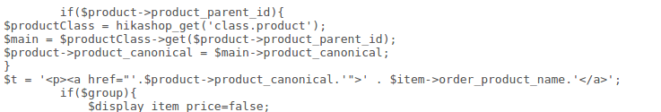

For variants, you'll have to do instead:
if($product->product_parent_id){
$productClass = hikashop_get('class.product');
$main = $productClass->get($product->product_parent_id);
$product->product_canonical = $main->product_canonical;

I noticed that with the code that you suggested I enter, the problem is solved, but only for one product. In case of multiple orders just a product has the correct link, others not, link only to the home page. is a code problem?

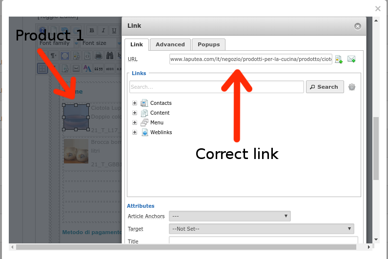

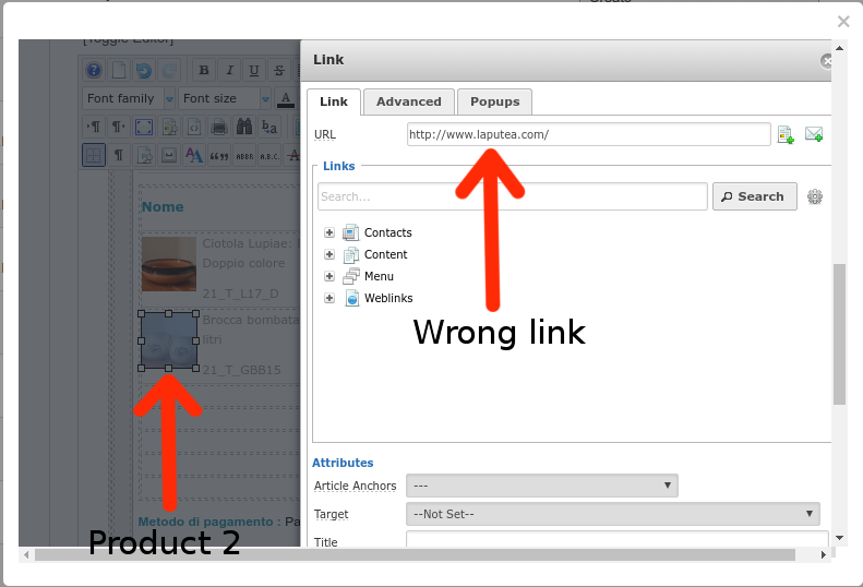

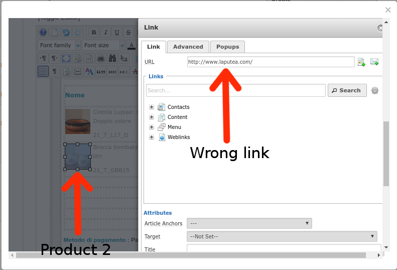

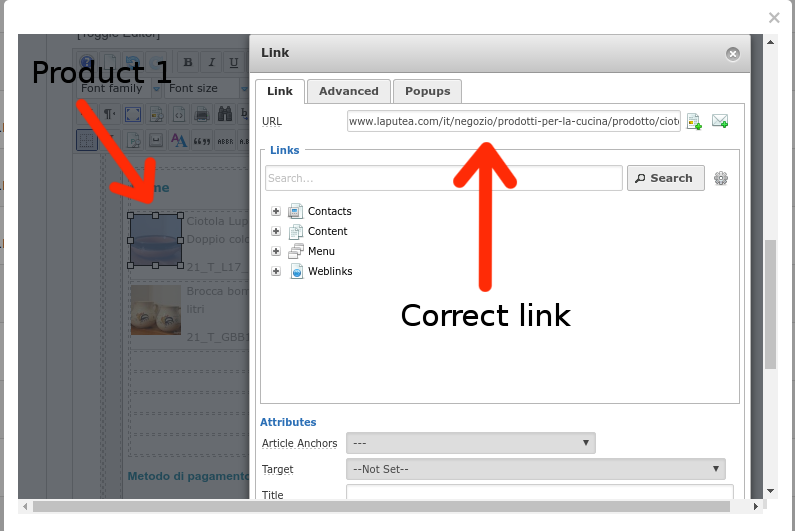

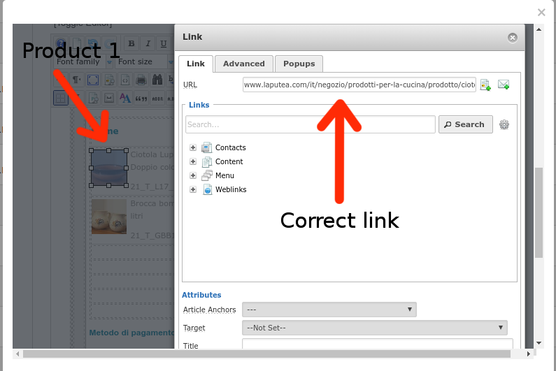

if an order comes with 2 or more products, only the first product has the correct link, the other not. Attach screenshots.
Correct link, product 1:
Wrong link, product 2:

On your screenshots, you're looking at the link of the image, not the link of the product name.
And the code I gave you was for the link of the product name.
So I don't see how these could be related.
There should be no link on the product image unless you added some other custom code I don't know about.

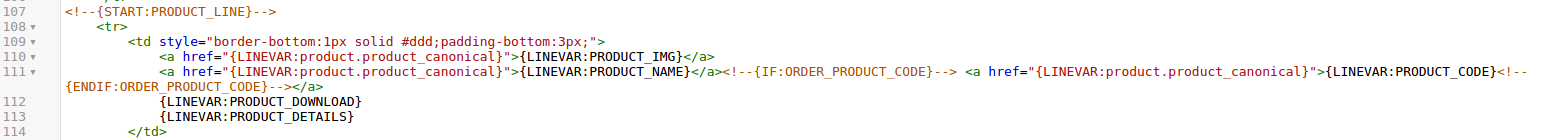

  • Posts: 113
9 years 10 months ago #254950
Hello Nicolas,

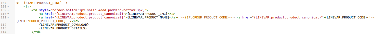

here's a screenshot of the code in System> Email
The link does not change if placed in the name or the image of the product. The problem is another. Some products are linked properly, some not! And all the products have the canonical URL correctly filled. Because some products are linked, and others have the link to the home page? that's what I do not understand!

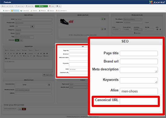

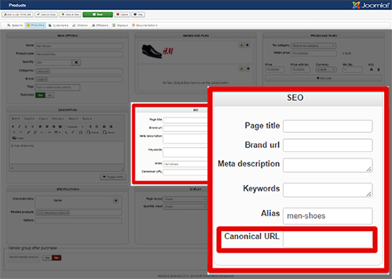

You need to have the canonical URL filled for all the products in your backend interface. If the canonical URL is not missing, then the URL will be empty and it will use instead the homepage URL of your website.

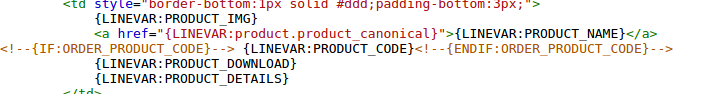

In email> I have this html code:
In email> preload version I have this code:
Now, I do not know why, but the generated link is this:
www.laputea.com/www.laputea.com/it/negoz...bottiglia-olio-fiore
The mistake lies in the fact that the code generates a www.laputea.com/ that has nothing to do!

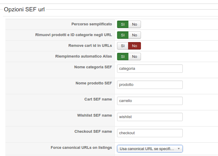

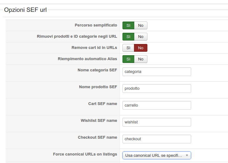

In sef url options have these settings:
So I wonder what generates a url right and because in some linked products in the mail is not generated the canonical url?
