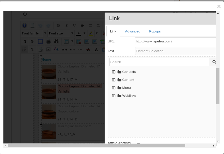

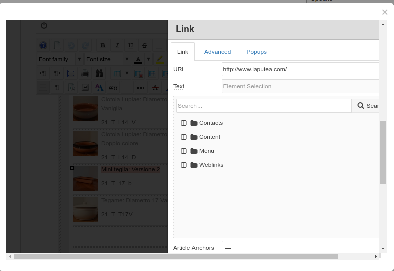

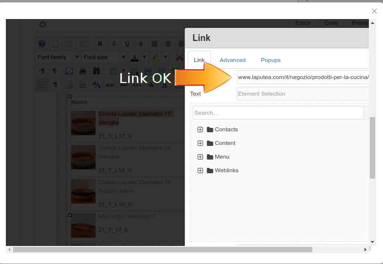

The link works, but only for some products! As I said in the past, in some cases it does not work, or is it the product variants or different products ...
For some products, the link works, not for others!
Look at the pictures:
Product 1: link works
Product 2 (variant of the same product): link do not work
Product 3: (different product): link do not work
I still can not understand why! Yet for some products the link works! Usually this happens when the customer buys more products. You only buy one, the link works. All the products have filled the canonical URL. I checked two times and each canonical URL is correct.

In fact the problem is not logical, because if you look the first two images of the last post, you see that there is a product with two variants: The first variant has the link properly inserted, the second variant no. But the canonical URL is the same for both variant of the same product. Because the first works, and the second not? :huh:

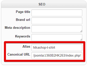

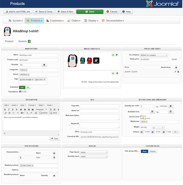

Can you provide (as ask by jerome) details about concerned products, more precisely, we needs product configuration page of :
- Product with correct link AND product without correct link.
We want see this :
Plus, provide this :
Alias: hikashop-t-shirt
Canonical URL: /joomla/J360B2HK263/index.php/hikashop-menu-for-categories-listing/product/hikashop-t-shirt
Awaiting details from you.

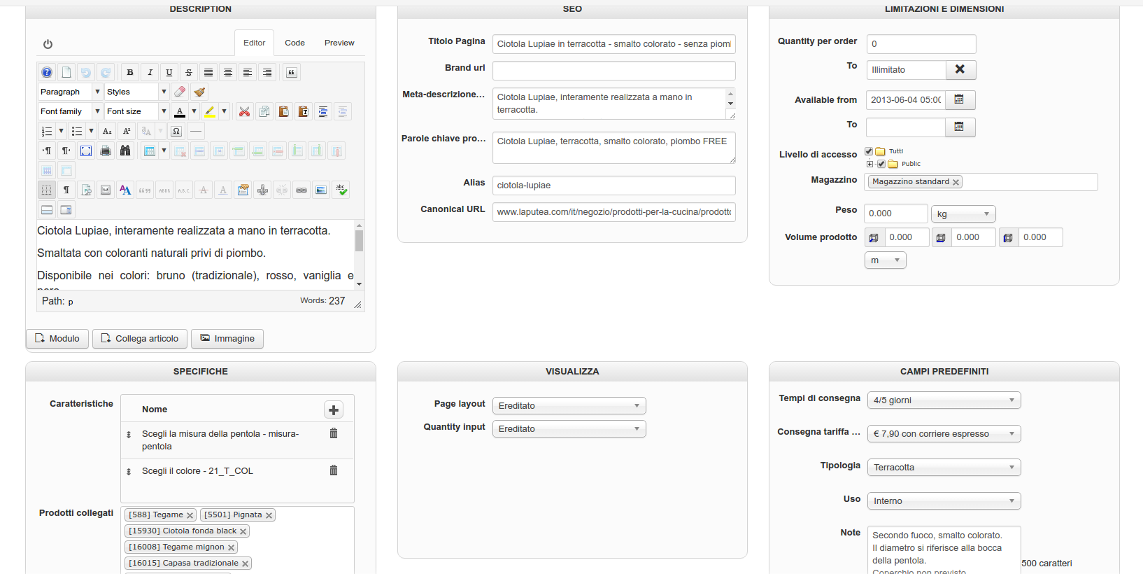

  • Posts: 113
9 years 7 months ago #261792
Hello, thanks for the answer.

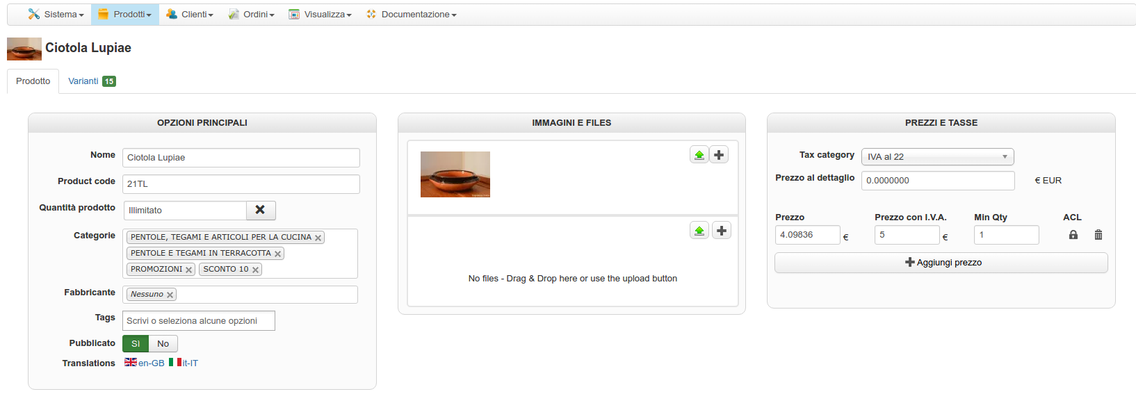

I attach screenshots of the product, but, as I said, the problem also occurs on the same product if it has other models. So if the customer orders:
1 red dish
1 white dish
the first model has the correct link, the second model is no link. But it is the same product.

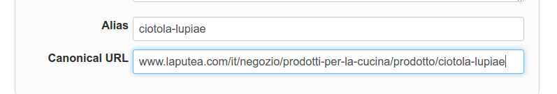

It looks like your canonical URL is wrong.
It should normally be a relative link starting at the root of the website, like in the screenshot of Philippe.
I suspect this might be why the system doesn't behave properly.
Could you please try again with valid canonical URLs for the products of the order ?

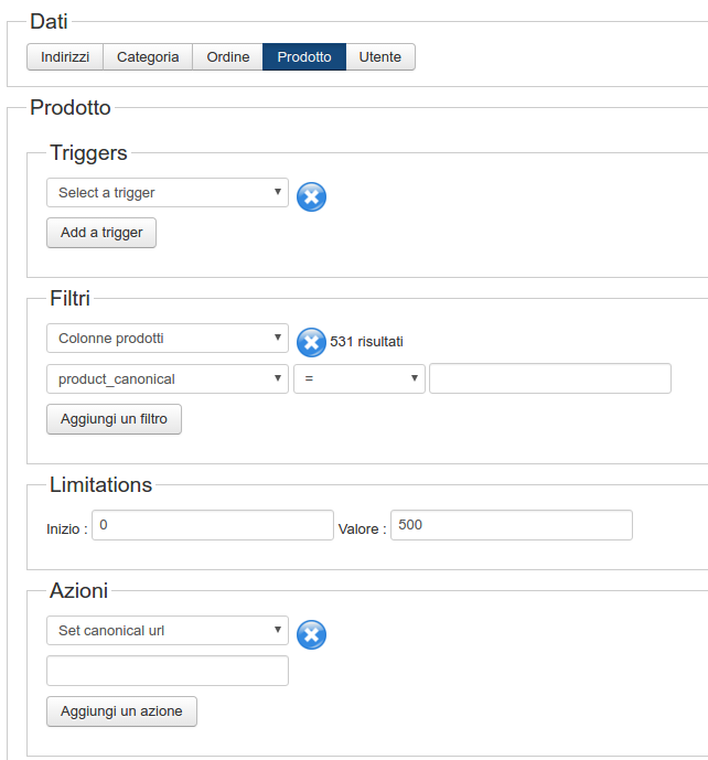

  • Posts: 113
9 years 6 months ago #261996
Nicolas hello, thanks for the reply. Can I change the canonical URL with mass action?
in "set canonical url" What should I enter?
thank you!
  • Posts: 86106
  • Thank you received: 14207
9 years 6 months ago #261997
Well, you could have:
"/it/negozio/prodotti-per-la-cucina/prodotto/{product_alias}"
Supposing that all your products aliases are filled with the product's alias used in the URLs.
Also, this means that all the products links will be in the menu item negozio/prodotti-per-la-cucina
If you want to have different menu items for different categories of products, you would have to run the mass action with a filter on the category and run several times the mass action, once for each category, after changing the filter on the category and the menu item alias in the URL.
