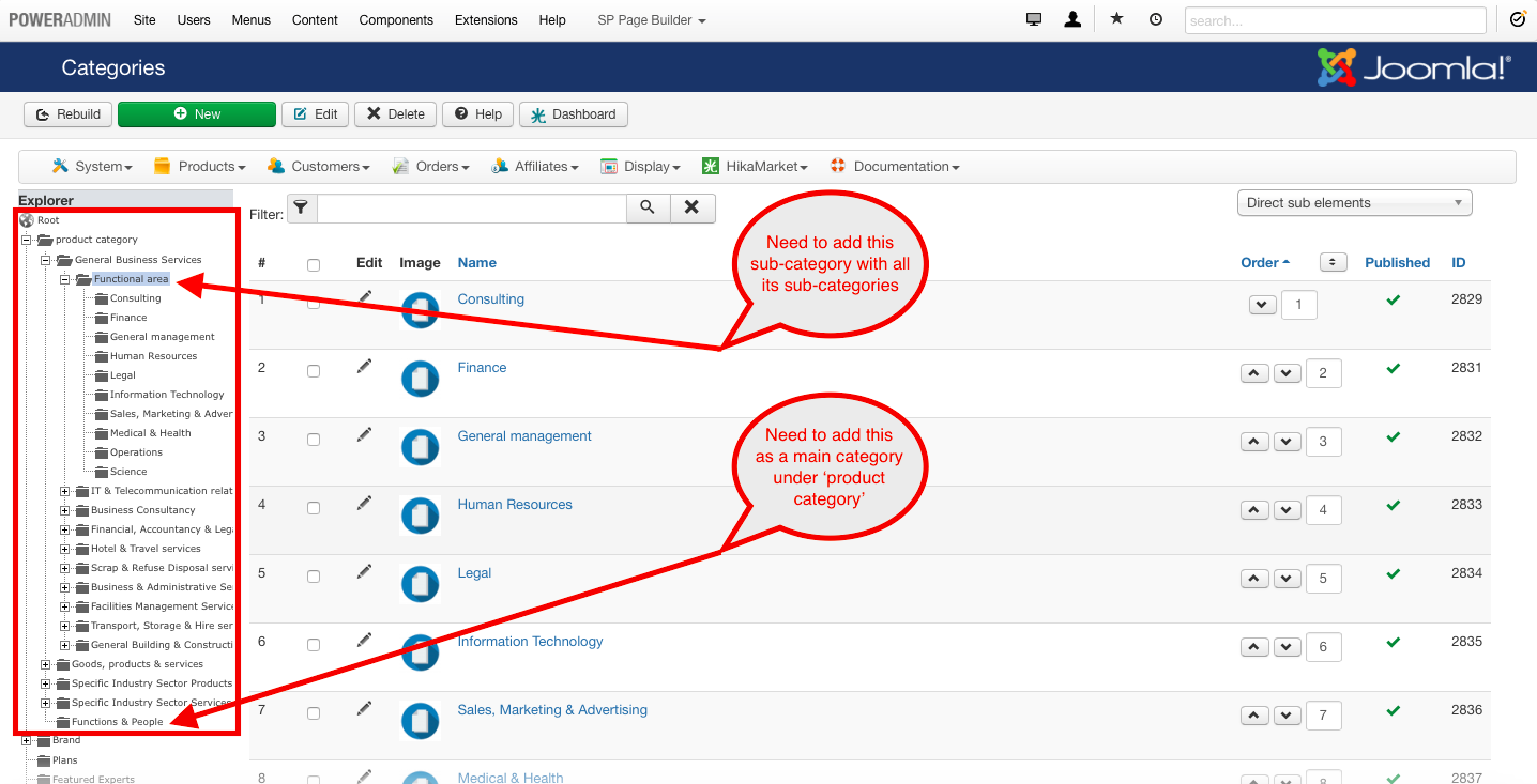

Under one of my main categories - ' General Business Services', I have added a sub-category called 'Functional Area' and under that I've added 10 sub-categories. For some reason they are not displaying.

9 years 10 months ago #254074
Yes, I am using Hikashop categories.
Once again, I've not needed to edit any modules for previously setting up the categories so why is it required now?
I'm not sure you are understanding my specific problem here. please see the attached screen shot, which might help.
Ian

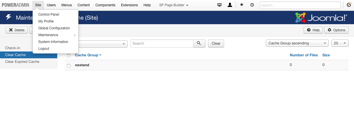

  • Posts: 32
9 years 10 months ago #254111
Sorry, but I don't get that 'System' menu tab on my Joomla.
I get Site and within there, no clear cache options.
I've attached what I get.
Ian

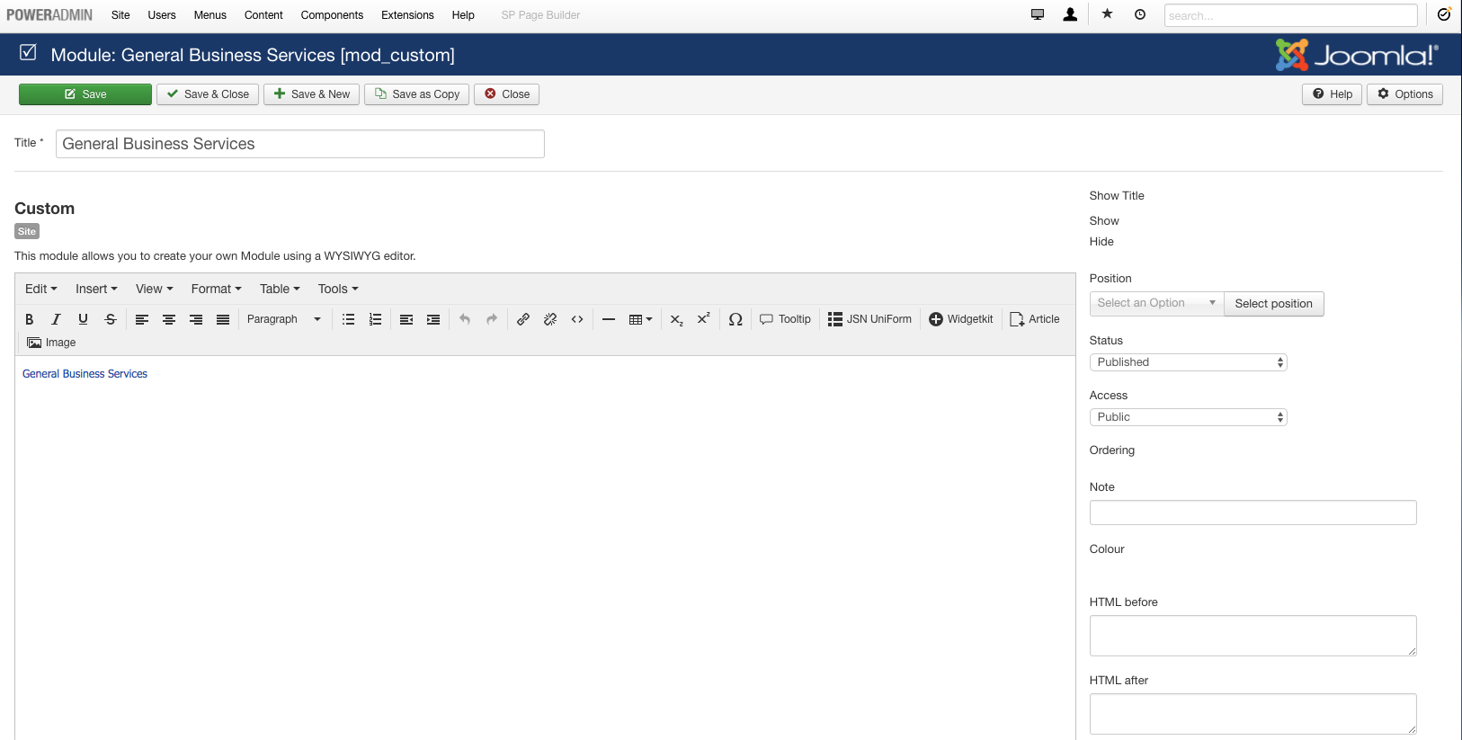

Can you please upload an image of the assignments tab for the module you are using to display the catergories/sub-categories on the website.
  • Posts: 32

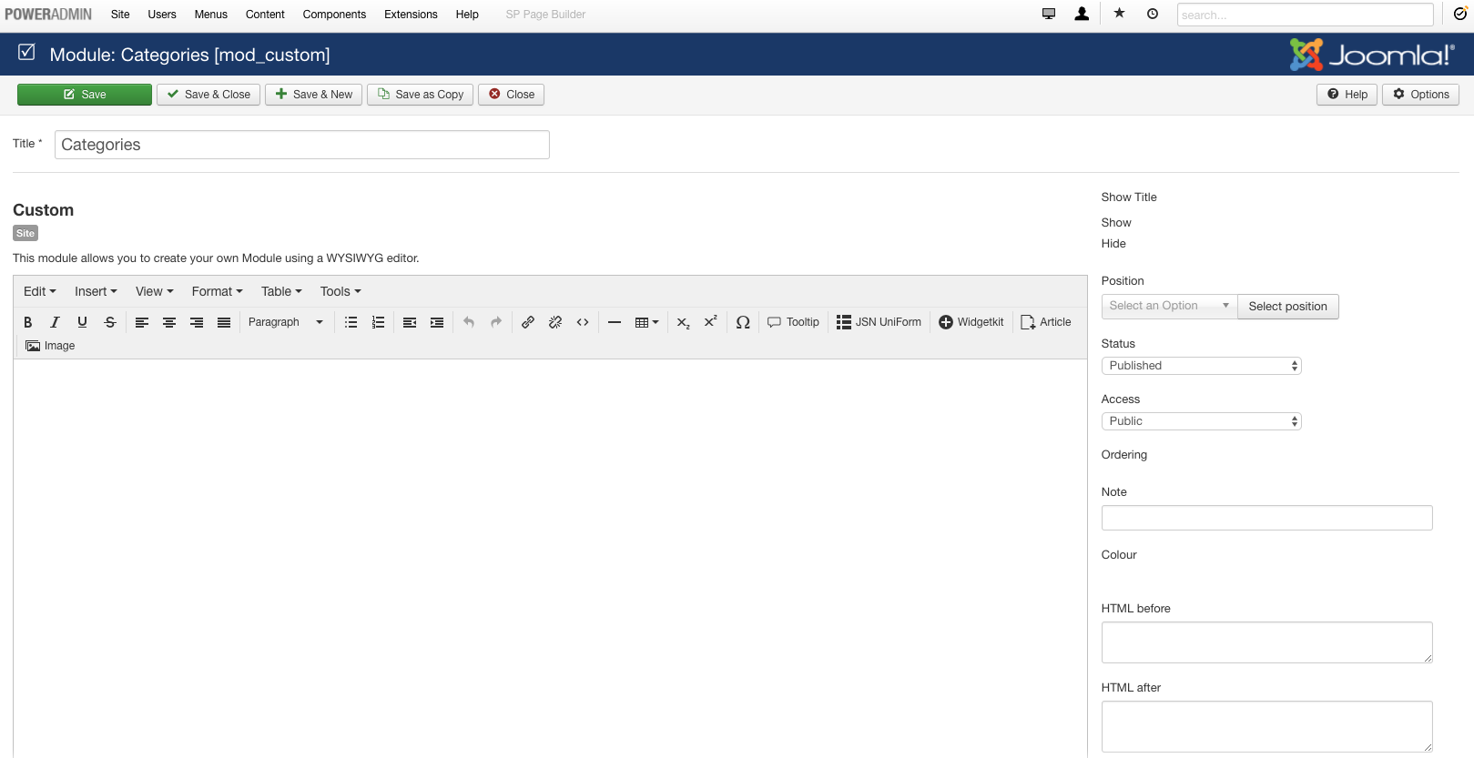

9 years 10 months ago #254135
This is what I see when I go to the modules. ( 2 attachments)
How do I get to the assignments tab?
  • Posts: 158
  • Thank you received: 5
9 years 10 months ago #254136
No, it's the module you use to display in the front end - usually hikashop accordian, hikashop menu or hikashop categories.
I don't have a link to your site unfortunately, so I'm having to guess, which is not great!

  • Posts: 32
9 years 10 months ago #254230
1. Yes, it is a 3rd party extension called multilevel categories accordion from Exstore.
2. How do I check that the categories are enabled?
3. Other categories and sub-categories are being displayed which don't have any products in them and it configured for public access.
4. Where is this 'rebuild' button? and what will happen if I do that? i.e. will I loose all my current allocation of products to each category?
5. My question is if the main category ' General Business Services' has the same configuration and no change has been made, then why are ALL the other sub-categories being displayed on the front end except one 'Functional Area' ? (see backend screen shot attached again
  • Posts: 86106
  • Thank you received: 14206
9 years 10 months ago #254233
2. Go in the menu Products>Categories, click on the parent category of the category you want to check in the "explorer" on the left, and look at the "published" column value for your category.
4. In the menu Products>Categories, you'll find that button. You won't loose anything. That button can only fix things in some cases, but never break or remove anything.
5. I don't know why. Did you try to display the categories with the "categories on 2 levels" module that I talked about in my previous message ? What was the result ? Did it work ? It would be essential to know that in order to narrow down the possibilities.
If it displays find with the module of HikaShop, then the problem in with that 3rd party module you're using which must be missing something. If it doesn't, then the problem is with the data of the categories. The rebuild process might help in that case.
